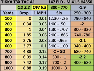

    I go 40 from 150-400, then 20’s to 1000m, anything after I’d have to dig I for the kestrel.
    Wind I hate a bunch of wind brackets. I do my base short wind and indicate which meter line they bump at. Considering all those matches are East and the winds are small I’d reduce wind data.
    You can make a wind cheat sheet for the back or inside your QB sleeve.

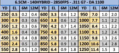

    You're going down the right road. Keep playing with how to organize it then just practice using it. Color coding the elevation helps to not get lost in the wind values. Here's my range card from GTI. Being 6.5CM, the gap in values are smaller but would still use a similar concept for 223. Looking at my 223 data, I would go every 25 yards past 600 as the gap between is larger.
    Example: target comes back 714yd, I would dail 4.3. I most scenario being off by a tenth of a mil will still be an impact on a plate.

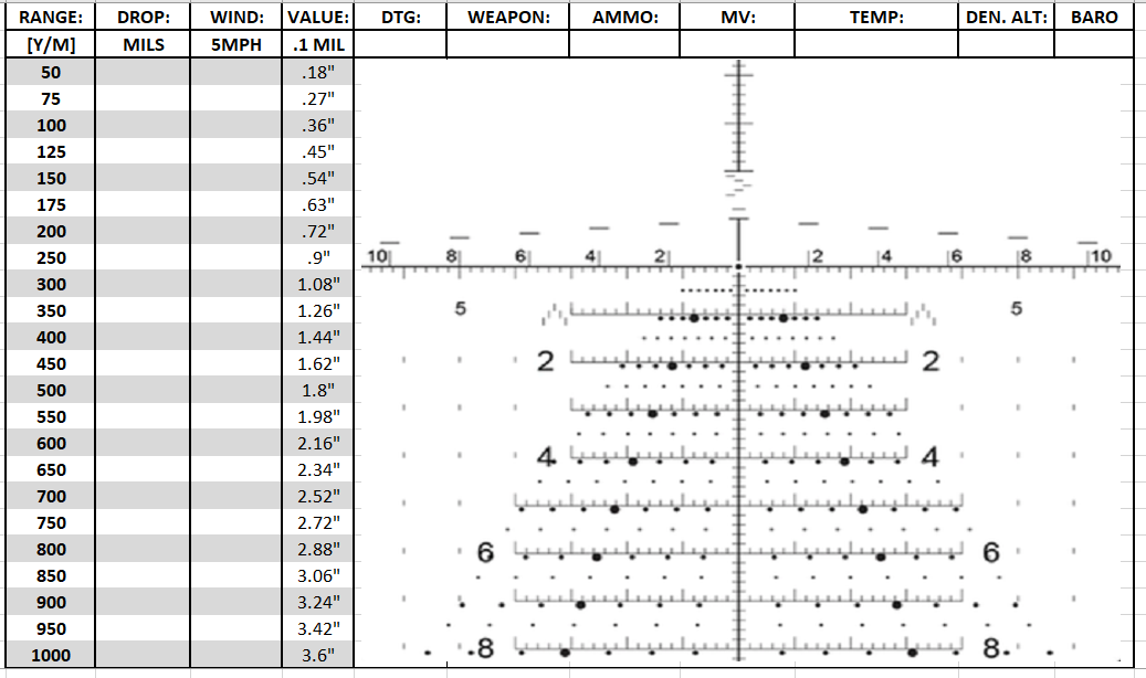

    Mine goes from 300-800 in 20 yd increments, with a column for 10 mph with a 6 mph gun. Beyond 800, I'm going to use a solver to get a firing solution.
    Reactions: D1gger

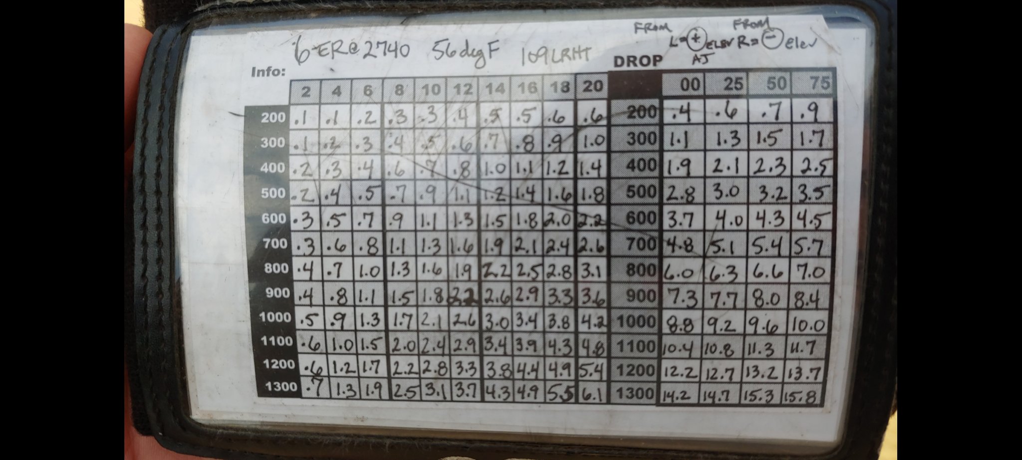

    I run a card very similar to this but only one wind call..... don't over complicate this, what good does having a 6&12 on this example do other than show you it's exactly double?
    Give me one wind value like 10 MPH and I can break is down into 5 & 15 pretty quick that will do the same thing and save some space for more elevation data.
    Instead you could use the extra space to break down elevation into 25 yd increments

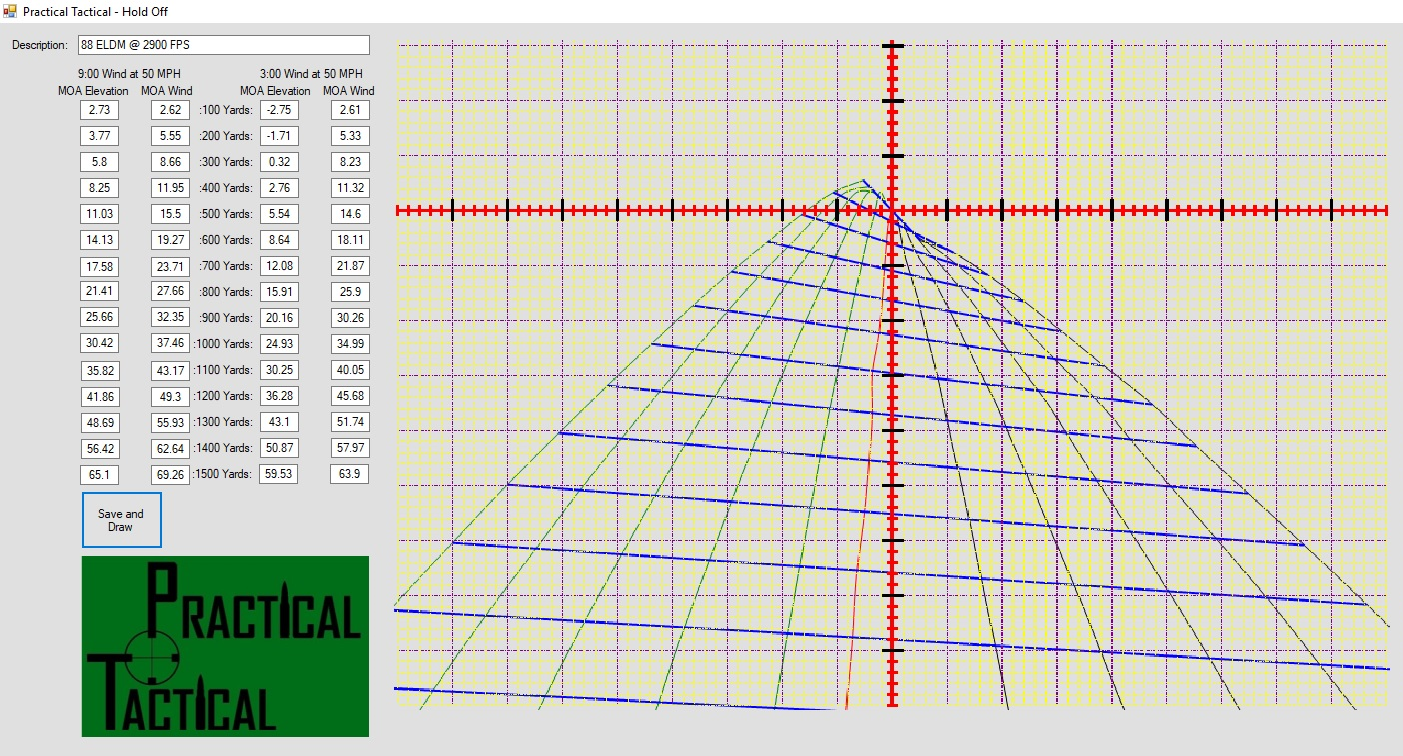

    What about something like this?
    Each blue line is 100 yards
    Each green line is wind speed in 10 MHP increments.
    Each yellow line is 1 MOA and each purple line is 5 MOA.
    The red line is spin drift.
    Scaling is for MOA not mils.
    Spending most of my time in F Class I have a habit of wanting to plot and analyze my shots. That works fine when shooting 12 shots from a fixed distance, but it does not translate well to PRS with multiple targets.
    That's what this format was developed for....
    During prep, I could hand draw a line parallel to the blue line indicating each target distance, then a small vertical before the stage showing my base wind call.
    After the stage I could plot where I thought my hits and misses impacted relative to my original plot. That provides a base line for analsys of what worked or did not.
    It would be real nice if a buddy on glass plots the shot impact relative to my plotted point of aim.
    Just print one page per stage and then have a complete record.
    1637723303388-png.7746716

    i make these and then laminate them. then just write over the laminate with a grease pencil. i carry several blank ones that i can just write out for different DA's. can also write my actual target on the reticle for different holds which works well.

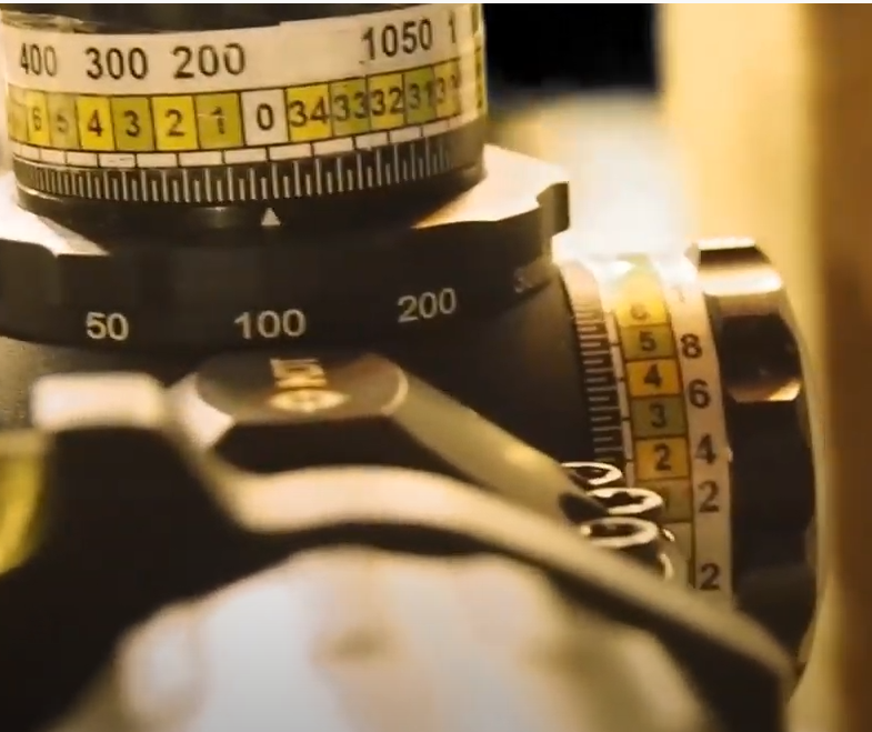

    The simplest and most universal is to cover the turret with your own BDC and wind comp label like these.
    The hardest part is designing it to scale but its easy enough even in MS Paint. Make it like 200 percent of intended size but print to 50 percent for finer pixels.
    The elevation is obvious but the wind is a little more abstract.
    The 2, 4, 6, 8, 1 represent the distance 200, 400, 600, 800 and 1000 for a 10 MPH cross wind.
    Everything you need to know is here for the base line atmospherics.
    If its cold come up an additional click or two and if its hot, come down one or two.
    For a 10 MPH full value crosswind just dial to the distance or thereabouts.
    For a 5 MPH full value wind go to half the MOA value of the 10 MPH wind
    For a 10 MPH half value wind go to half the MOA value of the 10 MPH wind
    The nice thing about this is everything you need to do the math is right here on the rifle.
    The limitation is your ability to translate to out of base line atmospherics like significant elevation changes. You still need to have a relative frame of reference for that.
