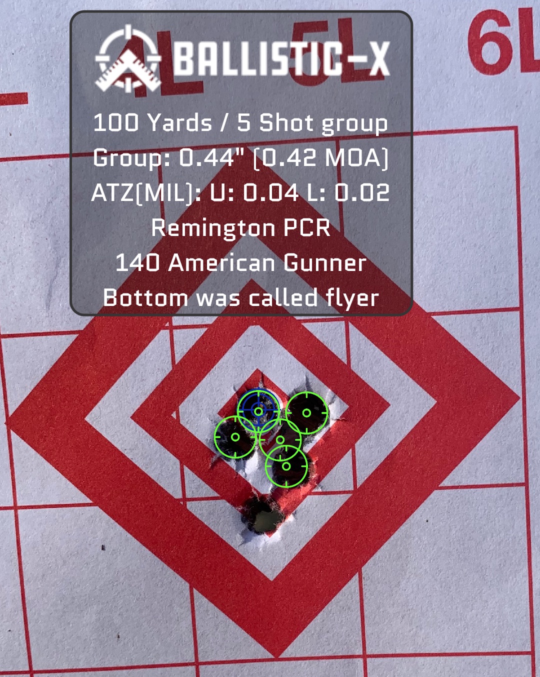

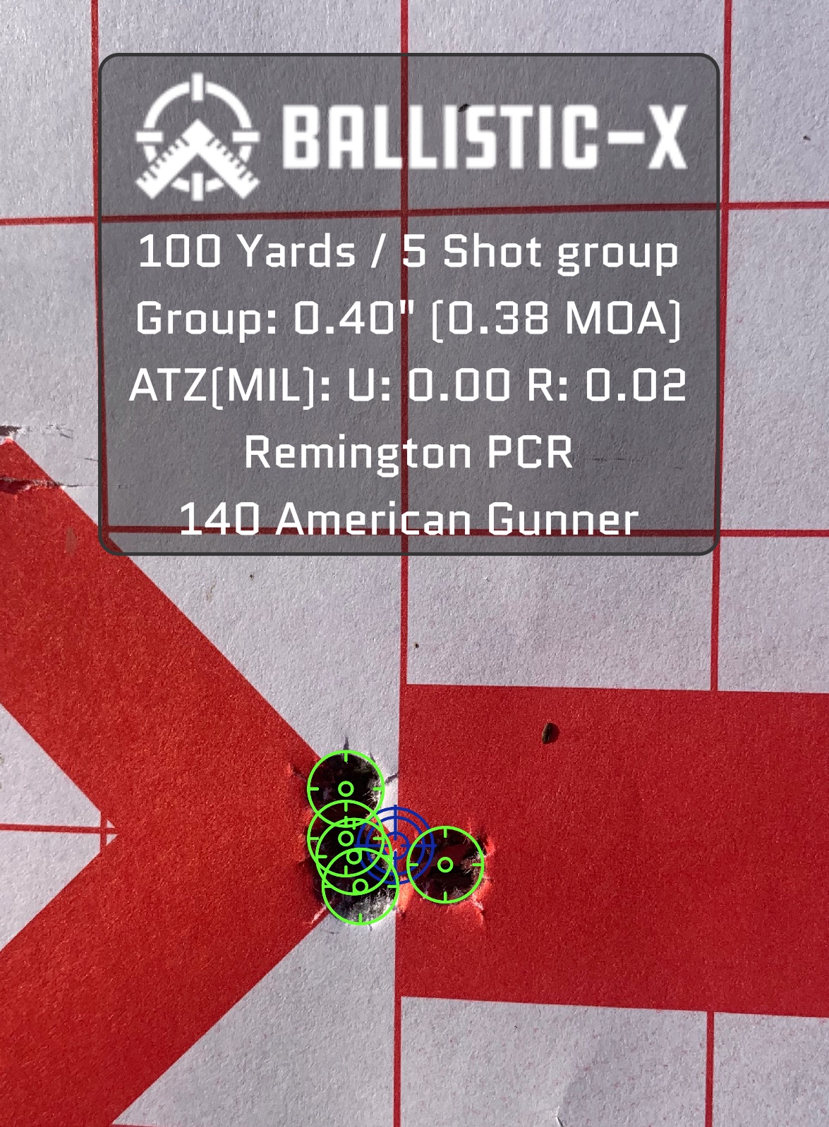

SD runs around 8-14. Both have 24” barrels. Accuracy has been great. Usually around .6-.75 moa. I have shot it out to 585yds and plan on using it at Franks class in Iowa this summer. FYI 41.5grs of H4350 in the Hornady case is an almost exact duplicate FPS wise.

View attachment 7378331View attachment 7378332
Good shooting!

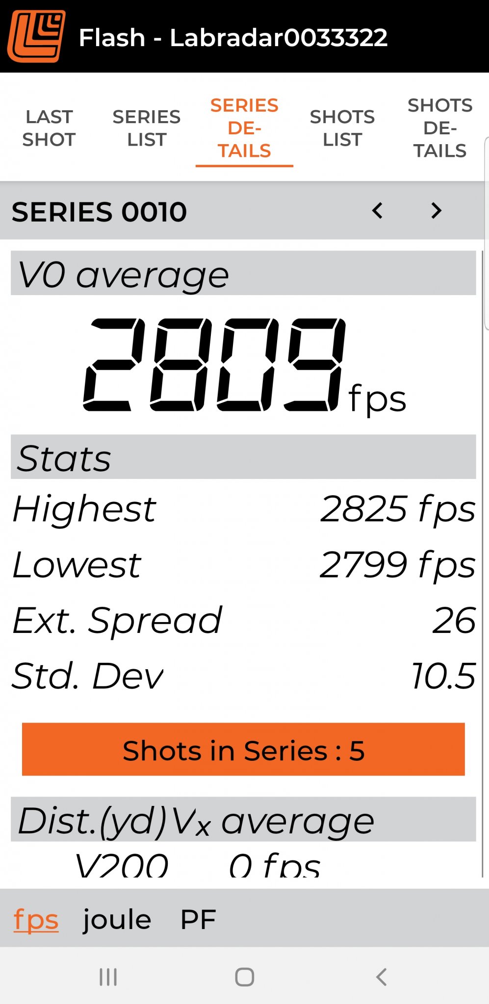

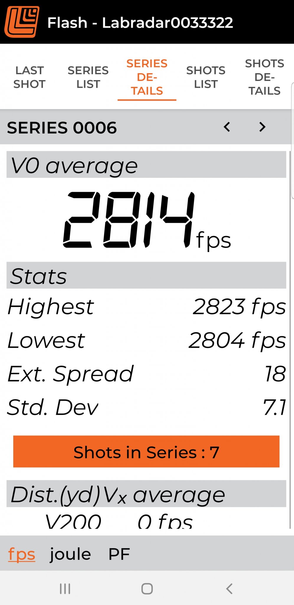

Here's a couple strings out of my 24" Bartlein barreled Tikka last weekend. This is shooting in Denver.
Great round for the money!
