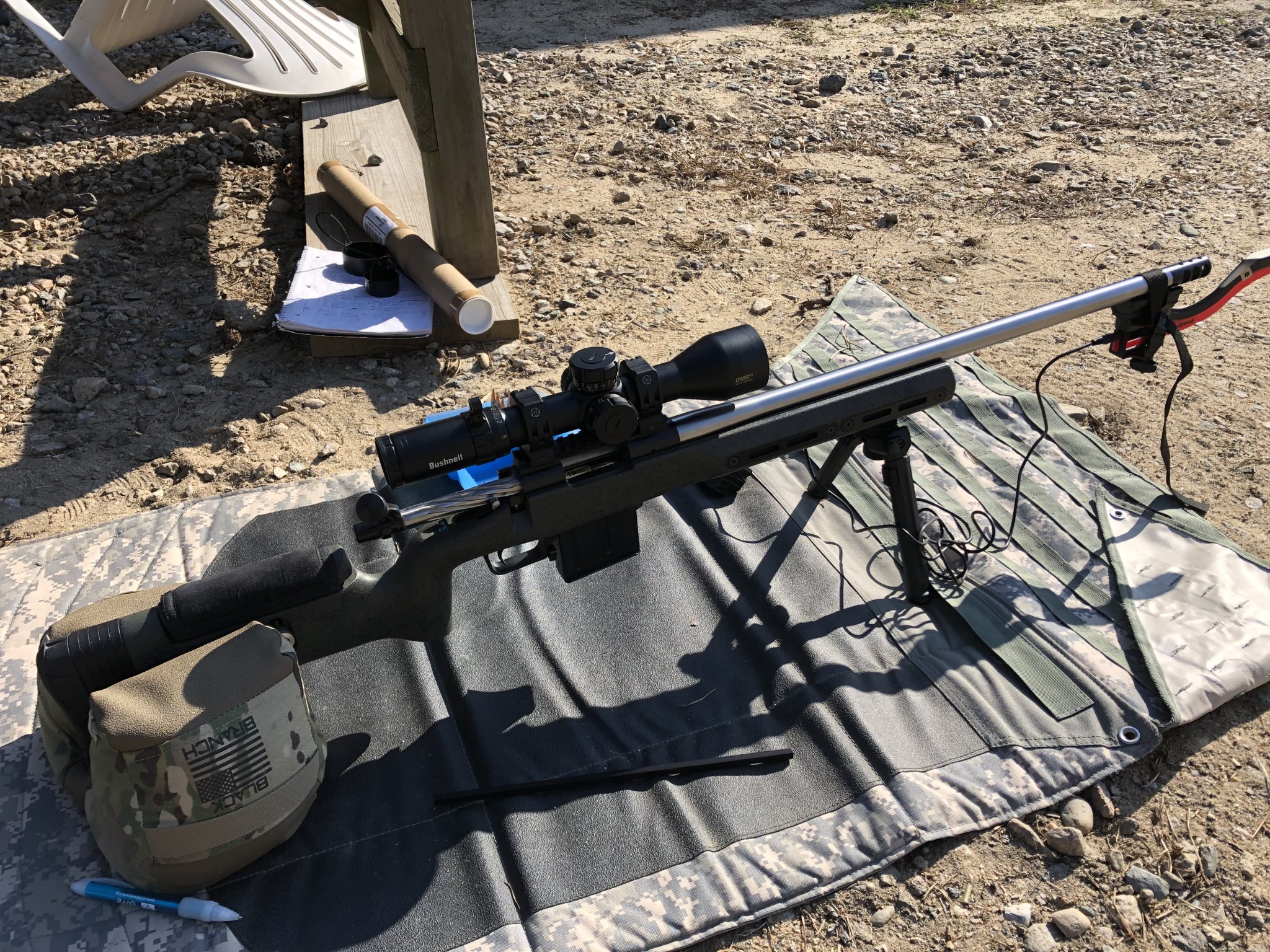

Excited to post this. Had my first rifle built by a local smith, Mike Pigney, to get into some prs type competitions in my area.
Rifle is a Rem 700 action trued up, spiral PTG bolt, 24” Bartlein 5R chambered in 6.5 creedmoor, 8 twist barrel, marksman contour. Barreled action sits in Grayboe ridgeback stock, Geissele trigger, Bushnell DMR-ii, ARC rings.

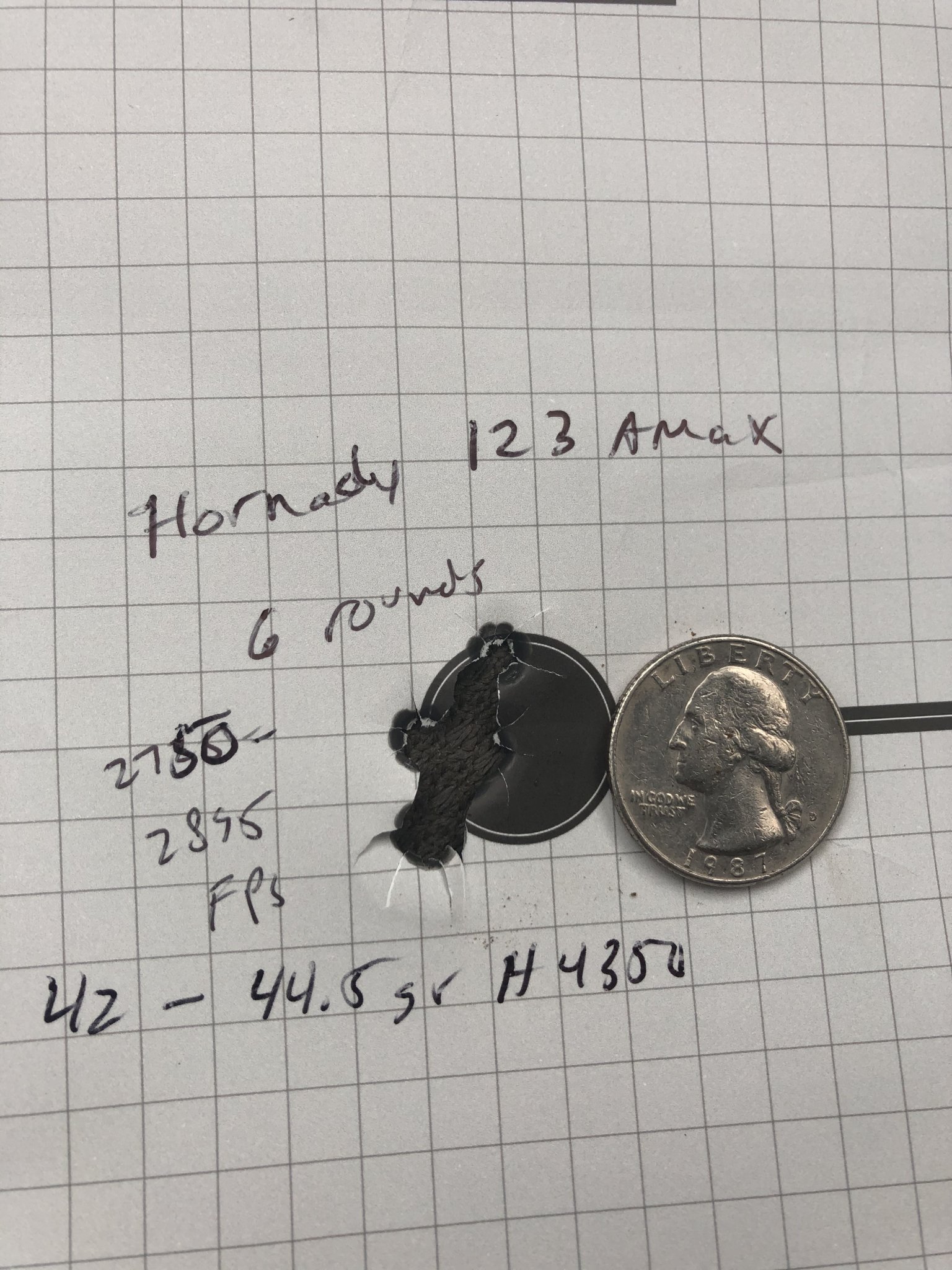

Started with the Hornady 123s. Loaded 40.5 to 44.5 going up in.5 increments. First shot didn’t read right on my magnetospeed v3 but it was good to go after I mounted it up better.
Don’t know why I didn’t aim at same spot for entire 10 round but I didn’t. I did for the last 6 and they made one big bug hole. Velocities ranged from 2681 at 41gr to 2895 at 44.5gr.
Even on the 44.5gr load, there as no ejector swipe or heavy bolt lift. Very minimal primer cratering so I could probably go up bit.

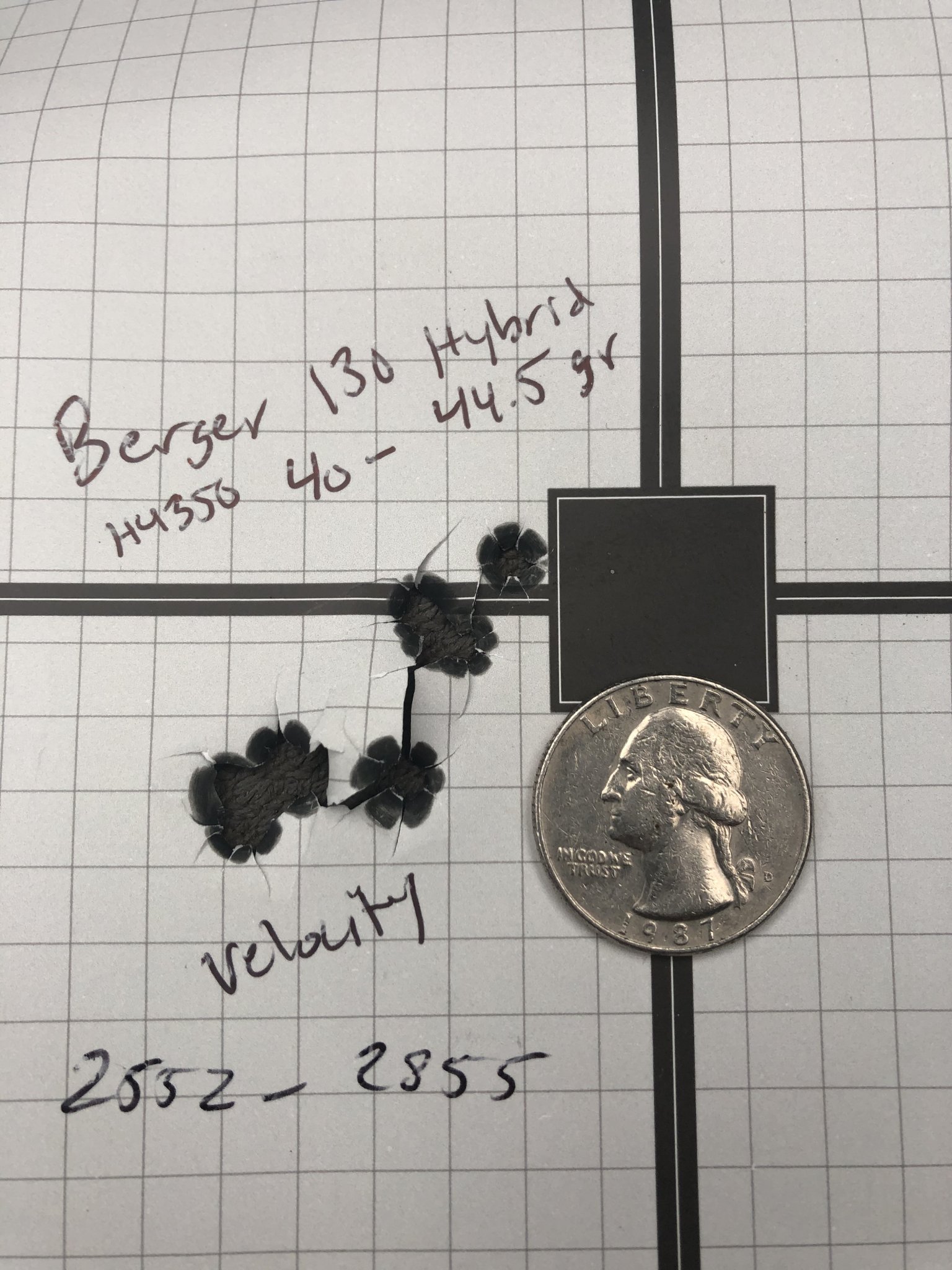

Next up was the Berger 130’s. Started at 40gr and went up to 44.5, again on .5 increments. Velocities ranged from 2552 at 40gr to 2855 at 44.5gr.
Once again no pressure signs that scared me on the high end. Very very minor primer cratering on the last few but still zero swipes or sticky bolt. The 10 shots here seemed to group in two separate groups. What surprised me was the lower group in the picture, are the higher powder charges. I was holding the same point aim on the corner of that square but they shot lower despite the high velocities.
