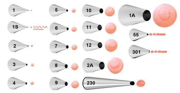

Never played with the CM, but my route is a hornady throw that I DO NOT throw in the case, I throw it on the scale (in a pan), then pour to the case. Tad slower, but cheap and works for when it REALLY want it EXACT.
I do the same but the funnel I use has a static charge that will hold onto 2-3 kernels of powder (extruded VV570), which can be ~.5 grain total weight. When I use ball powder it's lines the funnel. Bought many plastic funnels hoping to find that one magic one that was NOT static-y, and no joy.
Go to Michaels Arts and Crafts, find the section on cake decorating and get one each of the #12 (.338), #10 (.308) and #5 (.223) decorating tip (steel). 99¢ each, act as a funnel which is MUCH easier to pour into and has NO static charge.
If you don't have a Michael's near you, you can get them online from Wilton:
Round Decorating Tips - Wilton
