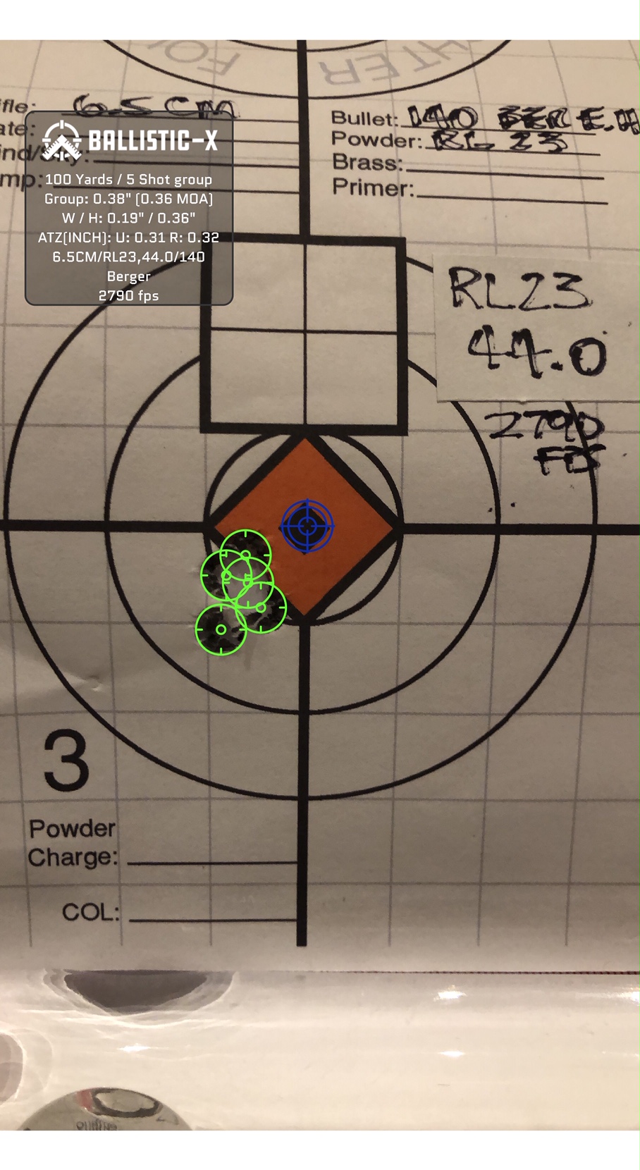

FWIW I use my charge master to throw a "rough' weight and trickle on my A&D to weight. The charge master set 0.3 grains low often throws too heavy a charge but says the weight is correct and stable. My charge master has been replaced once and is powered by a clean current system along with always given a 30 minute warm up time with frequent re-zero. The A&D never varies the calibration weights are exact to 0.01 every time. If I leave the weight on the charge master the weight wanders up/down 0.2-0.3 grains . Hard to feel confident about that. If you are shooting deer under 500 yards probably no big deal but if you want to kill paper with under 0.5 MOA I think it does matter.
