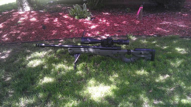

I just received my AE MKIII from Mile High about two months ago and can't say enough good things about them or the rifle. I'm probably the odd man out here because I went with the 1/12, 20", braked barrel. I have a Thunderbeast 30BA suppressor on the way and my plan is to replace the AI brake with a TB brake. You can order the TB brake to match the existing threads of the AI barrel, so I don't have to mess around with modifying the existing barrel. Just ANOTHER option to think about.
So far I've shot nothing but 175gr smk's through the rifle and have been averaging between 3/8" & 1/2" moa groups. Love this rifle!

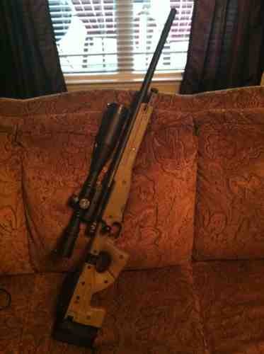

Well guys, my AI AE MKIII 308 is finally here and she is a fricken sexy thing. Its a 24" Lothar Walther 1/12 twist, folder, FDE.
I have to give props to Pam at Mile High Shooting, she made everything so pleasant and got my rifle to me within the week.
Im still trying to decide what optics run and what scope mount. Thinking of a Nightforce NXS 5.5-22, or reinstall my Bushy HDMR.
Thanks to everyone that helped me along the way, Im really happy with my purchase of the AI AE MKIII.
LOL, thats my little Shi Tzu in the background.
I just noticed the 24" barrel and no brake. Thought you wanted the 20" with brake.
Did you change your mind, or was this one in stock?
Yeah, I change my mind. I talk to Mile High and they recommended me going with the 24" barrel, the folding option will negate the length and if I really didn't want to shoot
the longer barrel, they could cut and crown it to what ever length I wanted. Plus the added muzzle velocity minimal it may be will be an added benefit shooting at longer distances.
My only gripe with the AE MKIII is the picatinny rail. First off its a 0 moa rail. Mostly everyone would rather run a 20moa or 40moa. In addition, the rail is quite low compared to
most other actions and it really isn't a "spec" picatinny rail due to the slot spacings. It really makes finding 1 piece mounts with canted base difficult. I just went ahead and ordered
the AI scope mount and will run that until I find something better or change out the rail to a Ken Farrell, Murphy ect.
