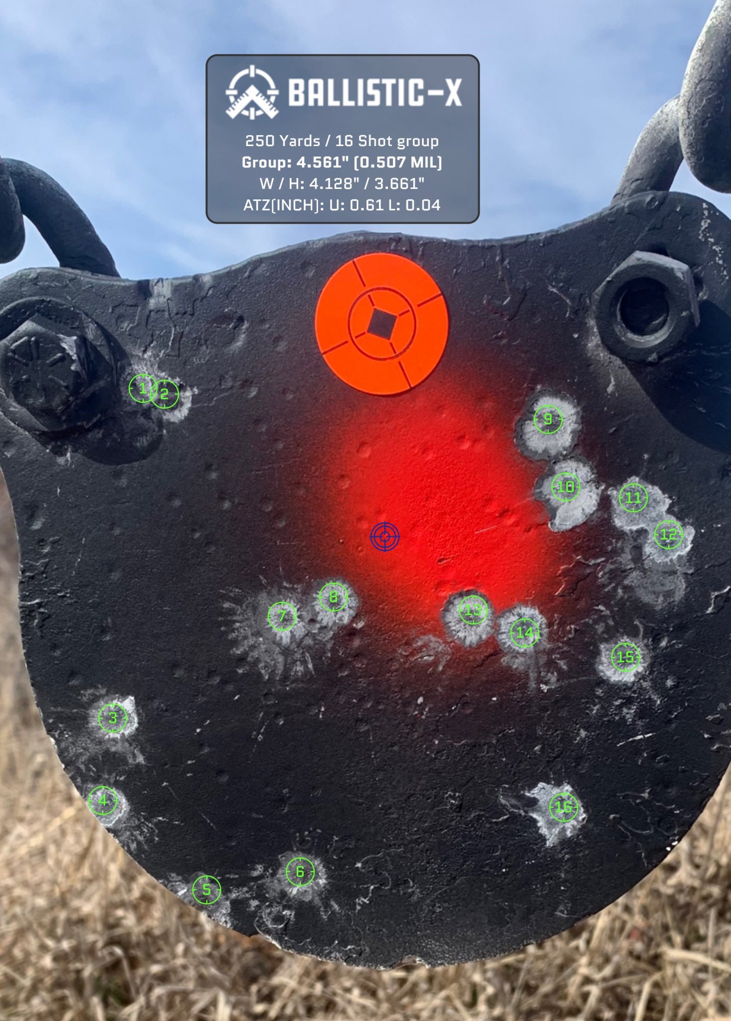

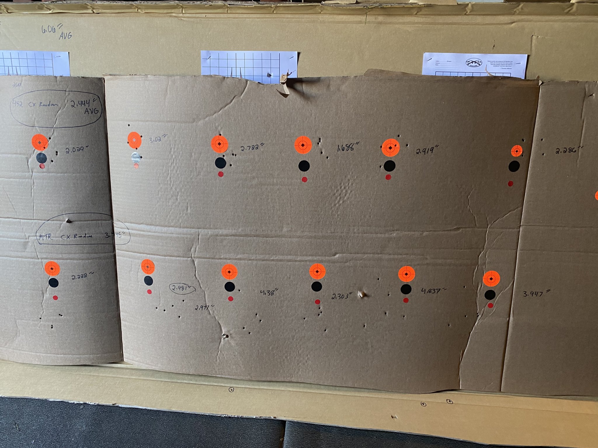

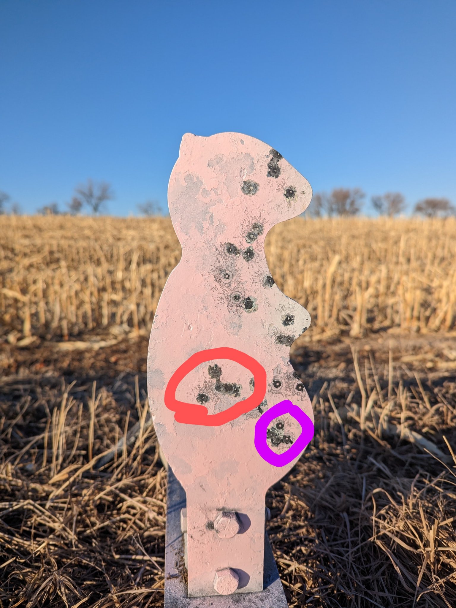

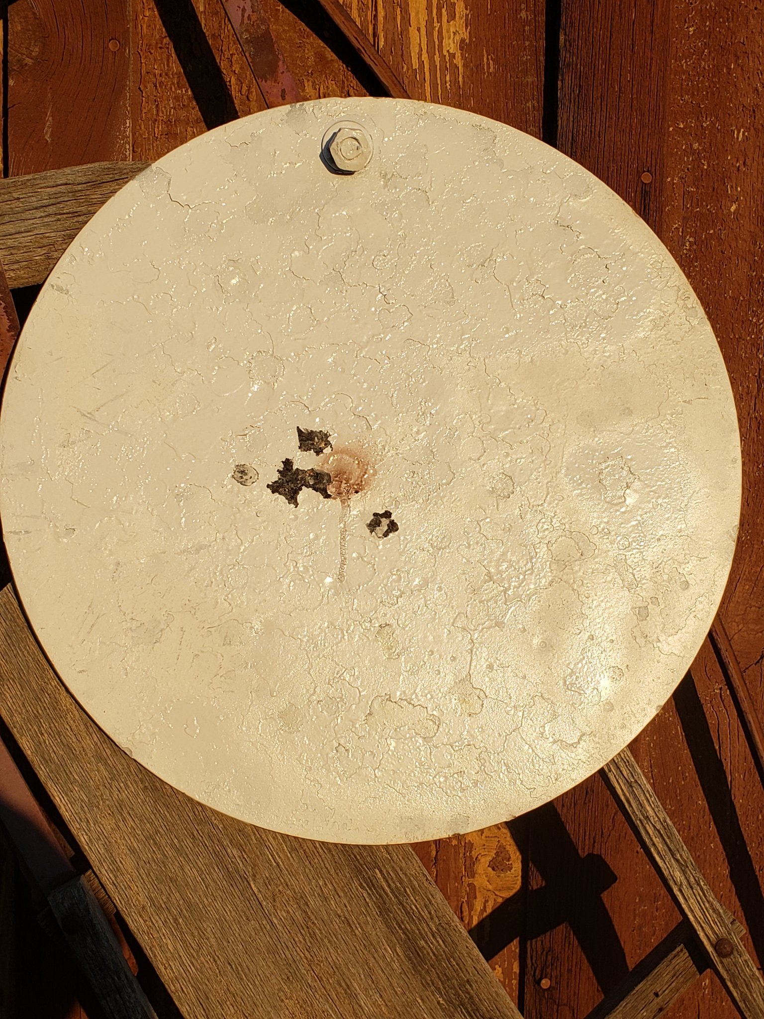

All 10 shot groups. All of my Eley match groups, the corners shot at 2.5-3" and the center-x had two low shots that made it like 4"
Reactions: Sblzrd65 and Dawhit

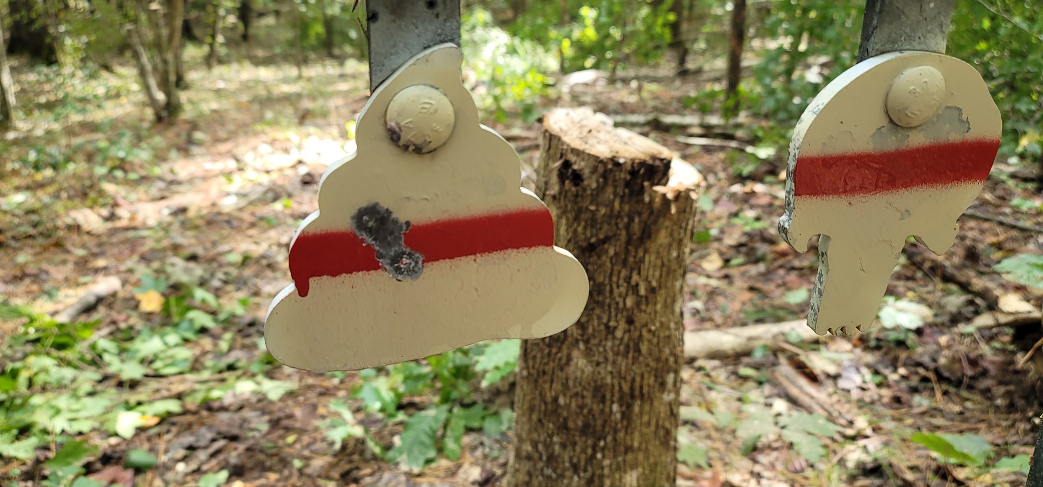

Very unrealistic, but possible, 2 different types of ammo, from a tripod. I will take any bet that says this will be wr happen again. But it did once. The rest of the splashes are a different gun and different ammo

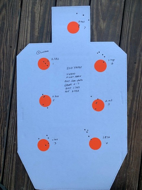

I agree with jbell. From his 2022 data on the 6x5 Forum, here is the top shooter group sizes at 200 yards:
200 Yard Average:
1: 2.035” / 0.972 MOA (BillOH- Vudoo V-22 7/14/22)
200 Yard Best Group:
1: 1.179” / 0.563 MOA (BillOH- Vudoo V-22 7/14/22)

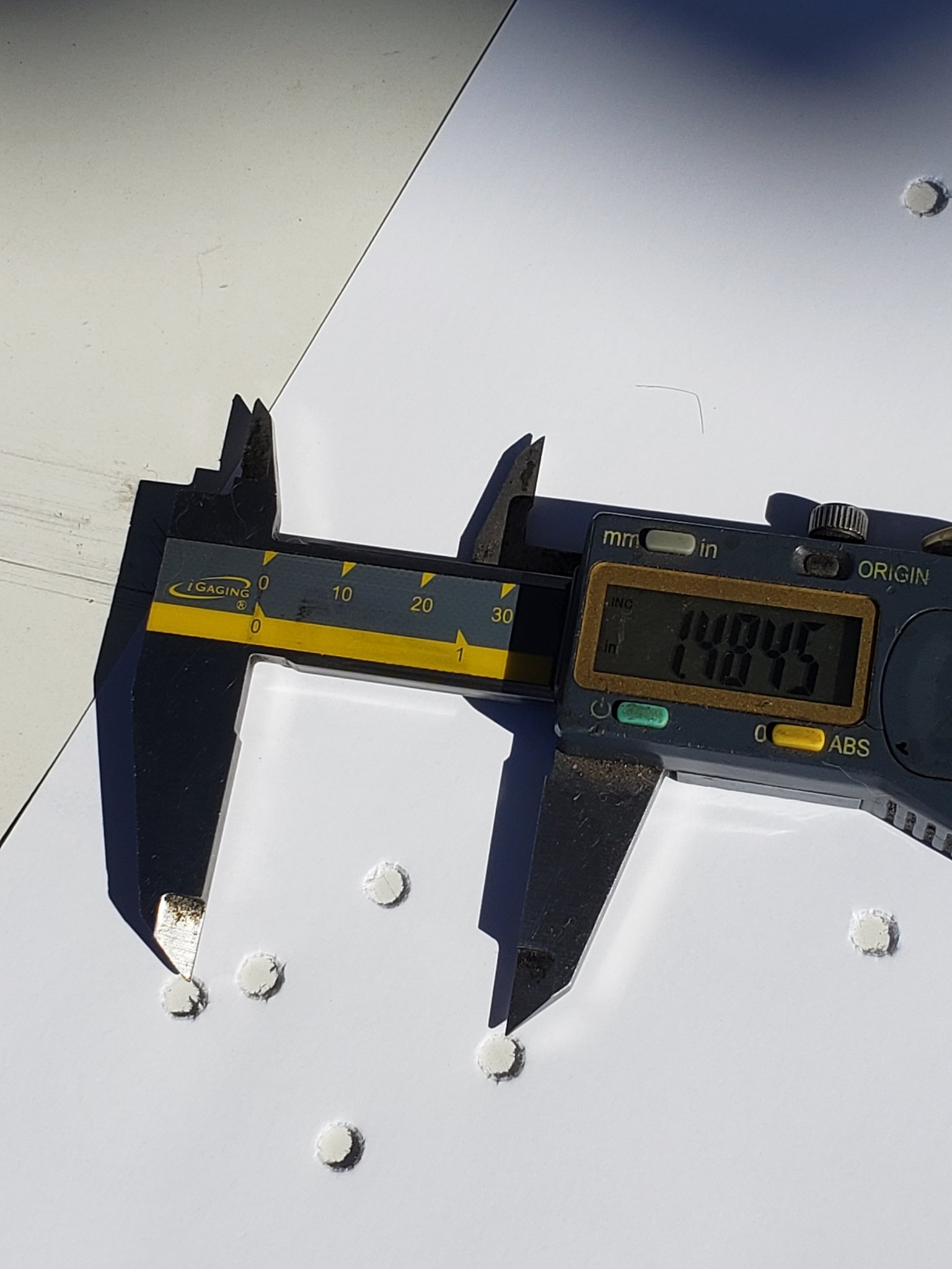

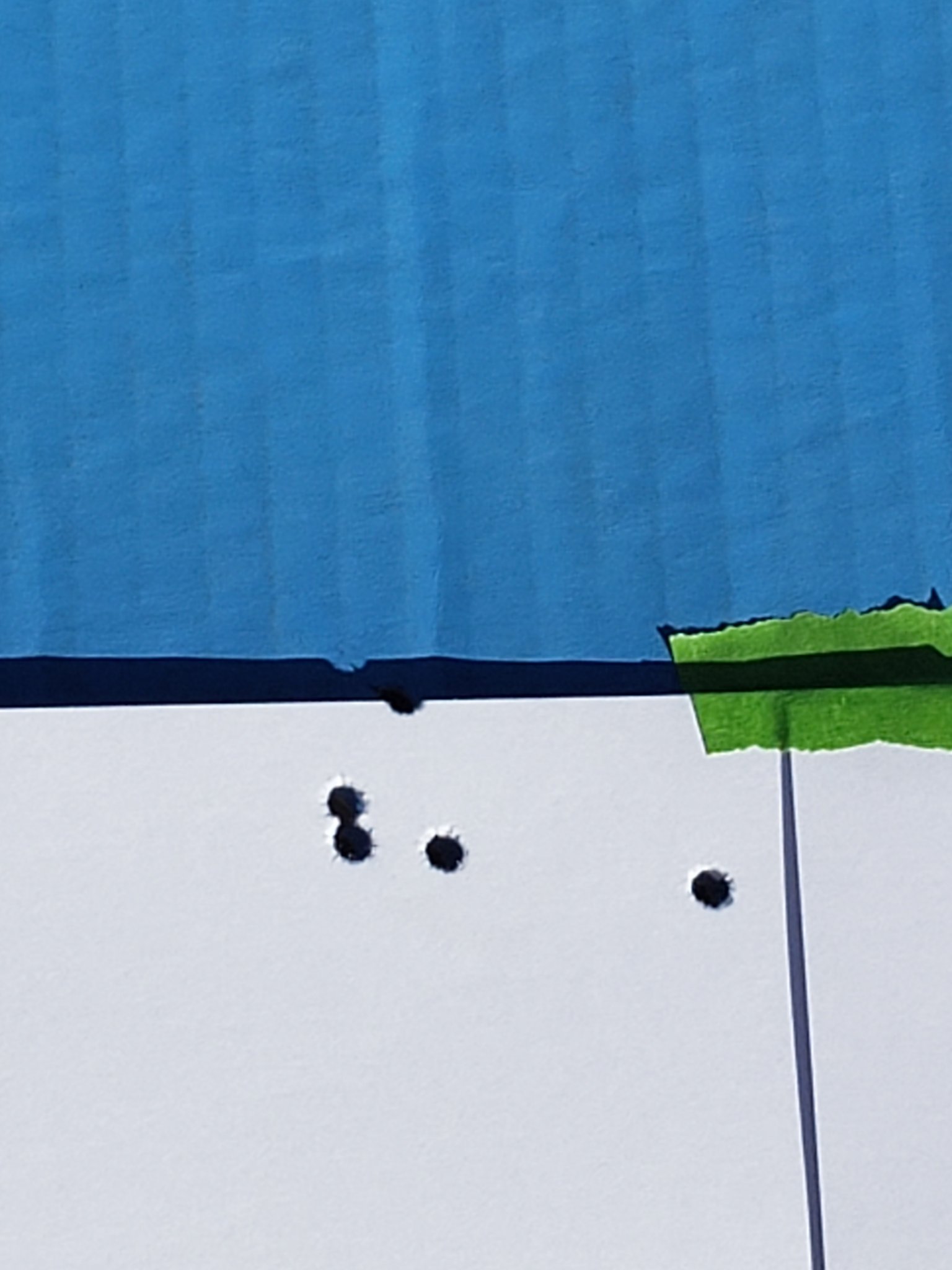

Not a rimfire, and for information's sake, but here are some of my better 200Y groups with pcp air rifles using lead slugs/bullets. 22 cal 42gr and only going 840 fps.

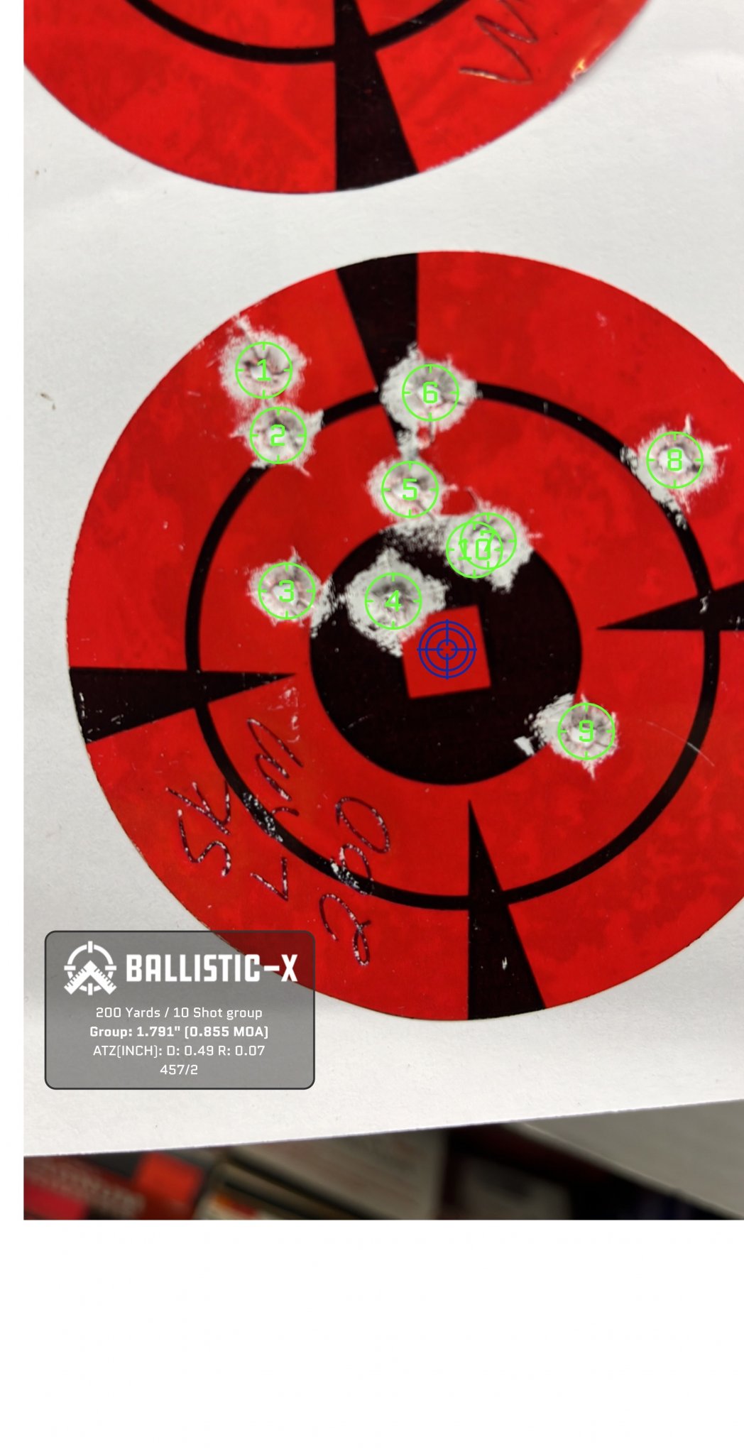

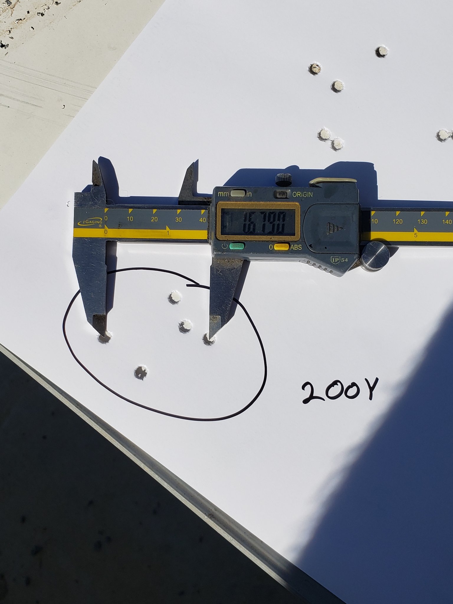

Took me a good bit of effort to get under MOA at 200yds. SK Long Range Match out of CZ 457 20” MTR barrel, 10 shots.
Realistic from my experience is anything under MOA at 200 yds is doing well
