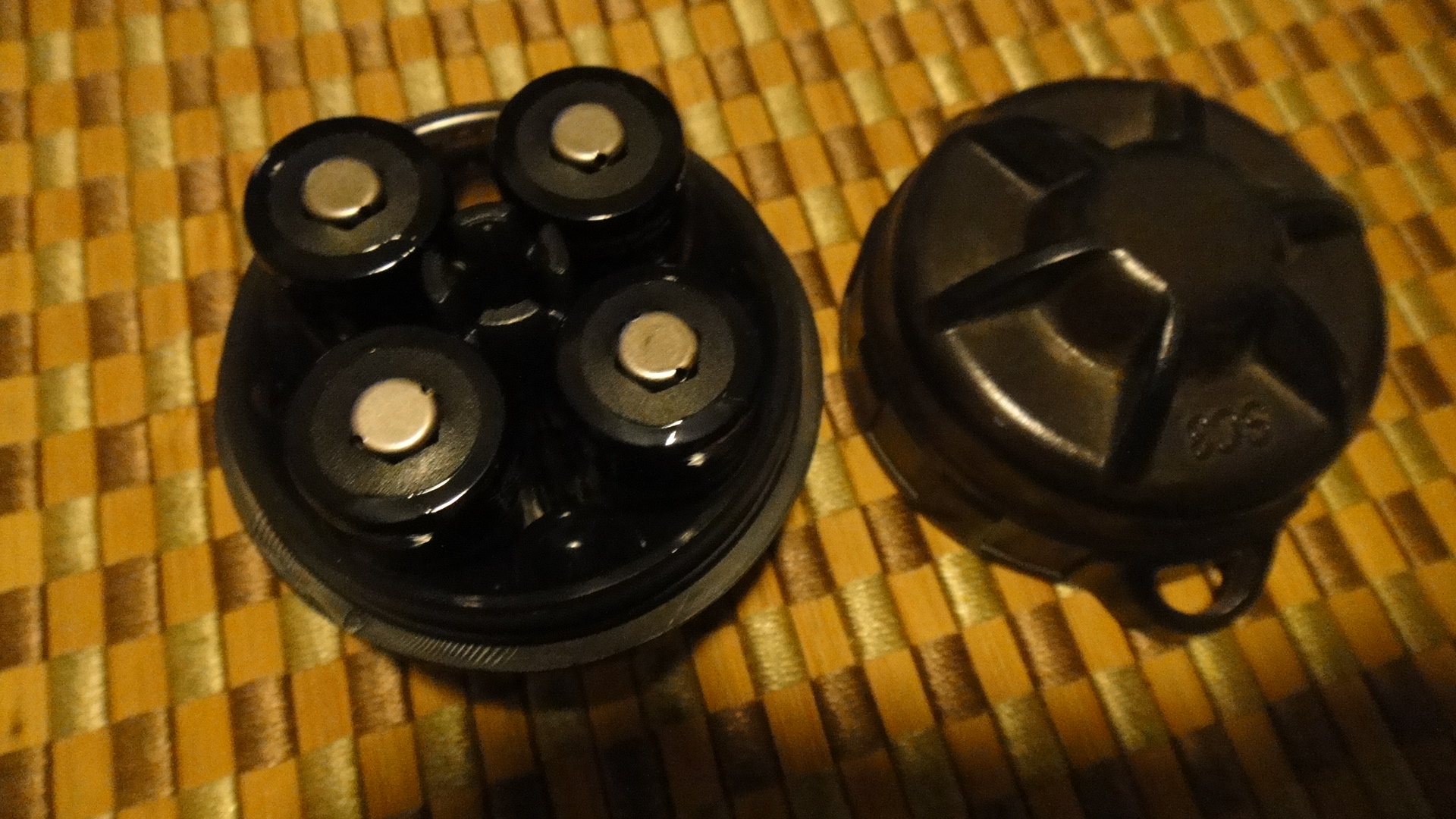

Has no one come up with a V2 battery pack adapter like the V1?
Not to my knowledge. I think that door on top is the problem. On the other Reap V1 it was pretty simple to just build an extension that screwed on to the battery housing. The Reap V2 trap door on top is a much harder obstacle to overcome. Not saying it cant be done, just haven't seen a solution yet.
All Triji had to do was put a step down voltage regulator in the Reap V2 that could handle from 5 Volts then step down to 3.25 and they would have had a winner with the Reap V2. About a $5 dollar part. Guess that would have dug into profits too much.
Also you never mentioned what Thermal scope you have??
Oooooh Boy, here we go.
I'm over in the Anti-Christ league. I am a die hard Flir PTS Thermosight bigot. Its the only one that currently meets all of my required criteria. I have every flavor Thermosight PTS Model they made (and a couple of special Custom Magnifiers for 233's) before they water board tortured us then threw us overboard like the worthless pieces of trash they think we are.
Even got some Flir Breach's. They love rechargeable 16650 batteries. The Breach is meh, but does the intended job plenty good enough for me and dollar for dollar is well worth the squeeze.
Now just remember "one is none and two is one". That applies especially to Thermal Weapon Sights. If one sh^ts the bed, reach on over and grab your spare or spares. In tactical/defense situations its always necessary to have Plan A, B, C, D, E & F.
The best thermal out there is the one you got in your possession that is up and running. :LOL:
