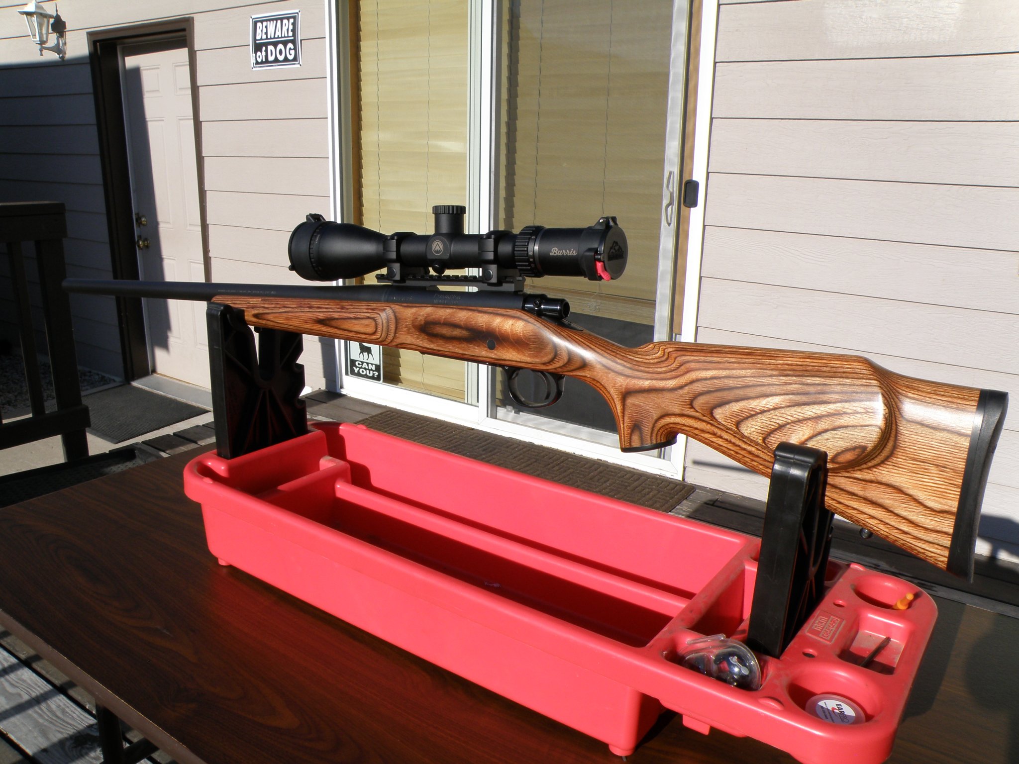

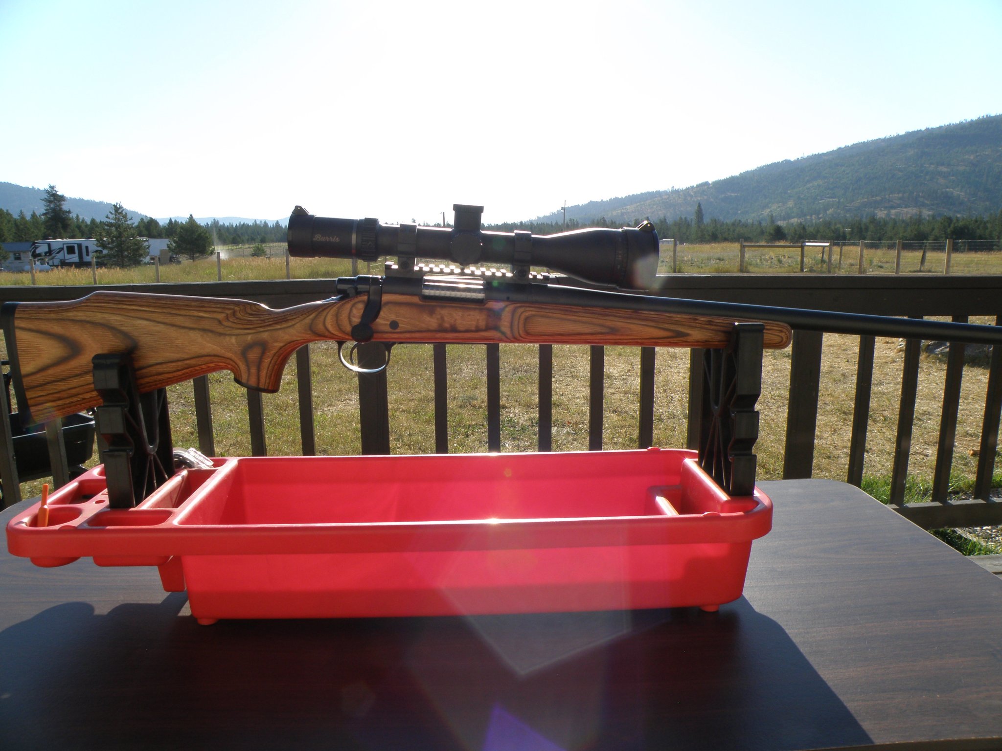

    So I have a Remington 700 VLS chambered in .243 that I bought new in the mid 1990s. At the time, the .243 was all the rage. Believe it or not, the gun is still new and unfired. A couple of years ago I planned to finally shoot the rifle and added a Timney trigger and scope. But with the ammo scarcity and other guns to shoot, I just put it back in the safe and left it there. On to my question:
    I understand it can be rebarreled to .308 WIN with just a barrel swap. Is this correct? I would probably go with a 20" barrel with threaded muzzle in the same "heavy varmint" contour it currently sports. The only reason I'm even considering it instead of just selling the rifle is because the quality of the wood stock and jeweled bolt is excellent. Super smooth action; I haven't seen anything from Remington in the last 20 years that is even remotely the same quality. I would definitely have a gunsmith do the work. From what I've researched, it seems barrel plus labor install is going to run around $600-$800 or so. So do you guys think it is worth it?

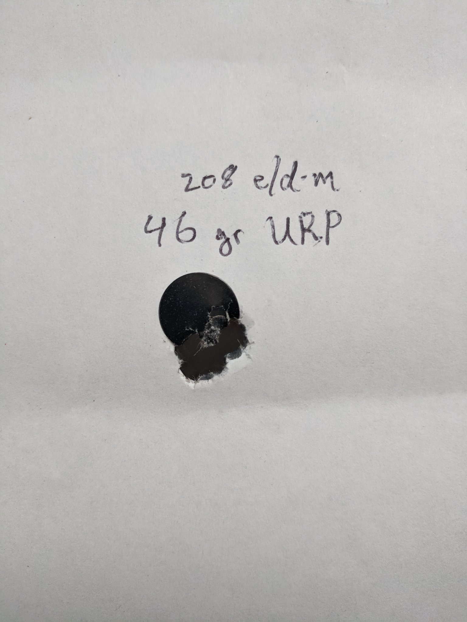

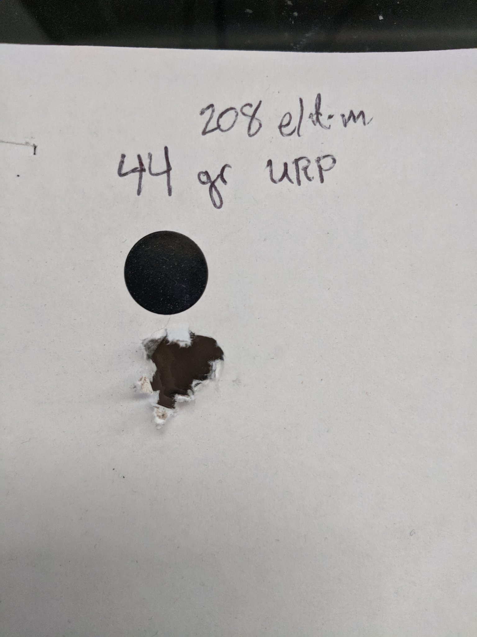

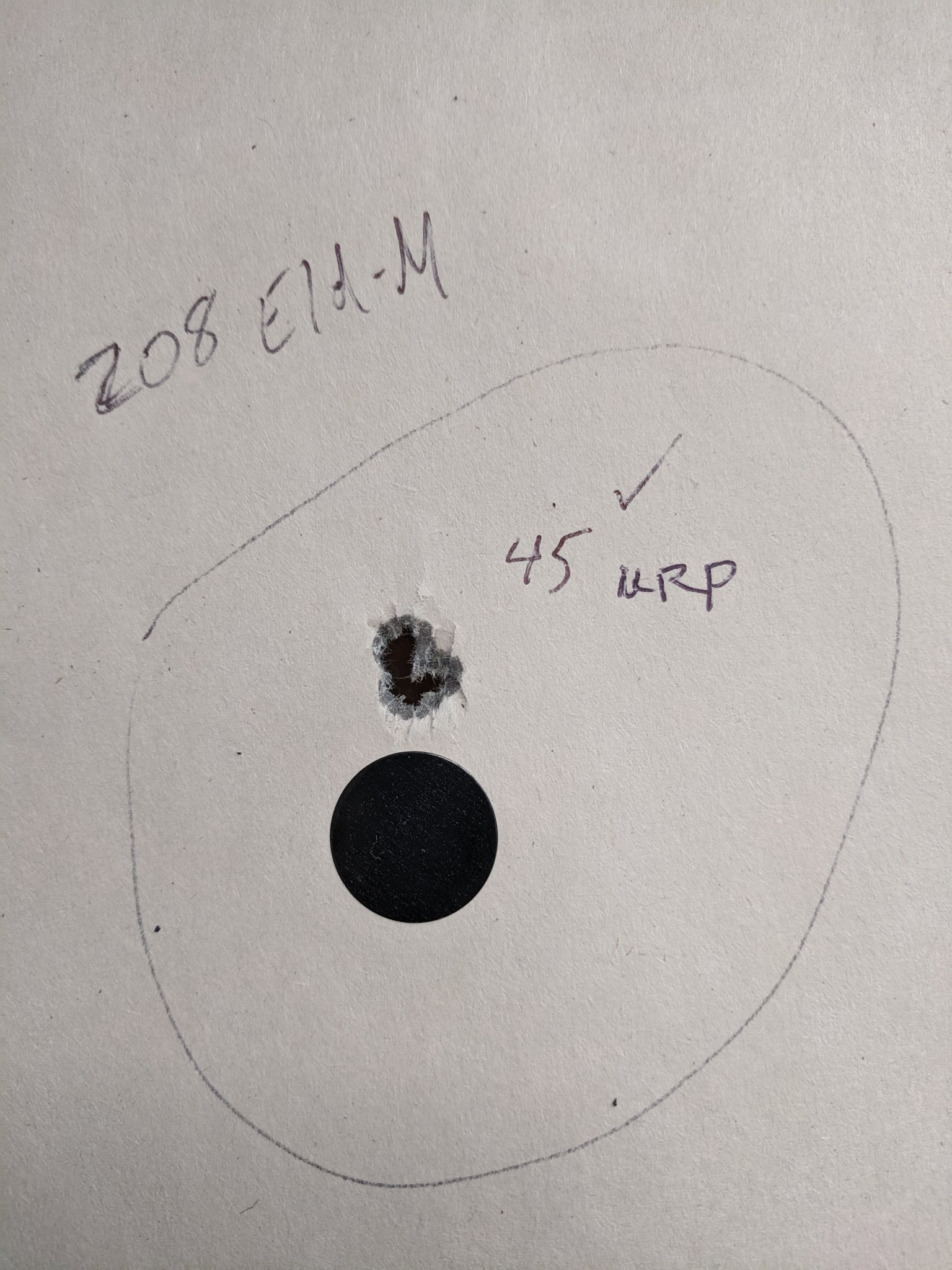

    20 years ago I had my first custom rifle built. It was a Remington Model 7 action in .22-250, and once the barrel was shot-out, I rebarreled to .308 WIn. Best thing I ever did for that rifle. I would say go for it. 👍🏼
    Or, if you reload and want something different, a 1:7 twist .25 Creedmoor, or 1:8 twist 7mm Creedmoor would be some cool options.
