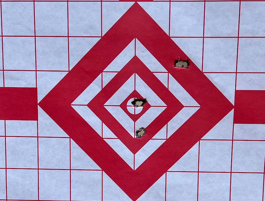

Just got back from the range. I was sighting in a rifle that I put together for my son.
Stainless Rem700 Action (RR Prefix)
Remage 6.5CM barrel from NSS.
Re-Barrel it yourself and go have some fun with it.
