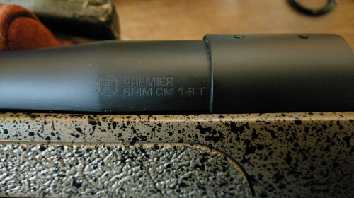

So I got my Bergara back from BPI, went from a 22" 6.5 Creed to a 24" 6mm Creed.
Looks like BPI cerakoted the entire rifle, it looks great.
New Premier Barrel
