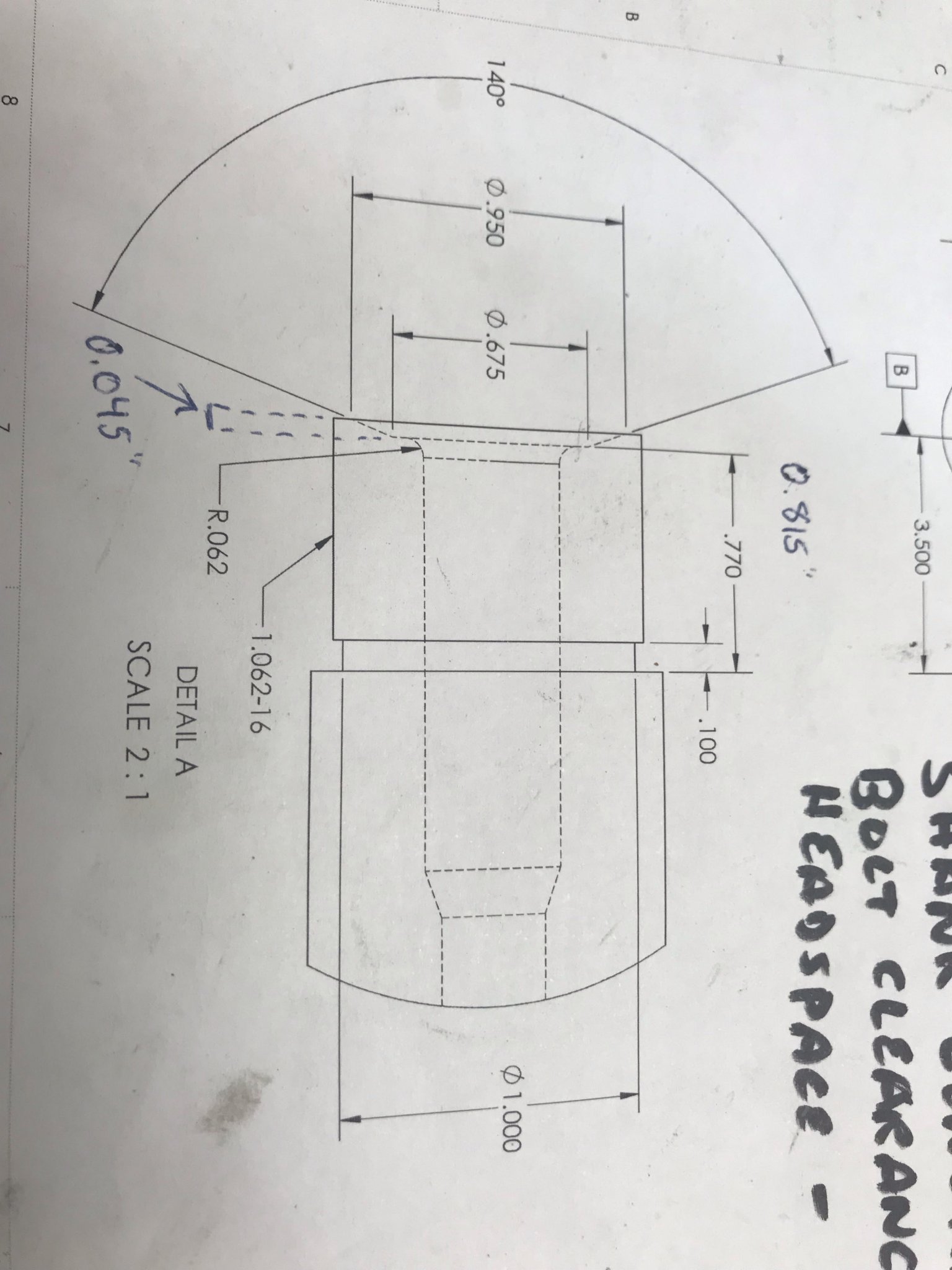

I just finished rebarreling one for my dad. Wasn't too tough, just took a bit to figure out the bolt nose angle.
bergara-2-jpg.7063806
7063810

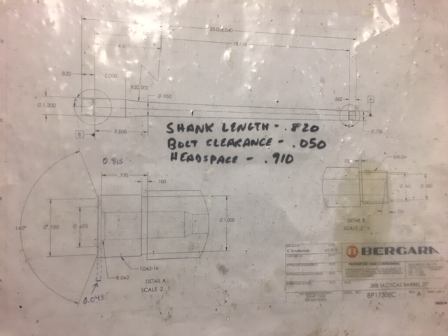

Any chance to get a better picture, or scan of the schematic?

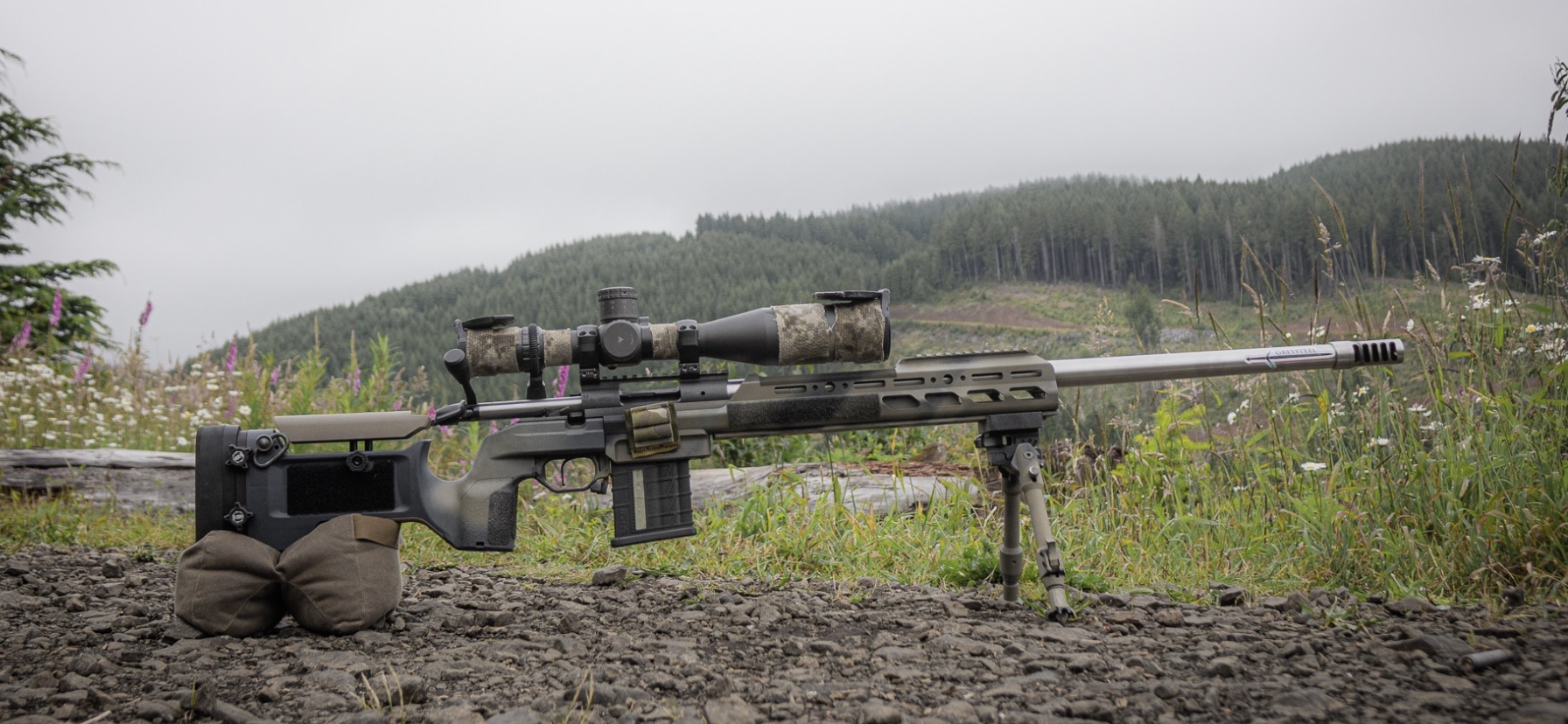

Sorry guys, not a pre fit barrel but it is an x-calliber, MTU profile, 5R rifling at 26” barrel on a b14 action and a premier bolt. This guy I know who lives in western Washington Greysteelhammers.com it cost me $800 ish to rebarrel.
Reactions: km77 and Stewy151
