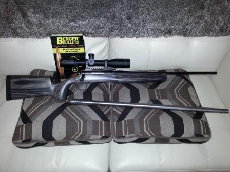

Rebarreling a R700 .243 with a Bartlein Barrel, Which Length to choose?
LoanHarvey
I am Harvdog!
Banned !
Apr 24, 2014
620
56
Walla Walla, WA
www.loanharvey.com
I am undecided whether to go with a 22", 24" or a 26" final length in this 5R Bartlein barrel. Any thoughts or suggestions would be great.
Thank you
