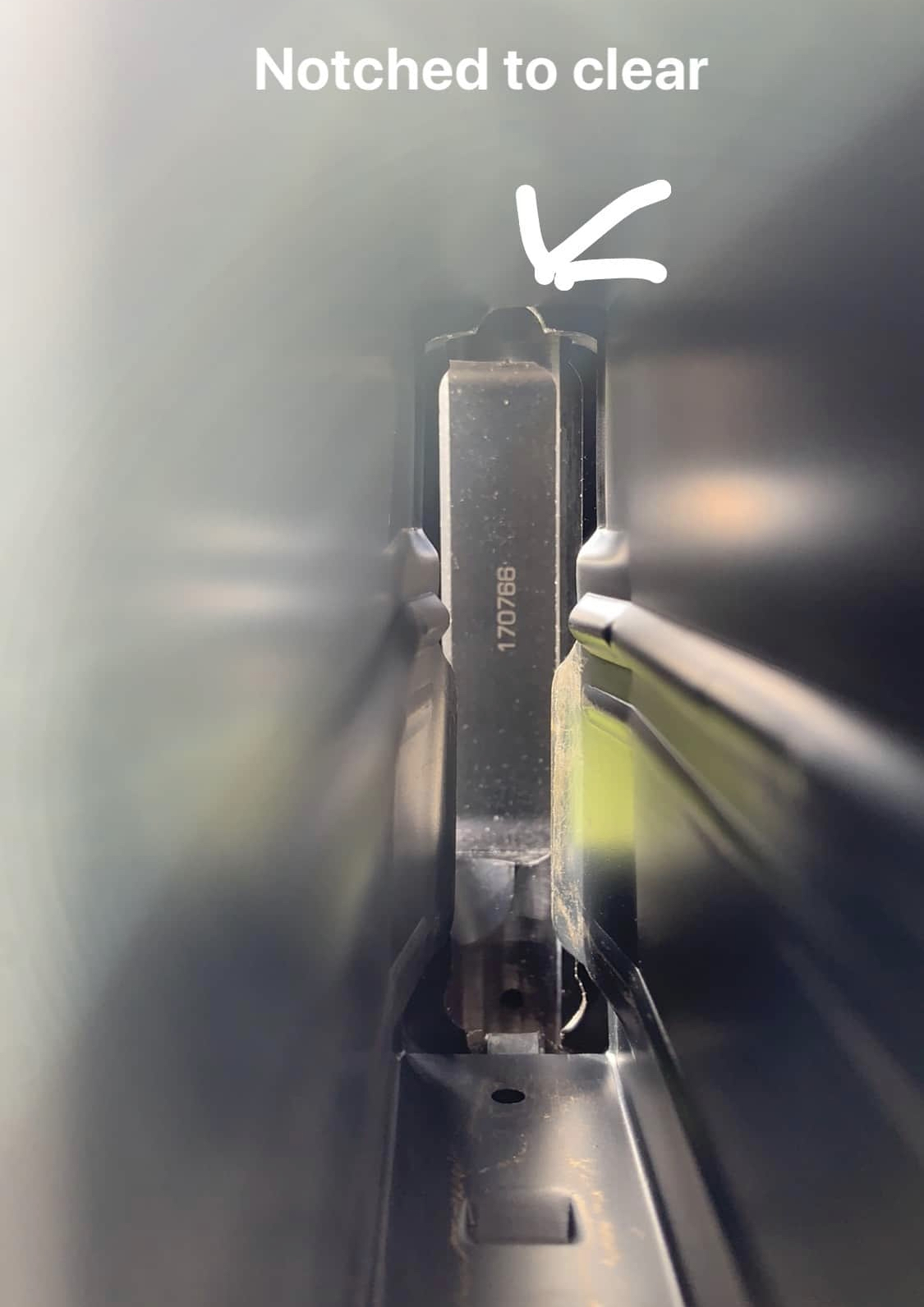

Instead of the plastic magpul aics mag that limits you to 2.87 or something you can run a metal mag. Metal mags will have a binder plate that keeps the rounds back same as the magpul but you can get non binder plate mags that lets you run out to 2.95 or so I believe.
If you do run non binderplate mags then you will need to notch the rem700 feed ramp so they don’t get hung up under it.

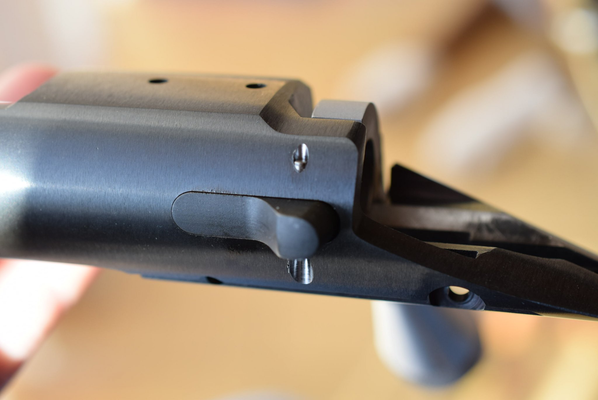

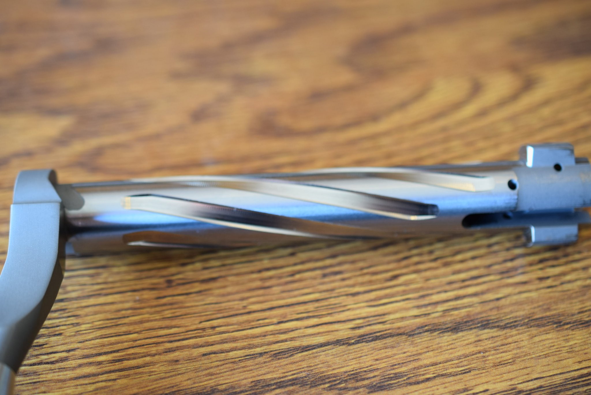

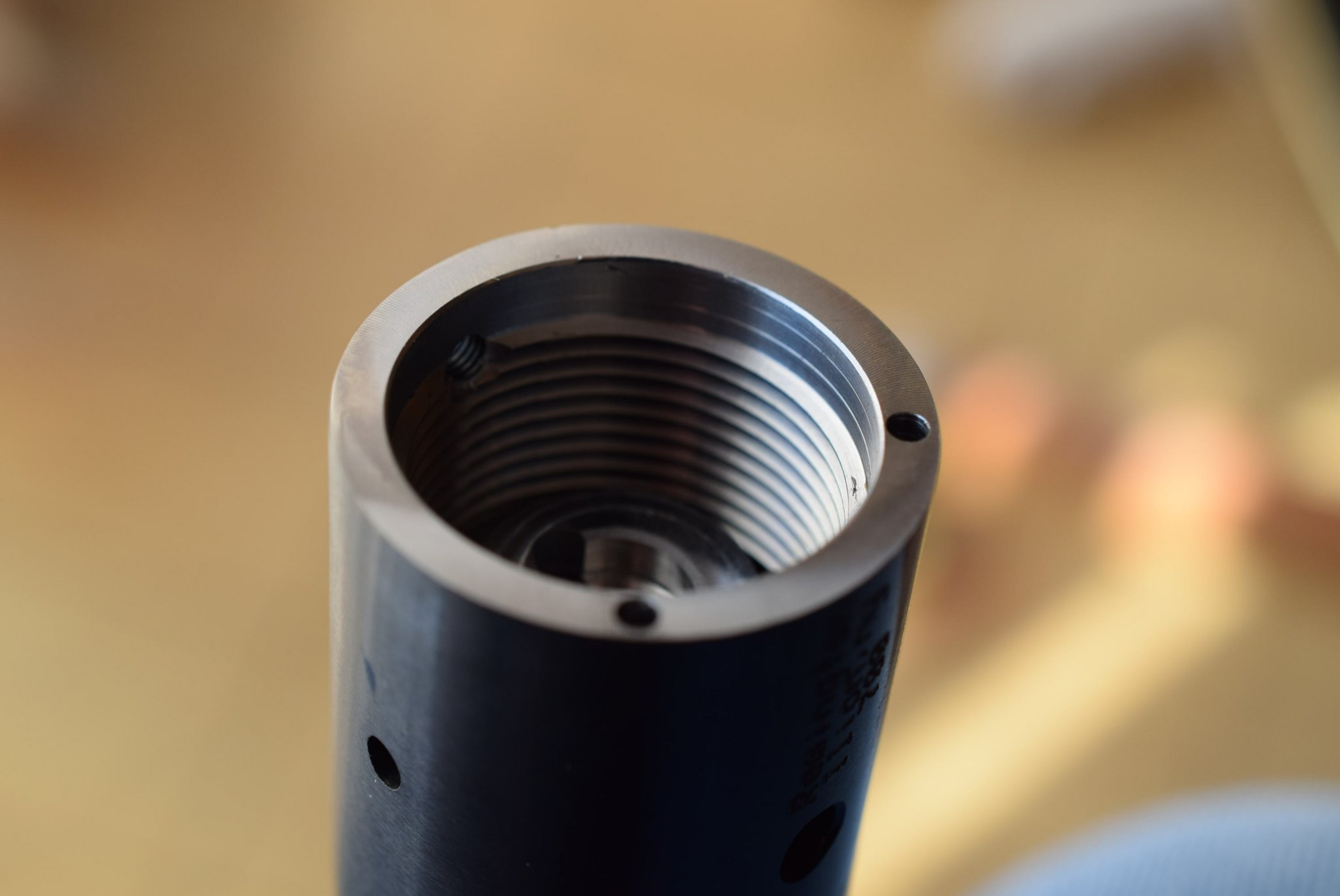

Over the past 17yrs, I've trued dozens of M700 actions in my lathe, using both a GreTan style fixture and a TrueBore Alignment system, and gotten good results, relative to builds using custom actions. The last several M700s I bought were bare actions - no triggers, no bolts - nothing but bare receivers. I always ordered PTG one-pc custom bolts, then fit/headspace them for each receiver, buying bolt stop/spring, ejector plunger/spring, and trigger pins from Brownells. I still have five rifles that I built for myself doing this, and am well satisfied with them, relative to the BAT 3L & Bighorn builds in the safe. However, I sat on the last receiver purchased until after Remington went tits-up, and didn't order in the bolt stop/spring, etc. for it. I did get the PTG bolt, complete with .061" dia striker assembly, mini-16 extractor & ejector plunger/spring, but still needed trigger pins & bolt stop, and wasn't having any luck finding these parts. I had some 1/8" drill rod, so cutting trigger pins to length was no problem, but I still needed a bolt stop & spring.
I'd seen the LRI youtube video that Chad put up when he got his 5-axis machine set up to do action truing, and was fascinated by the process, so, along with having a good deal of confidence in his company due to so much positive feedback here, I decided to ship this last receiver up to him for the installation of LRI's custom side boltstop, and since they were going to have the receiver anyway, I had them do the complete tier 1 action truing package on it, which included cutting the lugs of the PTG bolt to fit, diamond honing the receiver to fit the bolt - then splurged to include spiral fluting the bolt. By the time I'd paid for this excellent work, it'd have made more economic sense to have bought a Zermatt Origin action to begin with, but I have absolutely no regrets. Every time I get into the gun closet, I look at the completed rifle, and start looking for an excuse to take it out to the range. I fitted and chambered a Bartlein 20 cal/1:9tw #3 contour blank in 20 Tactical, threaded the muzzle for a TBAC flash suppressor/mount, put a TT Diamond trigger on it, used Hawkins DBM, and bedded it into a McMillan Game Scout stock in McWoody molded-in pattern, then used CeraKote armor black to finish the metal. My point in relating all this? - when it comes right down to the nitty gritty, there's no right answer to the OP's question, only several good choices.

the 185gr juggernauts from burger are still 3mm too long for the metal Ai mag, which came in the mail today :(
may have to just hand feed the Bergers, and keep the nice brass for re-loads?????:(
going to try an MDT non binder mag, next
what's the difference between three rib vs (TWO??) on the accurate mag
beside more pleasure for her
is that notching on the feed ramp something I can do with a dremmel??
It sure is. I did it to my Bergara B14, for the same reason. Dremel slow, be careful, and it’ll be just fine. I notched it from top and bottom, so there’s not a razor edge there. I also hit it with Oxpho-Blue to make it pretty and a little less rust-prone, but that’s not necessary.

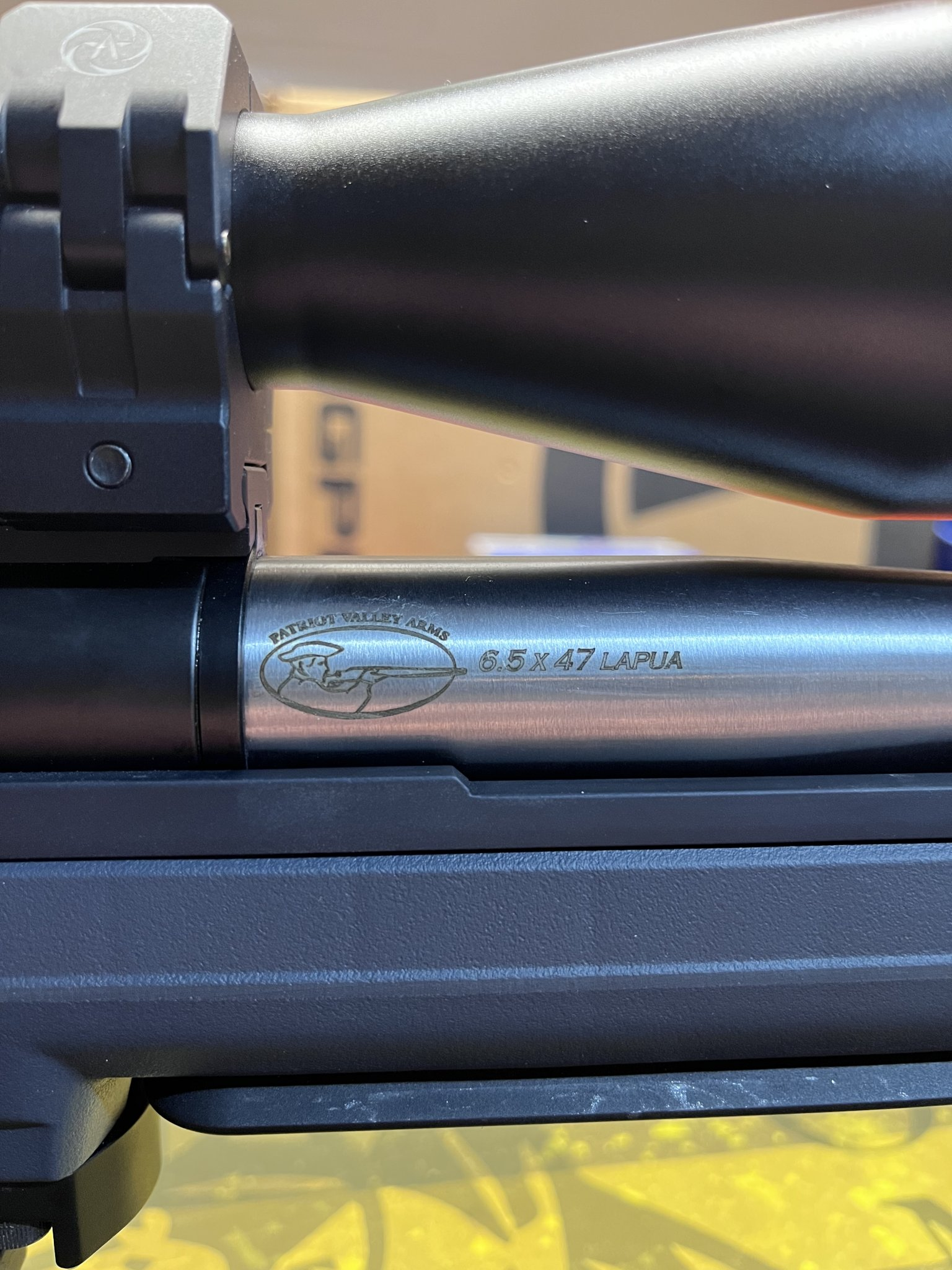

Is it just to make sure that any engraving on the side of the barrel winds up in the right place, and is visible
Yeah. The timed will be so that it presents right above the water line on the stock evenly
The untimed can be scribed radially or in several points or further out towards the muzzle beyond the stock so that it can be seen but without respect to its final location when installed
