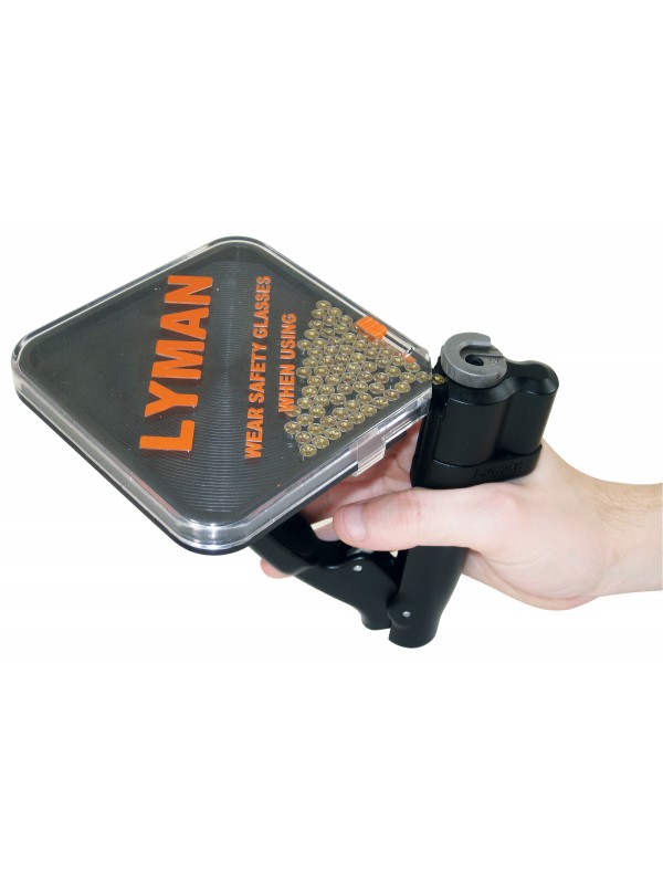

    My buddy has an old Lee Auto Prime and it's golden thing works beautifully. I bought a Lyman last month what a POS. Ram misaligned in addition to shell holder loosely fitting so keeping a primer aligned was impossible. On the couple that did go in they were sitting proud. Buddy ordered an identical Lee Auto Primer to the one he has that works great on sale.....identical problem as my Lyman. Not sure if this is a pot luck thing you either get a good one or a bad one....or QC has gone into crapper. Just going to stay with RCBS bench for now, but I'd like to hear if anyone has a recently purchased hand primer that works well for them please.

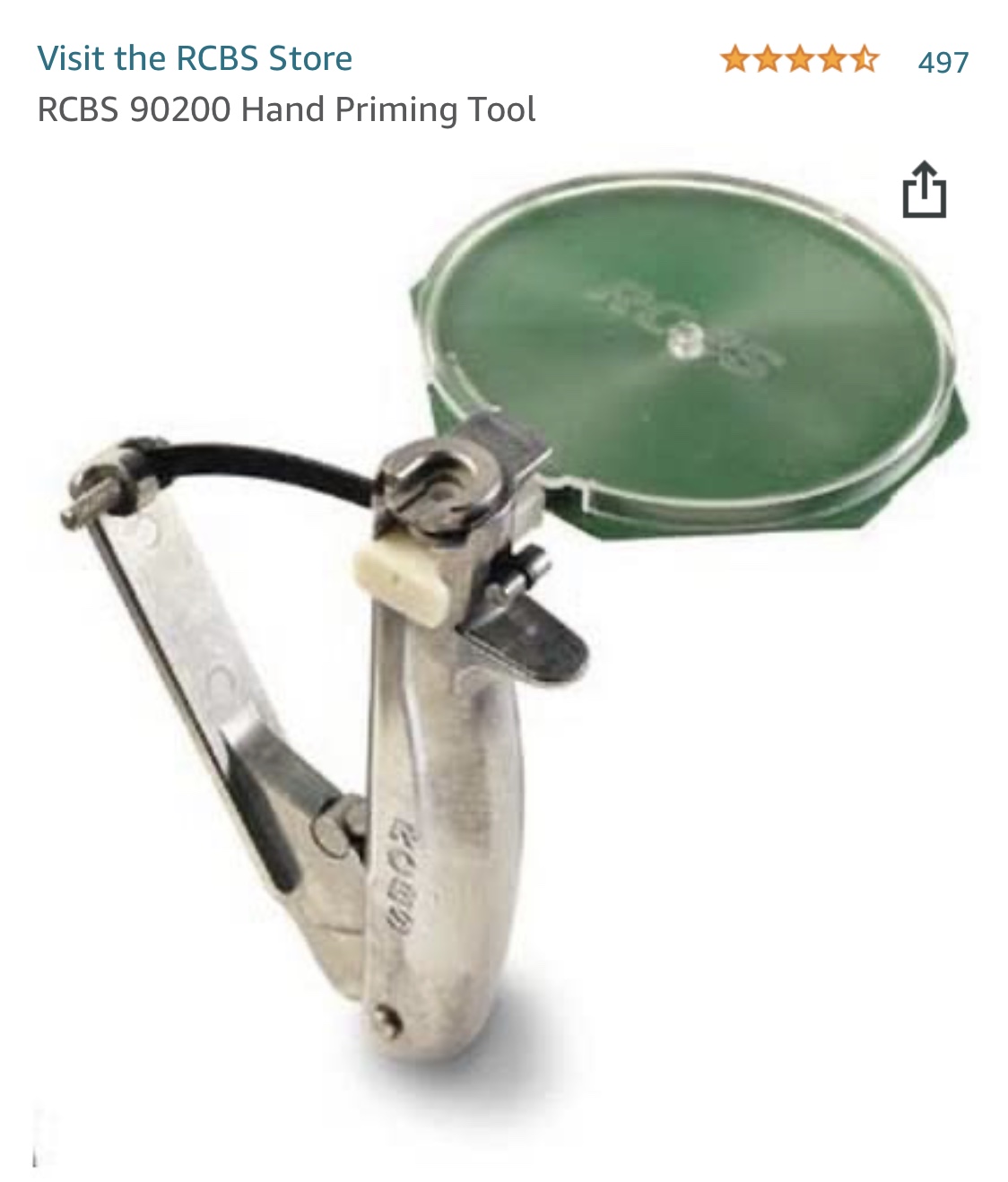

    Being somewhat old school, I use an RCBS that takes the shell holders. I get very consistent results with both large and small primers. It’s no Primal Rights CPS, but then I’m unabashedly a poor. Many, many thousands of rounds through mine.
    I've had the same one as yours for going on 30 years now. I can't count how many rounds it has primed, but RCBS always replaces the plastic inserts when they get brittle and break, at no charge.

    I've used a friend's RCBS hand primer and my personal one is the Lyman. The feel of the RCBS is really nice, but it's kind of a PITA to switch out shell holders. I've had no issues with my Lyman.
    If I had to buy a new one, I'd go with the RCBS model and buy an extra shell holder to leave on it. The RCBS just feels way nicer and smoother while seating.
