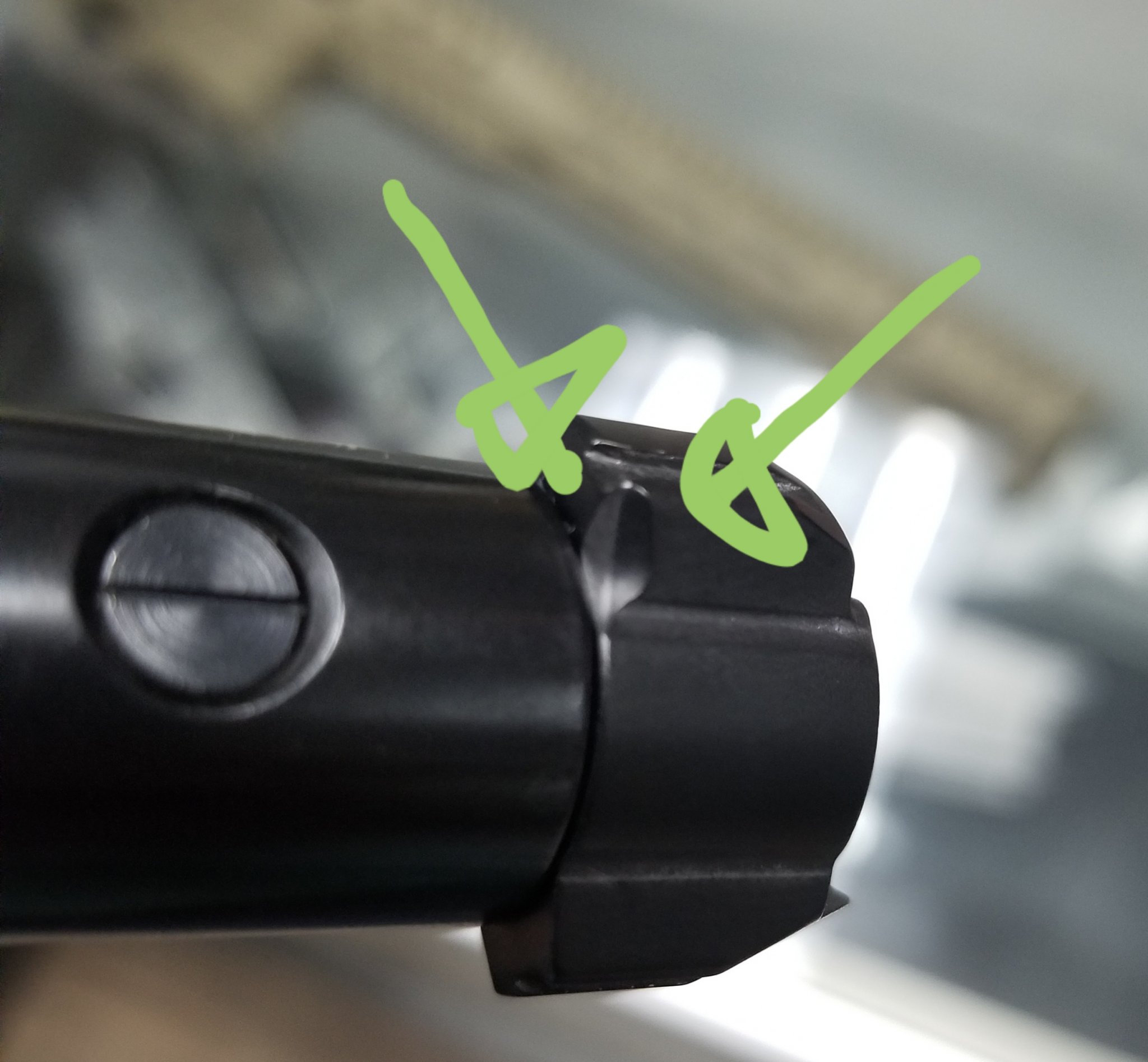

The new bolt head feels amazing. I sent my old one in and received the new one witwith 10 days with a new extractor and spring.
Reactions: atomic41
Yeah I agree with BLKWLF... I only have experience with the new bolt head, but experience no issues like you're describing on bolt close. Only had mine for a month but so far I like it a lot.
The one of mine that binds IS the new bolt head. My first production run does not bind so I have not bothered to send it in.
That being said, I chucked my plunger up in a drill bit and hit it with a file. Fixed the issue.

As others have said, if you purposely run the bolt very slowly it can be a bit clunky on closing because of the spring loaded shroud locking pin which tries to push the bolt rearwards, plus any overcocking in your trigger adding additional bolt closing effort (my CG Mod 22 has 0.025" overcocking), and on top of that I still have the gen 1 bolt head-- but that's only if you're fussing with the bolt handle very slowly on the bench. If you're actually running the rifle it's quite smooth and quick as a little forward inertia on the bolt smooths it out dramatically.
At some point I'll have ARC swap my bolt heads out for the Gen 2 design with the more gradual lead in ramps which may help ease the bolt closing effort when running the bolt extremely slowly, but for now I'm very happy-- when running the action at a normal to fast speed it's very slick and smooth so I may not even swap them at all until it's due for another barrel so there won't be any slight headspace change with the current barrel.

I have the new bolt and I cant tell any difference on close either. It does seem to not bind as easy when the bolt is all the way back like the original bolt head did if I didnt get the bolt going straight back.

New bolt head has two bevels on the leading corner of the lugs. Old head has one.
I didn't notice any difference on the three new bolt heads I got.

I received mine late last year. Had a couple light strikes and the hang ups on bolt close. Sent the bolt in to ARC, they replaced the head and installed the 25# spring and had returned in days. Still have the hang ups but no misfires. Only about 200rnds though.
I fixed my hang ups by adding a chamfer to the plunger in the bolt shroud.
