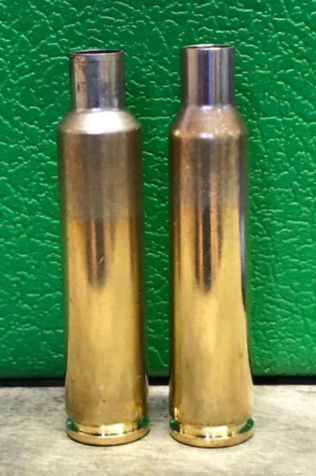

Is the rifle a lightweight hunting rifle or a heavy barrel?
If it's lightweight, there's absolutely no way the barrel has enough heavy section (just in front of the receiver) to allow it to be cut off and set back.
The improved version is larger in diameter from about .200 inches in front of the base of the brass and has almost no taper to it.
The original case has a heavy taper.
You can't put material back into the chamber for the original cartridge, but you can remove it to allow for the Ackley Imoroved.
Here's an image:

The barrel is 26 in stainless heavy
Ackley Improved...is chambering to 6.5 x 55 Swedish possible?
You need to measure how much cylinder the barrel has. That’s the non-tapered portion just in front of the action face. You're gonna need 2”-2.5” of it approx. Prior to the work, the entire body portion of your ackley chamber needs to be cut off, if this puts you into the taper forward of the cylinder, there may not be enough diameter to create a shoulder when the new tenon is cut.
