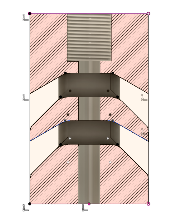

Why would a brake with the ports angled forward increase recoil? The most gas going through the smallest hole should produce the most rearward force.
Basically like attached photo. If you force the air to interact with a wall instead of being wasted. Same idea as a muzzle break right?
Ask yourself what vectors make up the gas velocity on a bare muzzle? What vectors comprise the velocity of the expelled gas on a barrel with any attachment that deflects those gasses? I’ll give you the answer. ANY attachment that deflects the expelled gasses to the side decrease the forward velocity and increase the lateral velocity. That has the effect of reducing the recoil. Baffles directed rearward are better because they are more sharply redirecting the expelled gasses to the side and rear, but even baffles angled forward are deflecting those gasses laterally.

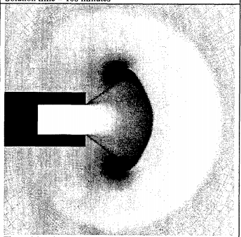

Mainly figured there would be some way to capture the wasted energy in radial expansion to direct the force rearward. Doesn't hurt for me to play with the modeling and see if I can get anything out of it.
