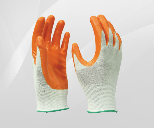

    I've got one of those and I like it. Couch, beer, T.V, check. I need to plastidip the handles though, that textured metal gets at me after a couple hundred military crimped primers.
    Nitrile dipped cotton gloves, 4 bucks for a three pack on the hardware store end caps.
