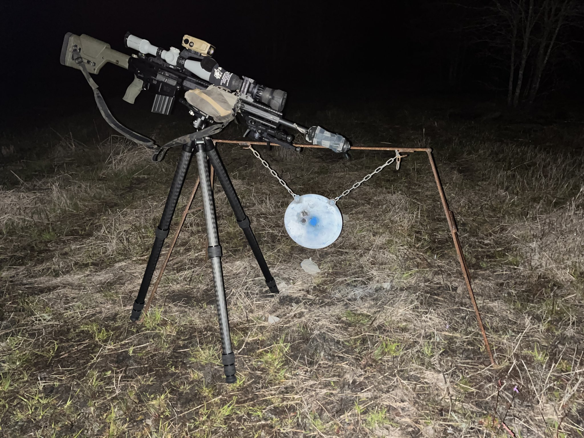

New to the world of NV. I grabbed a pvs-30 recently to start playing at night. I noticed when the moon was straight overhead the targets got almost shadowed in the optic and made it very hard to see good detail shooting. Without grabbing a Wilcox Raptar so I can leave my Vortex Impact, what IR illuminator do you recommend. Some hunting, a lot of LR shooting.

I have been going through this now for several months. My best friend and I hunt and shoot together a lot. He has a EOtech Clip-NV and I have a PVS-27. We have tried a bunch of illumination devices. Right now he is running a full power PEQ-15 and I have a Luna without the filter. Although the Luna is a bit janky, for the money it is really good. I love the fact that is has variable power output and beam divergence. Having too much illumination is often a bad thing. A lot of times a wide beam on lower power is what’s needed to locate and identify a target. The Luna is darn good and will illuminate targets 800+. For the money, I won’t be switching anytime soon. Buy the adapter for the Surefire tailcap, remove the filter and go shoot.

Issue PEQ15, mil issue NGAL, and recent Somogear peq 15. Heck even an old giant light force spotlight with an IR cap on it. Luna has hands down been best with filter removed. Using SIMRAD and Luna with 50% illum one night could count antlers on a buck at 1200m. Mount is garbage, constantly need to push/adjust Luna to point where you want it, but man does it light things up and can tweak power/beam diameter for best possible image. For the price it’s a no brainer.
