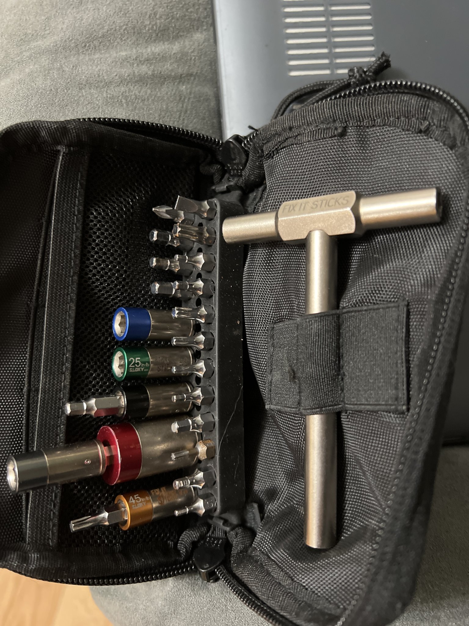

I like Fix-It sticks - it's what I carry in my pack and use at my bench. They are not cheap.

I’ve been using the Borka kit for years and recently bought Fix It sticks torque driver to give a try, which I am impressed with. I still use the Borka for the finer torque requirements, but for the larger torque needs, the Fix It Sticks are a easier on the thumb.

Fix it sticks
My buddy, F-Class John (youtube) did a comprehensive, systematic and detailed review of pretty much every viable option out there. He (and I) ended up with Fix-it Stix. I love mine...having tried numerous others.
My fixit sticks kit is on my table and goes into any range bag going out the door. I have a wheeler I used once and out back in the box and is now in the closet. The fixit sticks are so handy

Indeed. The hardness of their bits has a lot of variability too. I have Fix-It Sticks kit in my range bag but only use it as a last resort. I try not to use things like torque wrenches in the field as much as possible. I also try to avoid consumer grade tools on the bench as much as possible too.
I was over at the fix it sticks page yesterday. They seem adequate as a field-expedient solution.
