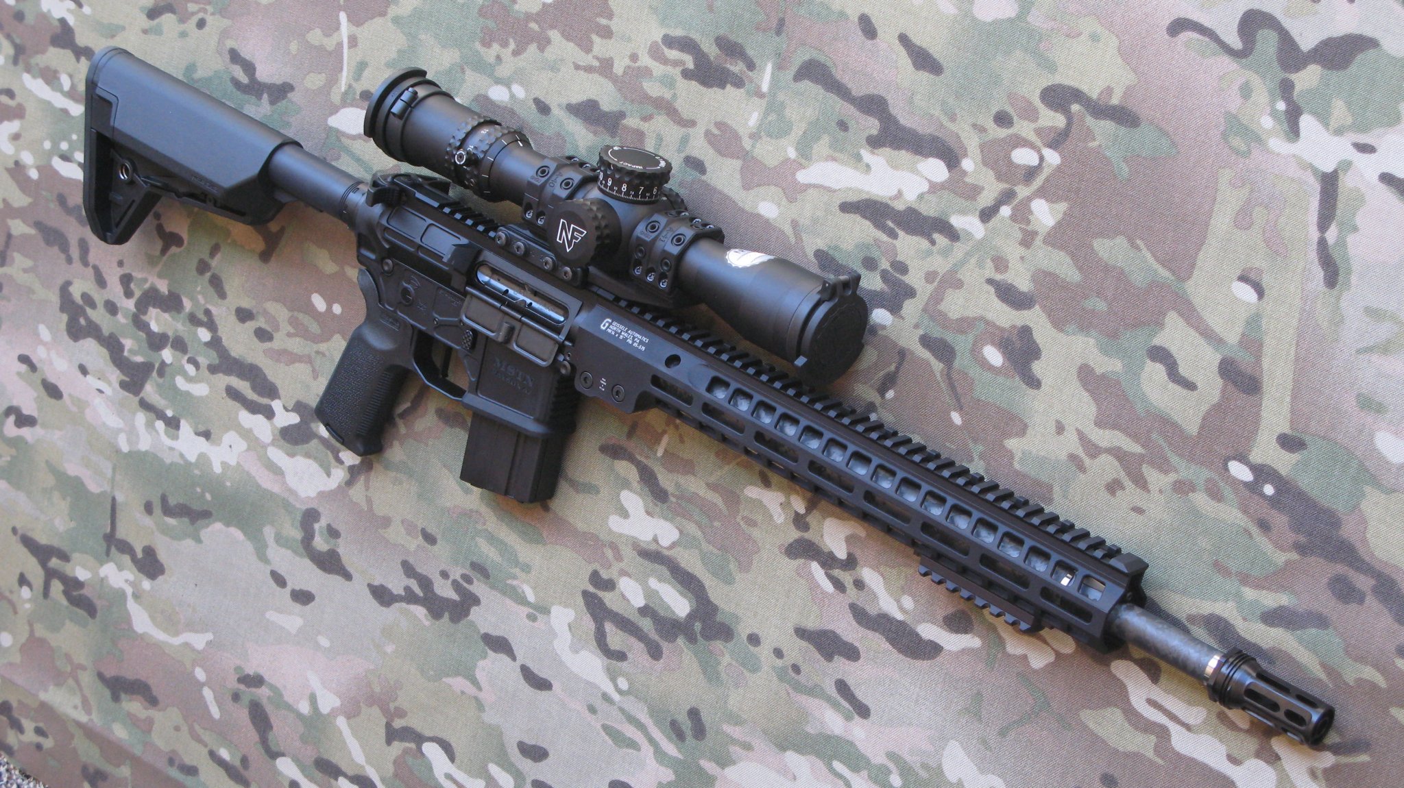

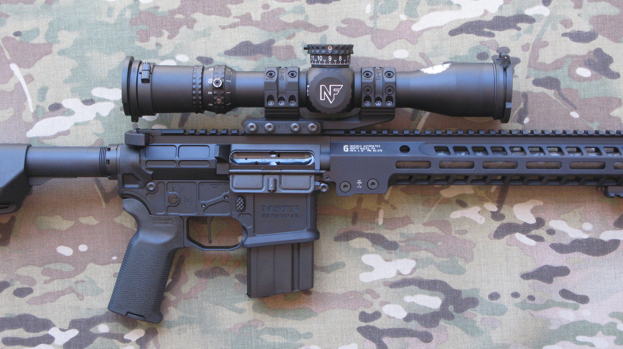

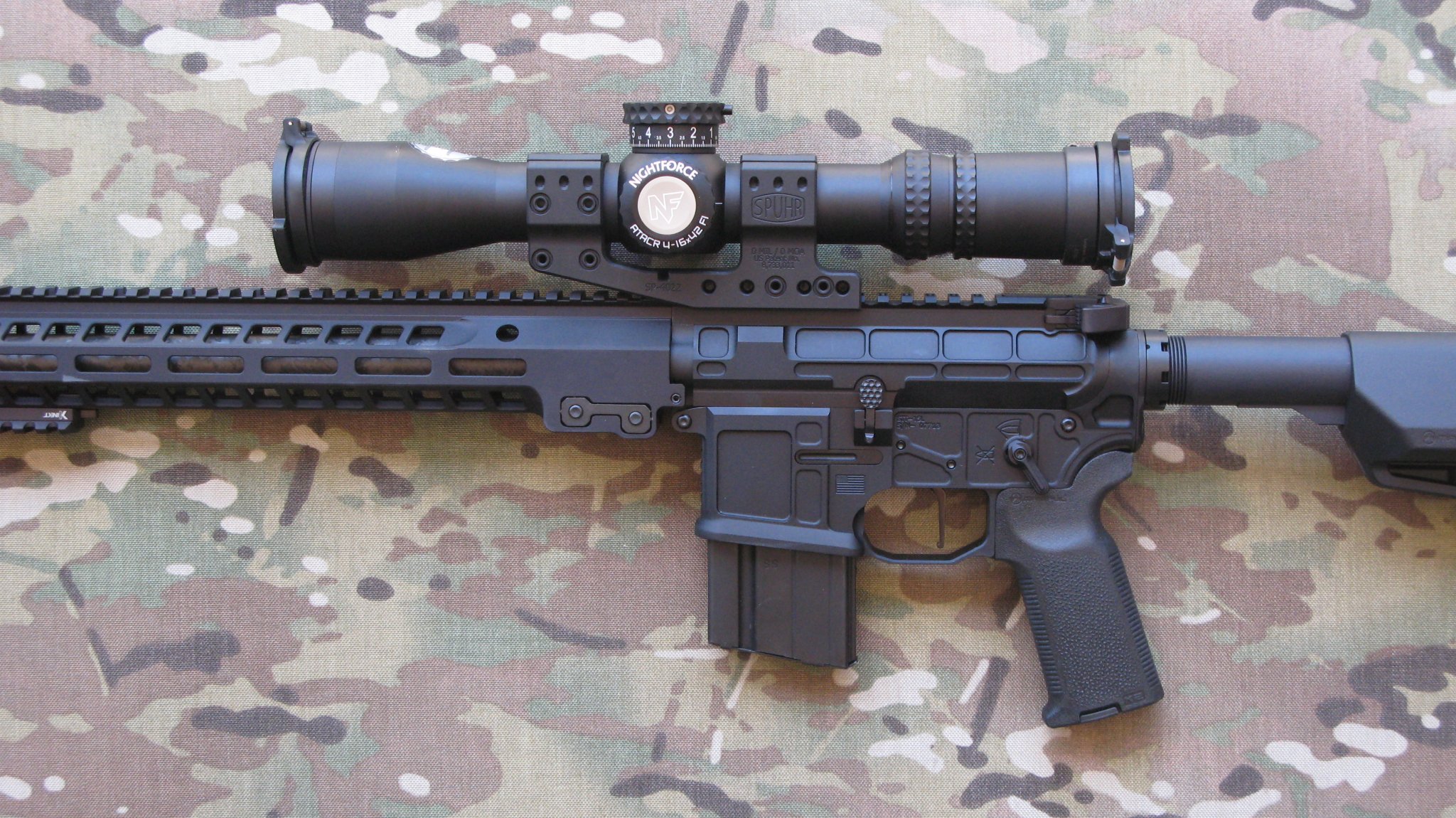

Nightforce ATACR 4-16X42 F1:
santanpillarreceiversetbuilds
