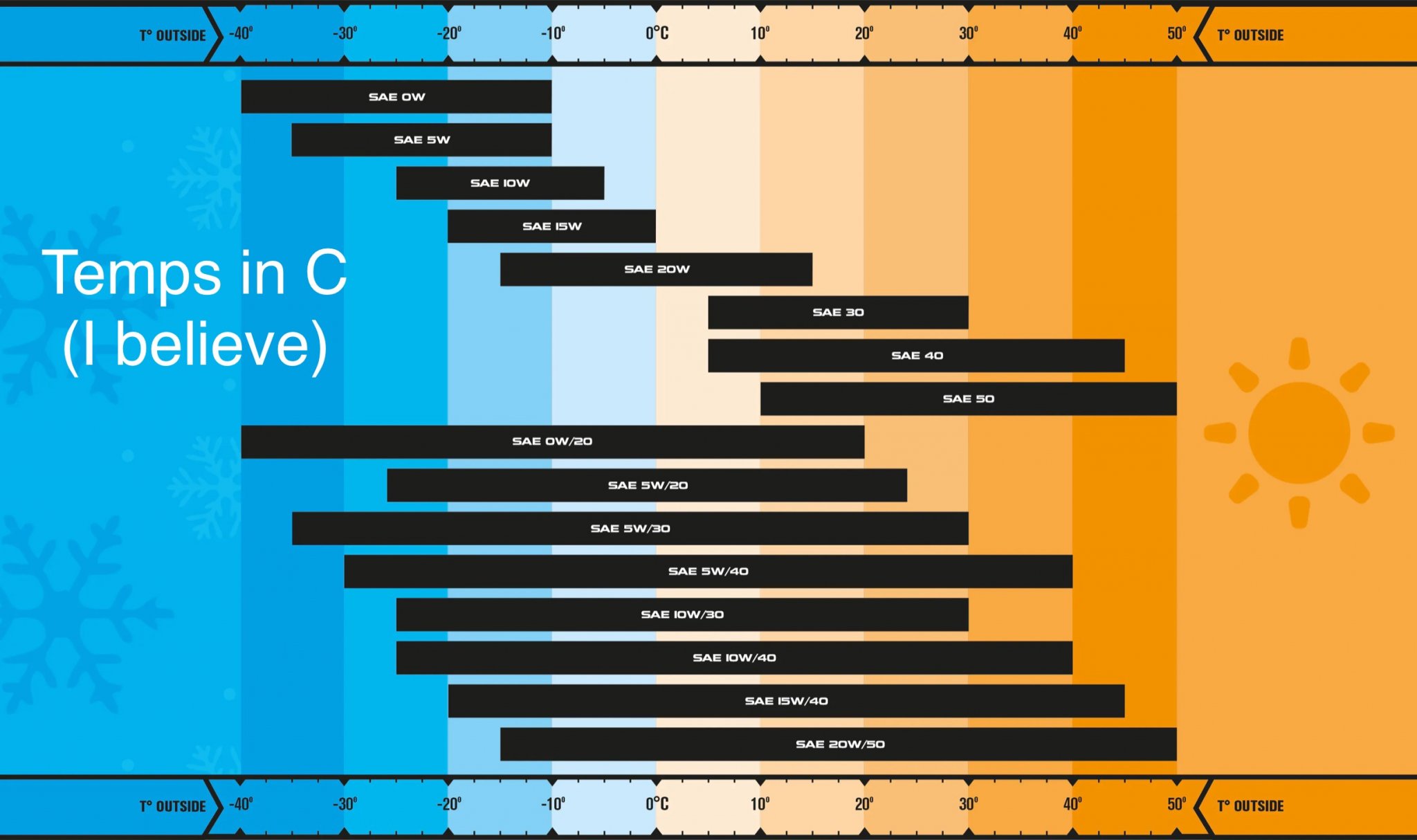

Also, for oil, Mobile 1 in whatever weight for your temps. The stuff works in an environment that makes firearms use look laughable. Below is an oil viscosity chart, unfortunately in centigrade, that I found somewhere. I think I use 5W/40 which is good from -25°F to 105°F. Or do I use 0W/20 (-40° to 70°F)?
Fuck I have grease on the brain.
Edit: don’t use cheap oil you fags. Here’s a link that you can follow for pour tests and more of my posts on this matter.
