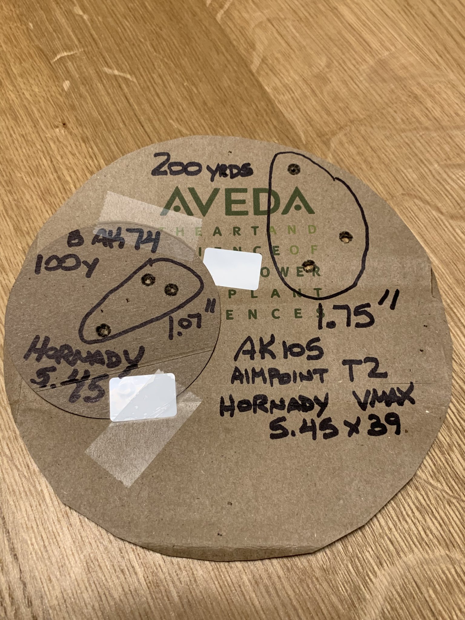

I’ve tried all sorts of red dot zero targets but could not get any of them to work well. We just struggled to hold properly on them. Here is what we have found works best for us when we are zeroing with red dots. All our red dots are 2 MOA dots. We zero at 100 yards. I bought a punch at the craft store that punches out 3 inch circles. I prefer to use dark brown cutouts laid on white paper background. I can center the 2 MOA red dot on the 3 inch brown paper dot very easily. I also verify at 200 using a 6 inch brown circle target laid on white paper backing. Here are my 5.45x39 AK74 ( AK105ish clone) zero targets at 100 and 200. I can only get consistent holds on these brown dot targets. Maybe others can use the common red dot zero targets but we couldn’t
