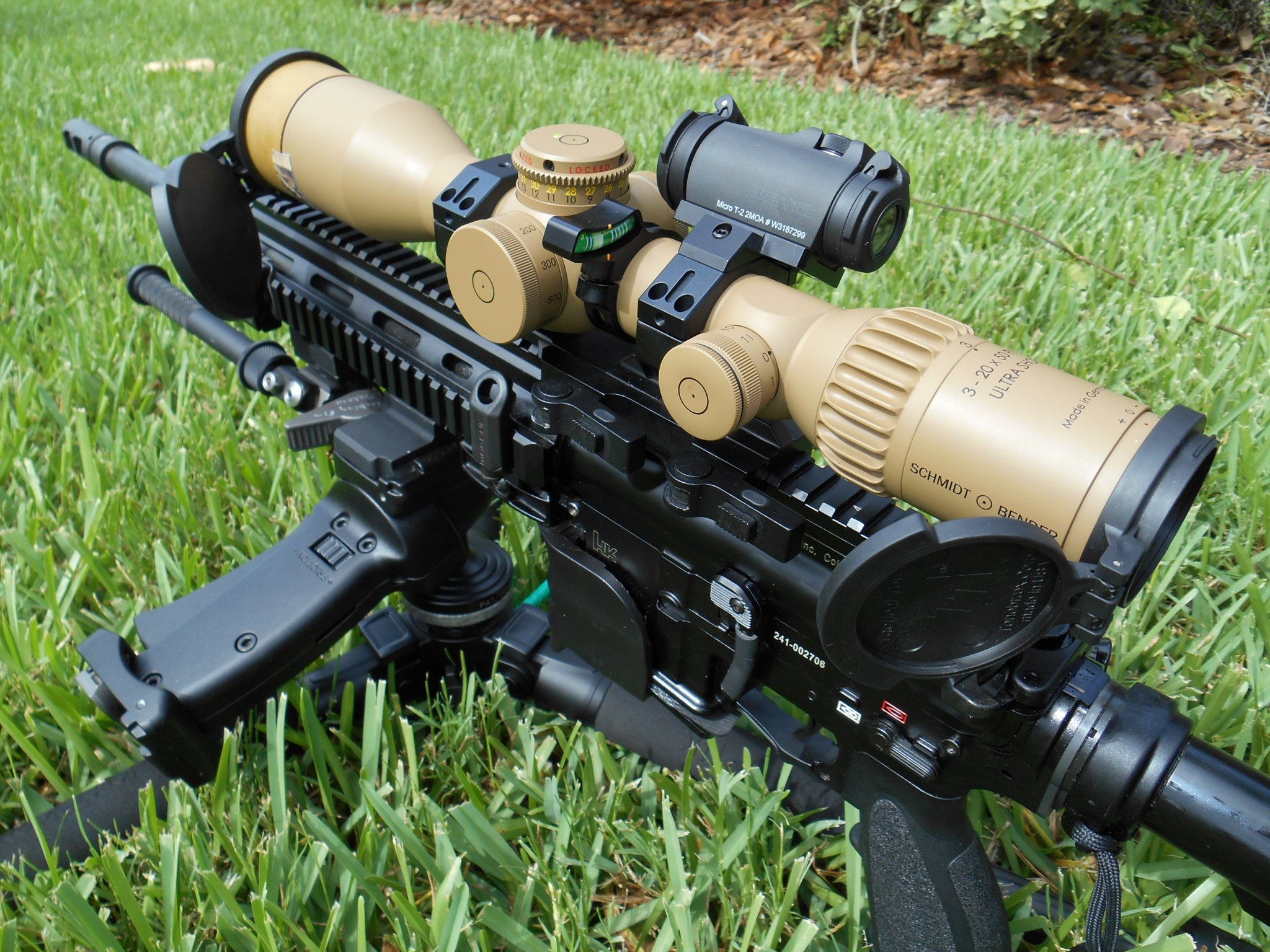

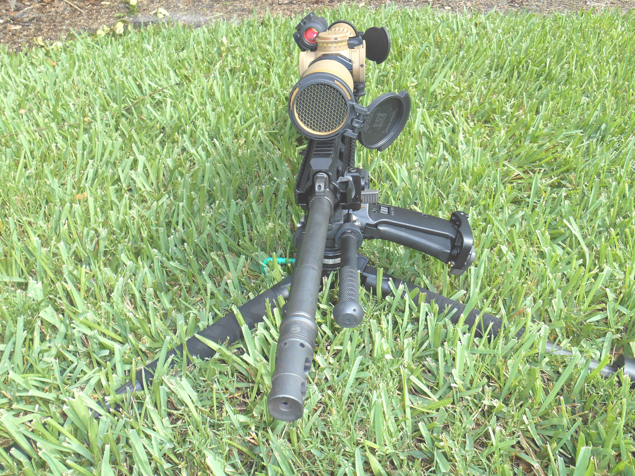

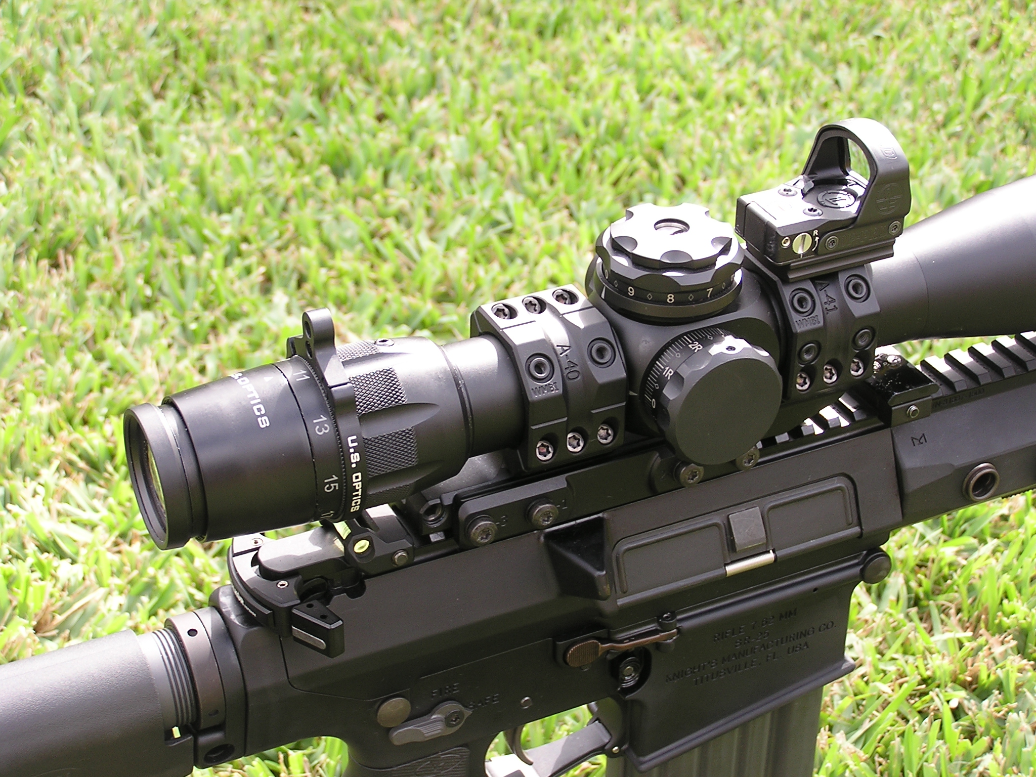

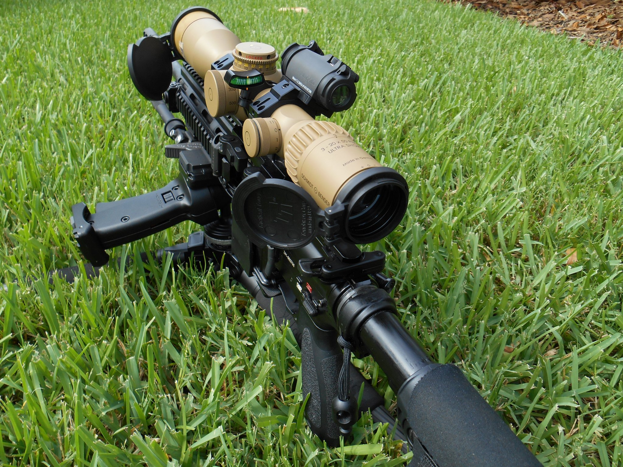

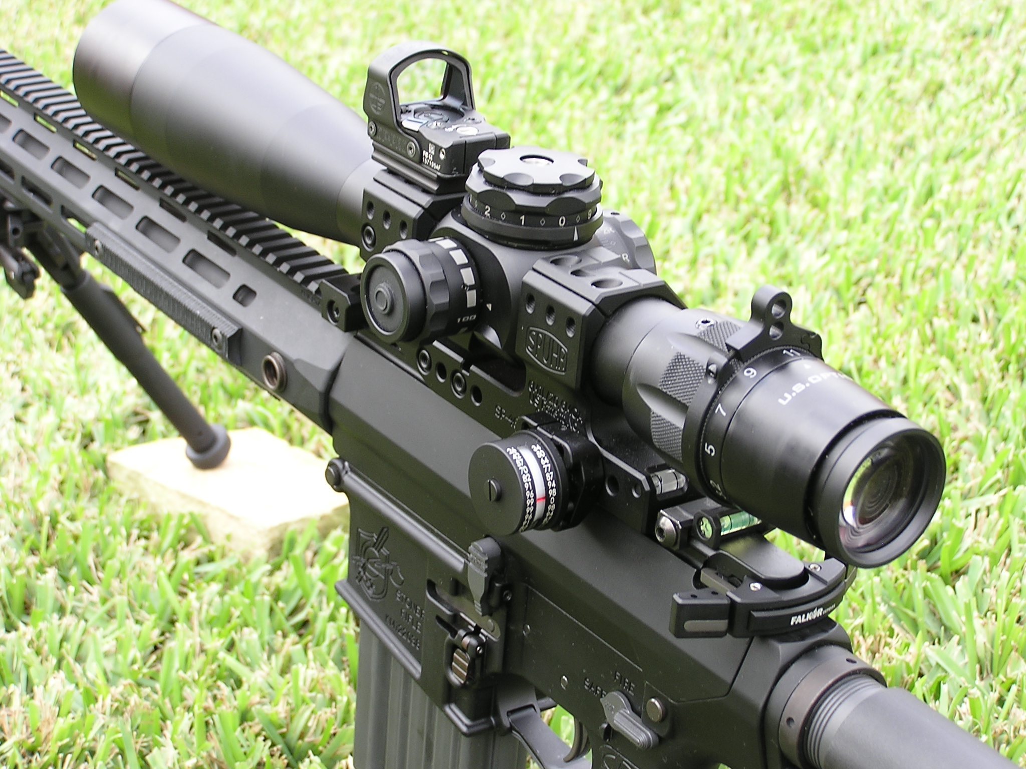

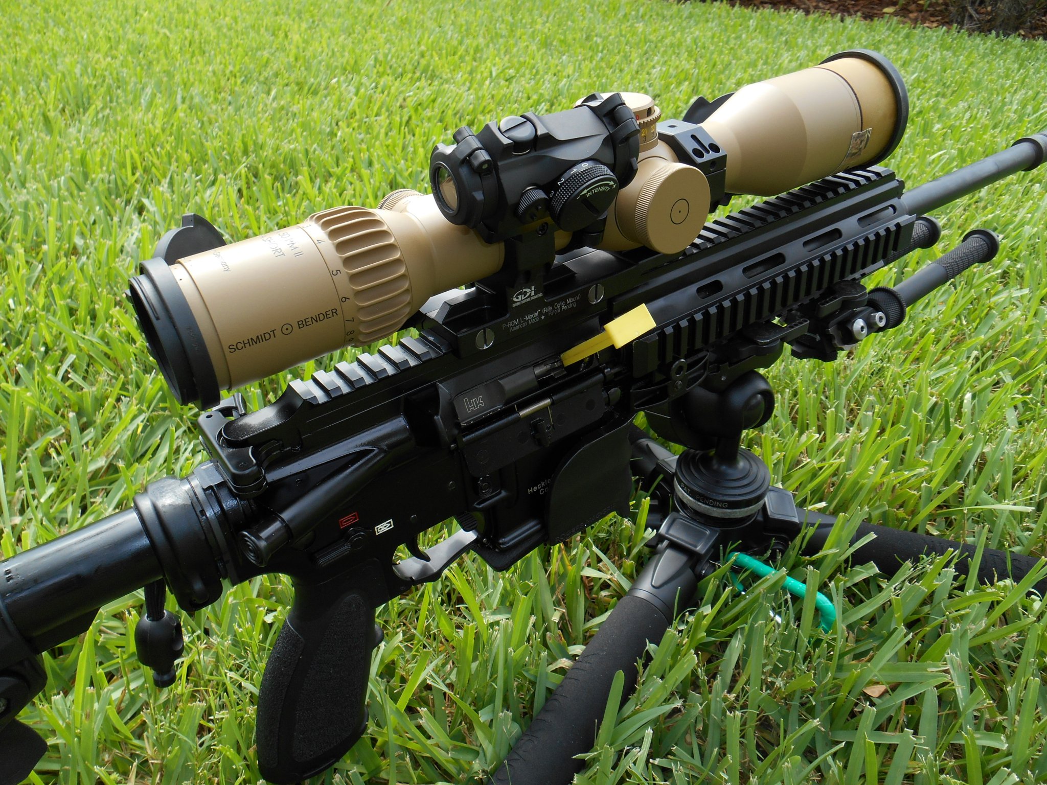

I use a number of the RDS/scope combinations. This offset style seems to work best for me.
S&B 3-20 short dot , Aimpoint T-2 with q-d GDI mount.
