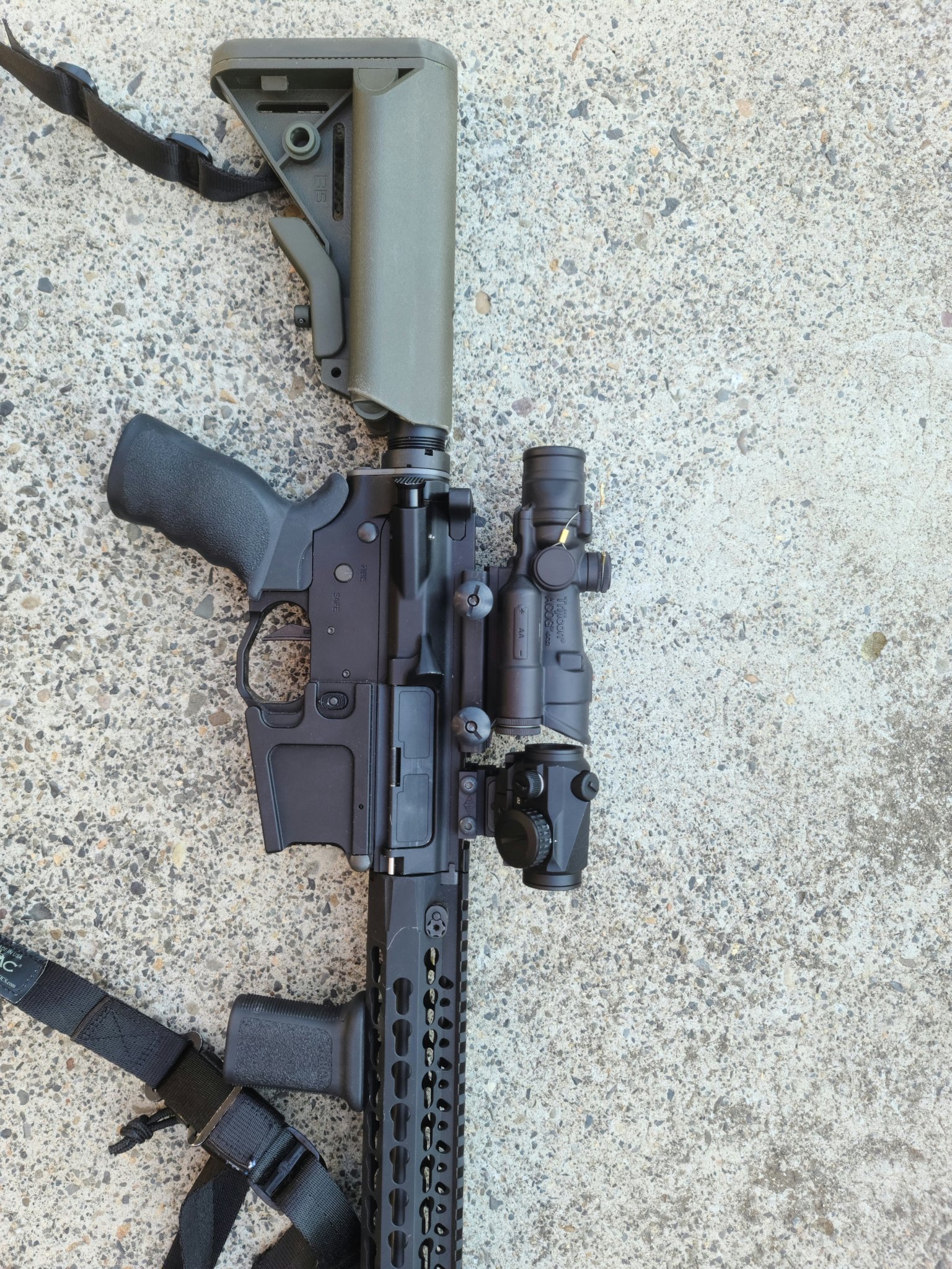

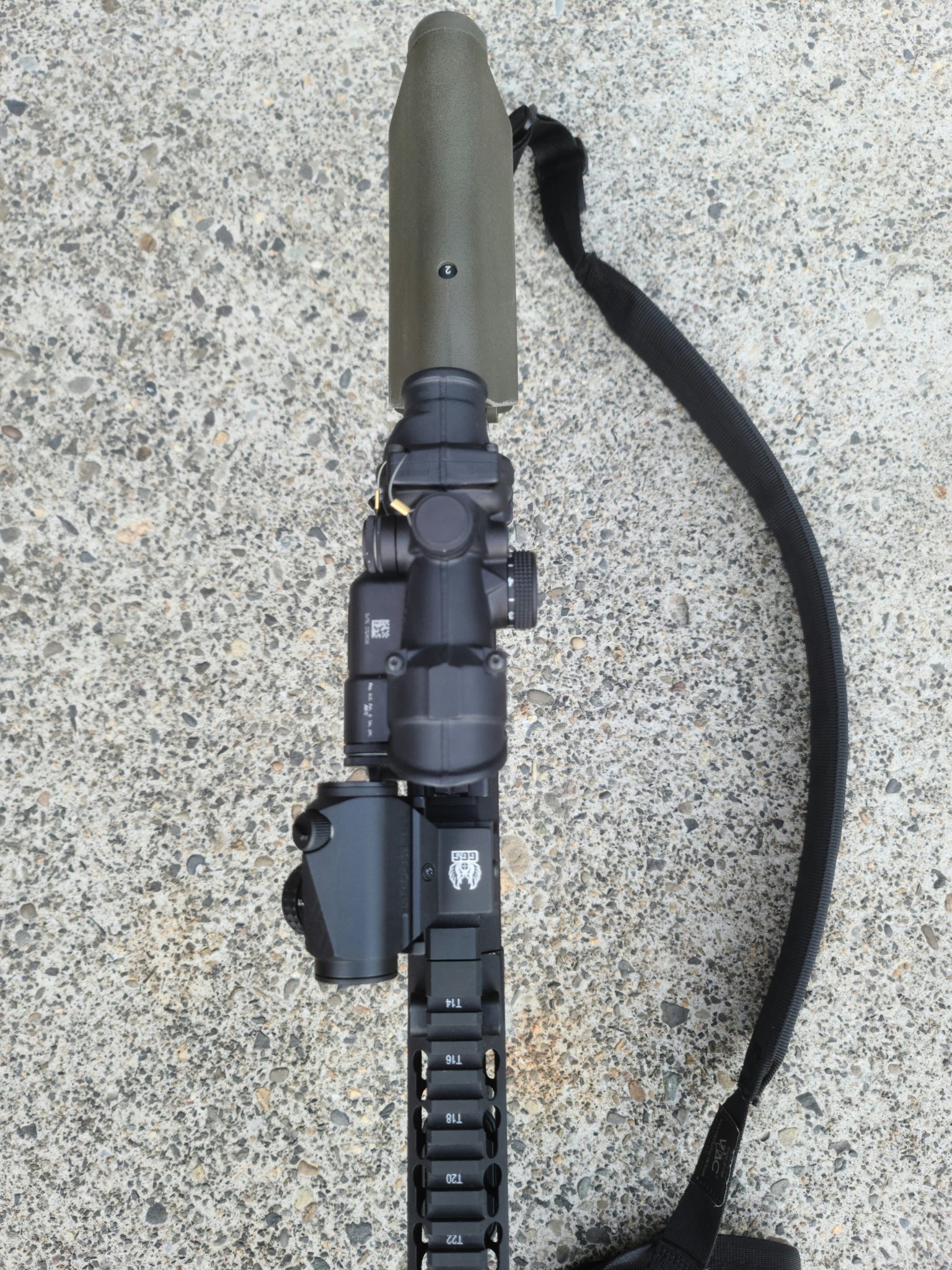

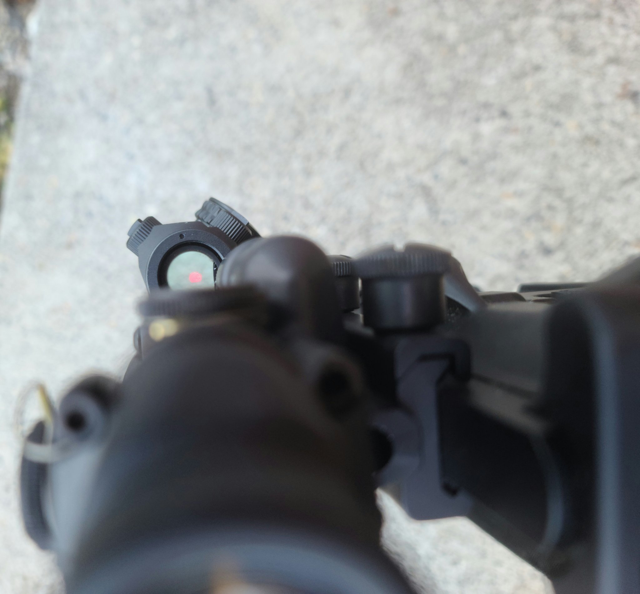

Very recent acog and offset convert. I love it. Super fast and easy with no dicking around with dials or throw levers. My offset is a chinadot in a cobbled mount and I love it anyway. Will be upgrading to t2 and probably an arisaka. I'm in thick brush a lot so in a lot of ways the dot is my primary and the acog my secondary for when I want a closer look at something. I know the guys that have been running this setup for 10 years are like yeah duh but I'm amazed how natural the setup is.
