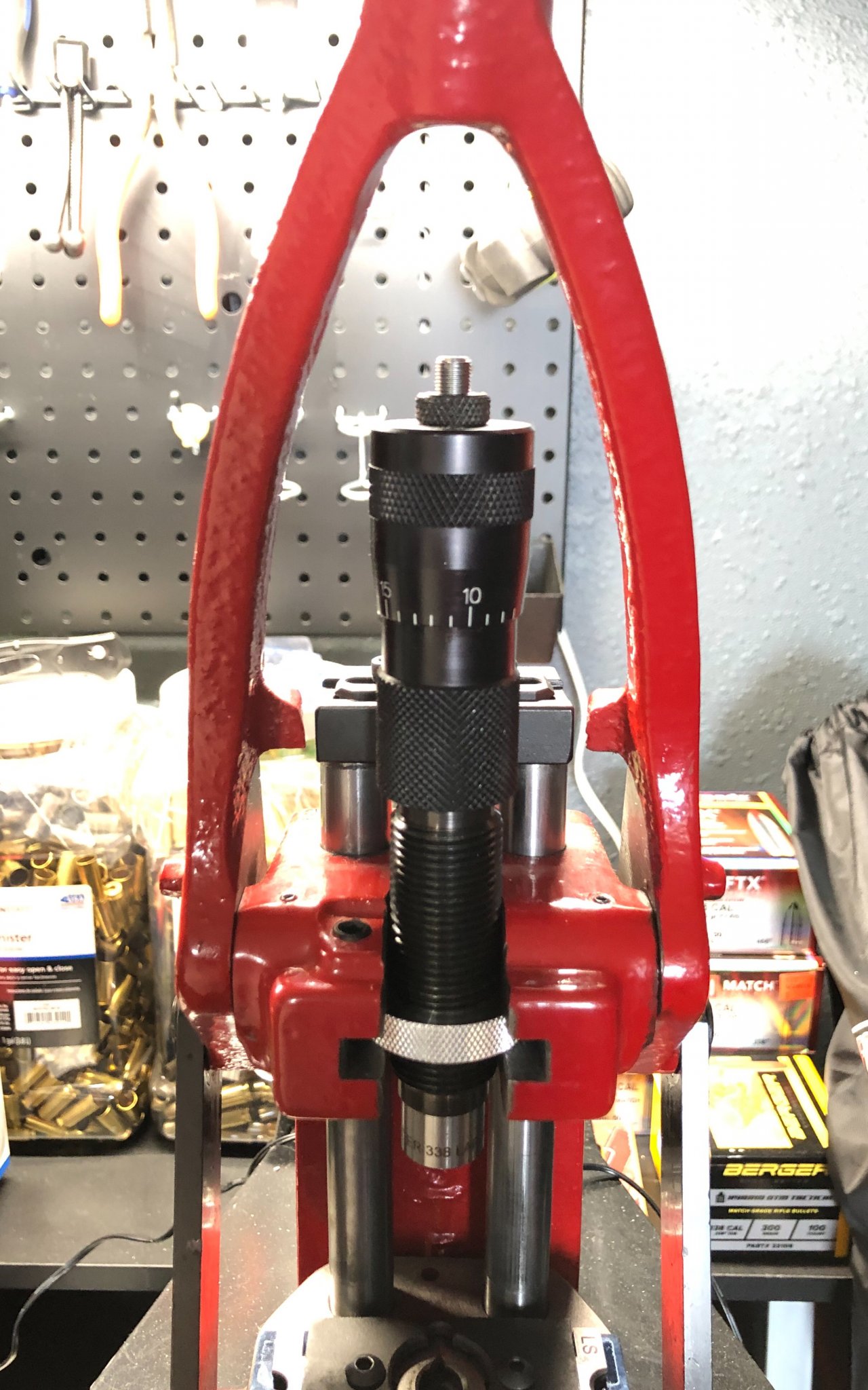

Here is the Forster Ultra Seater Die clearance
All my Redding micrometer dies clear the COAX handle. Including the .338LM neck sizing and seating micrometer dies. I like them, and have nothing to complain about re: Redding.
