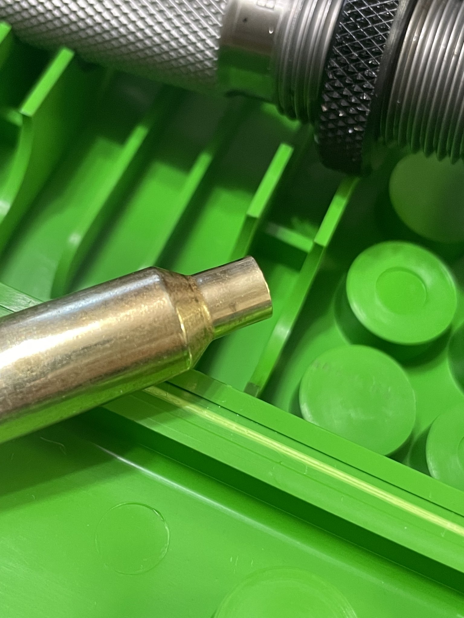

I just got a set of Redding dies for my 6.5 RPM and having a difficult time sizing brass. Both once fired and factory new. It is very hard to get them fully in the die and nervous I’m going to sheer the rim off. Is something not adjusted right or are the outside necks too thick?
Thanks

Lube and how exactly did you set up the die?
And I ran the ram all the way up and screwed the die until it stopped. Then screwed down the decamped until it barley pushed the primer out
Nothing wrong with One Shot, I also use it - no issues. Die set up could be your problem. Here’s how I set mine up.
1) I take 5 pieces of fired brass from that rifle, pop out the primer then used a Hornady headspace gauge and dial calipers to measure the case head to shoulder datum. I record the most frequently occurring value across the five.
2) I screw the die in until it touches the shell holder with ram all the way up
3) I lube and size a piece of brass
4) I measure it he case head to shoulder datum and compare to my fired case and adjust the die in or out based on the measurement value and size brass until im .002” less on the case head-shoulder datum of the sized brass compared to the once-fired brass I measure in step 1. I then make index marks on the die, ring and press to keep track.
ETA: I adjust to .004” clearance for gas guns.
Is your process similar or the same?
Reactions: diderr
If they are brand new and you only ran a few pieces, try taking a q-tip with some lube on it and rub it inside the die. Every time I get a new die or clean one really well, I find priming the die itself with some lube makes a big difference. I only have to do this once until I clean it again.
My hypothesis is that spanking clean dies scrape off the lube from the case after it first starts touching, leaving nothing once a case starts traveling up into the forming area.
Reactions: diderr

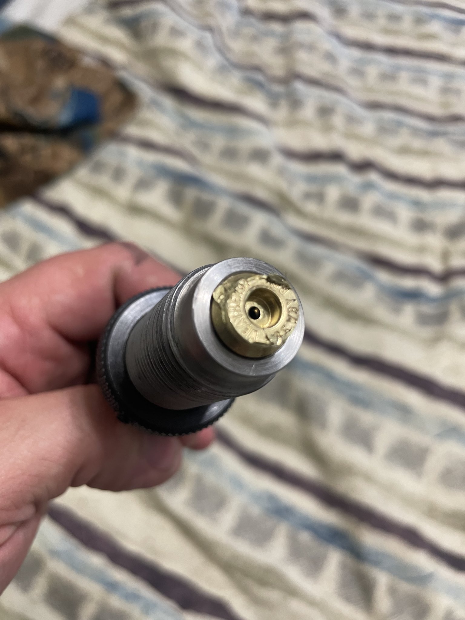

@diderr - from Redding's site:
"Because EP agents are not present in ordinary oils and greases, they are not suitable for cartridge case resizing. Use of improper lubricants will result in a multitude of problems, some of which include: stuck cases, scratched cases, difficulty resizing, etc."​
"If your dies are new, the original preservative oil the dies are shipped with is not a case lube and you should remove it thoroughly before using the die as the instruction sheet stipulates.​
After cleaning, apply a light coating of Imperial Sizing Die Wax or Redding Original Formula Case Lube to the die's interior with a Q-Tip®. Be sure to examine the die thoroughly and remove any excess."​
I cleaned the interior of my FL Redding die with gun solvent (BC Gun Scrubber) and then applied some One Shot Case Lube as I too like that product.
Hopefully this info is slightly helpful.

Could be the die. I have a Redding 6.5 Creedmoor die that was really hard to break in. I was using Hornady Unique case lube and if you put enough lube on to go in and out relatively easy you would start getting case dents. After a few hundred it did get better, not great. Emailed Redding about it but never got a response from them. Finally replaced it with a Forester and then a Whidden and never had the same issue using the same lube.
That’s because those dies have a vent hole for excess lube to escape.
No it is because the other dies where made a lot better. I use Hornady lnl bushings which tend to block the vent holes anyway. The Redding was a pile, bad from day one and no you are not going to convince me any differently. I own it, I've used it and I know.

answer I got from Redding. It was having trouble with virgin brass too; like harder than anything I’ve ever sized. Hopefully they will get it all sized right for me
I didn’t. Man these are a lot pickier than the RCBS and Forster I normally use
I think you have a bad die, even a decent die shouldn't act any different than your other dies. Everyone in the world doesn't use Imperial and we all get by with what ever we are using, the RCBS lube should have worked fine and I would bet it will work just fine in your other dies. Die makers don't admit they put out bad dies but sometimes they do.
If you do send it in for repair mark it to see if you get the same one back or they just replace it with one that is in spec.

All Redding dies will do this if you don’t break them in first.

If you take a brand new Redding die and remove the protective lube using a solvent like brake cleaner or similar it will leave you with bare metal that is bone dry.
They polish these dies with sandpaper on a dowel. This causes fine burrs on the inside and these burrs scrape lube off the brass. That’s how the brass gets stuck and that’s why the die feels tight.
Remember, the brass is not supposed to touch the inside of the die. It’s supposed to ride a layer of lube that’s in between. Something sharp like a burr that cuts through the lube will fuck up the process.
So what to do?
I lube the inside of the die and the case. I run the case into the die until I feel resistance and then just a little more. I withdraw the case and the lube is partially scrapped off. I relube the case and run it up into the die again. This time it goes in deeper without resistance. Once I feel resistance I go in a little more and withdraw the case. I relube the case and repeat the process until the whole case goes in.
After the third case the die smooths out and is good to go. The break in process flattens out those sharp burrs. You can clean the die with solvent and not have to worry about stuck cases again.
