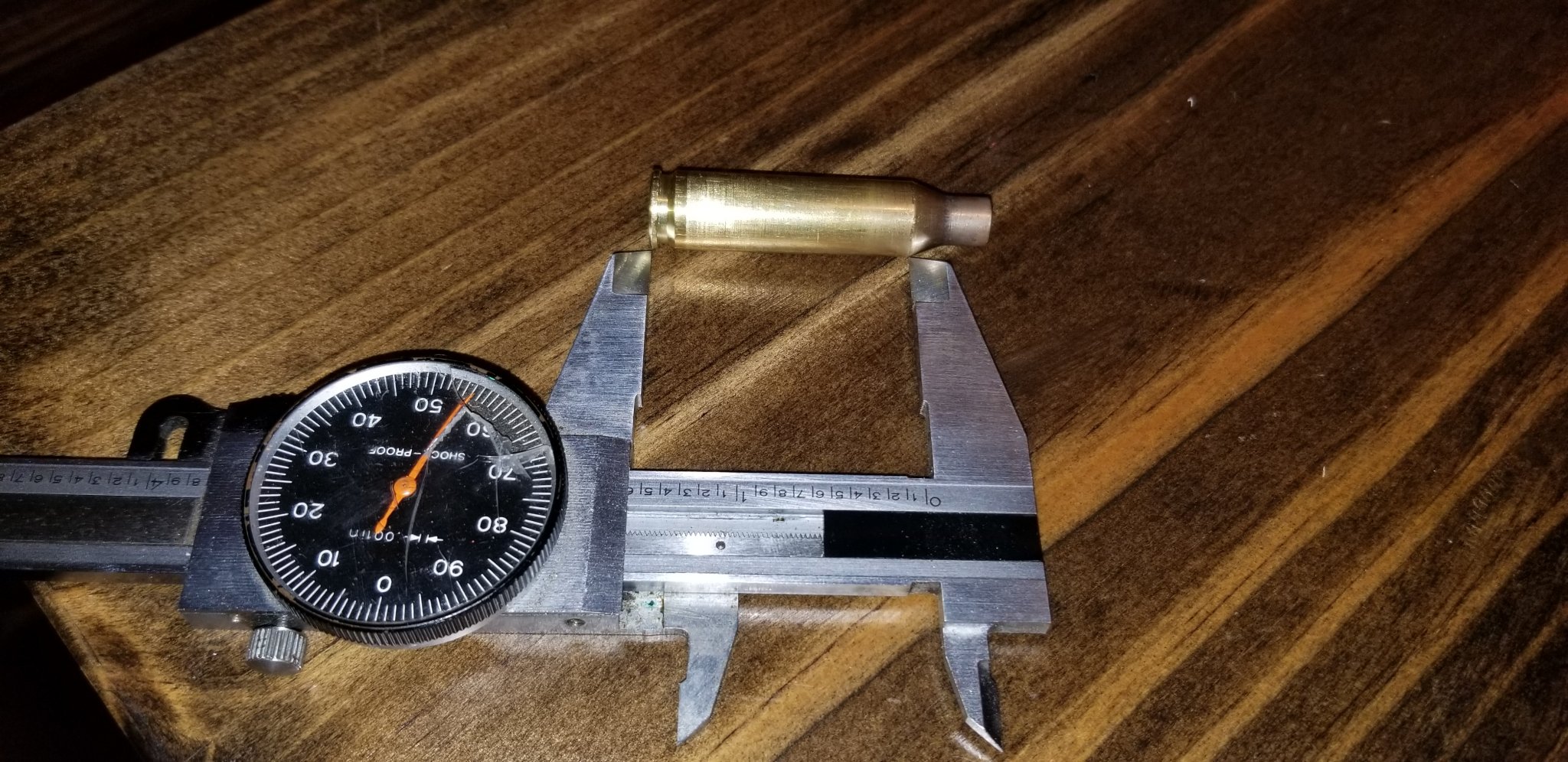

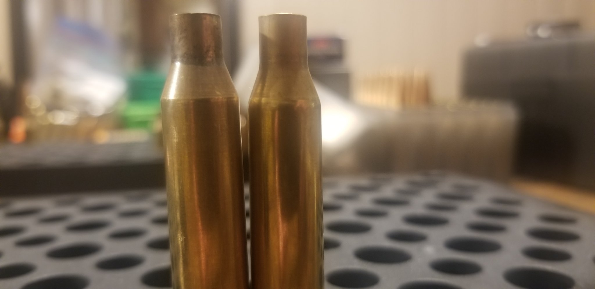

    To preface I am a complete reloading noob, these are my first rounds I've tried to reload.
    Got a redding competition die set used put the FL sizer on my new Lyman 8 station turret press, sprayed everything down with hornady one shot, and started going to town on my once fired 260 rem lapua brass. FL sizer was installed by running ram all the way to the top, screwing die down til it contacted the shell holder, then backed it off a 1/4 turn.
    Noticed after I did about 60 pieces of brass that the shoulders were getting bumped back way to far, like 50 thou too far. Also I have a .289 neck bushing die installed that was sizing to tight I can't remember exact measurements but I was getting around 15 thou of neck tension.
    Switched over a regular ol RCBS FL sizer and got much better results, bumping shoulder back 2 thou and sizing neck properly.
    Did I do something wrong? Can the brass be saved? Is it safe to load them up and shoot them?

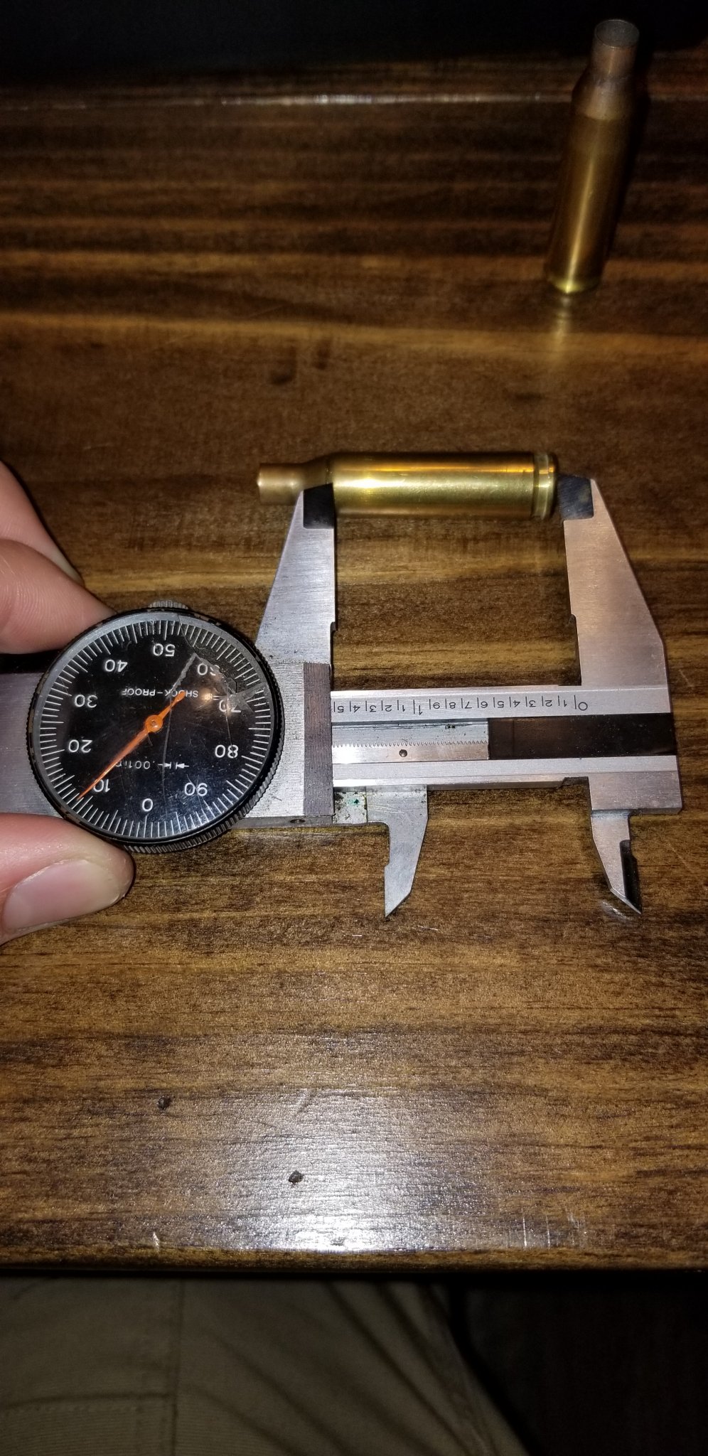

    Yes I know the caliper glass is broken, yes they read accurate. If I measure my bullets they are dead nuts. 264
    That’s not an accurate way of measuring shoulder length
    Yes I know it's not 100% accurate but it's close enough to see that it's bumped back way more than 2 thou. The neck doesnt even look right
    So I'm assuming this brass is not salvageable? Is it possible I set the die up wrong? I didn't set it up any different than the rcbs die and everything came out fine on that one
    You can not get a good measurement like that. You need to measure to the datum line. Ie a specific diameter on the shoulder normally in the middle of it.
    You are looking at a 2 thousands bump and canot hold calipers consistently to that dimension strait.
    Get the tool and probably toss that 50 thousands brass, lesson learned.

    I set that die up exactly to the redding manual.
    Set the rcbs up exactly to the manual also.
    I understand that the measurement i have is not exact even down to 10 thou but you can see with the naked eye that shoulder was bumped way too far. I'm trying to figure out why it happened.
    The brass is salvageable.
    You'll need to run the neck into a 270 or 280 expander and then back through your properly set die. This will create a false shoulder and allow the old shoulder to move forward without brass flowing from the web area.
    Basically, you'll be fireforming the shoulder back into place.

    Loaded round that I used rcbs die is .294
    Brass used on redding die w/ .289 bushing
    Outside neck is .284-.285
    inside diameter is .254
    Neck thickness is around .016-.017
    Not sure why that bushing is sizing so much smaller. I double check to make sure it actually says .289
    That’s cuz when a neck goes through a bushing it’s walls have to bend and flow around the construction. The bushing is labeled by its inside diameter, not what the neck actually sizes to.
    When I was using bushings I typically got .002” neck tension by using the same size bushing as my loaded neck diameter. This is because the same dia bushing actually sized .002” smaller when I measured the neck in the middle. As the brass got harder I had to step down to a smaller bushing due to spring back.
    If the OP has a true loaded neck dia of .294” then he should get a .292” bushing as a worst case scenario.
