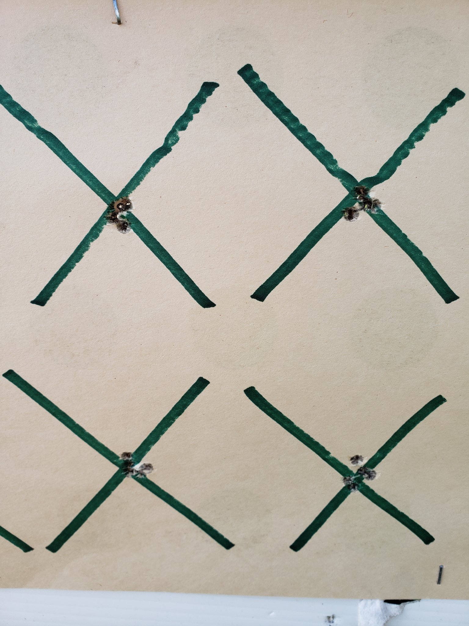

    Top row is full power, bottom row two reduced loads. The weird thing was it seemed like the reduced load rounds were hang firing or something, hard to explain but it recoiled weird for sure. 27gr grouped well under 1/2 moa in the 10-12 mph wind tho. I might try going up a couple of grains and see what happens.
    What was your full power load and what is your powder? I had tried Trailboss like about 8 or so years ago and it had that hangfire feeling also. It really required you to have good follow through or that shoot was screwed up. Then I tried IMR SR4759 and Accurate 5744. I got the best results with 4759 so I stuck with it. It gives more the same pull the trigger and instant bang compared to Trailboss.
    David
    David
    This one was 33gr & 33.5 gr AR Comp/ 105 hybrids. 2950 / 2980 fps respectively. I shot the 33gr load out to 1100 today and it worked great. Not anywhere close to r16 velocity wise, but accuracy at distance is excellent.
