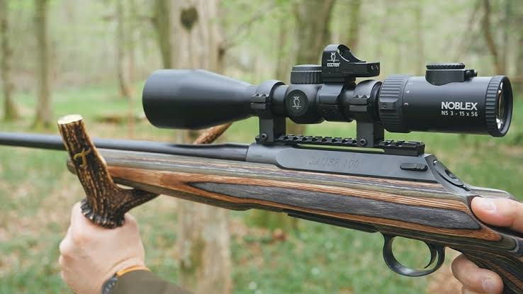

Something like this, only mounted in front of the elevtion turret?

It depends, but start with your scope mount manufacturer and red dot make/model.
-What make/model red dot are you wanting to mount?
-Are you attaching directly to the scope tube or the scope mount?
-What brand scope mount are you using?
-What size scope tube?
-Are you wanting to mount it at the top or the 45 offset of the scope?
Without that info, you can’t really do anything. But google RMR offset scope mounts and browse through the image results. You can then see ideas of how it’s done and decide what will work best for your needs. Then google the manufacturers to see who makes offset mounts for your red dot, scope, and/or scope mount.
