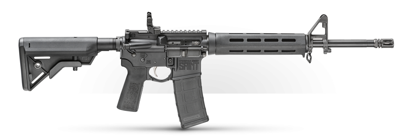

So im relatively new here and new to shooting also. Ignoring basic training 35 years ago and the handful of times ive shot guns with friends since then, my "career" of shooting began about 5-6 weeks ago lol. First I got a 9mm pistol and about 2 weeks ago an AR15. I am about 1800 rds into my shooting career lol
That being said, I am going thru the baby steps that I assume most people go thru as they start to become students of the game. At this point I am just getting into bench shooting with the AR. Yes I know prone is better etc and ill get there eventually but for now lets just make the best of bench shooting.

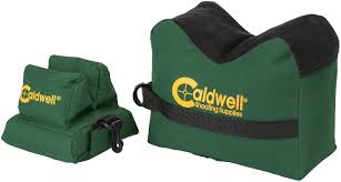

Today will be my first session with my own bags. Very basic Caldwell deadshot bags. What are the basics of the setup? Did I read correctly that its better to start with the rear bag a bit high and then push down into it to make it more solid? (as opposed to continually squeezing and fluffing it up to go higher)
How is one making tiny adjustments using the bag?
How accurate can one be with a basic 16" AR 15, good scope, store bought ammo etc on a 100yd range. Right now even 3 MOA would be a decent achievement. Should I be able to get 1 MOA with a basic setup like I describe?

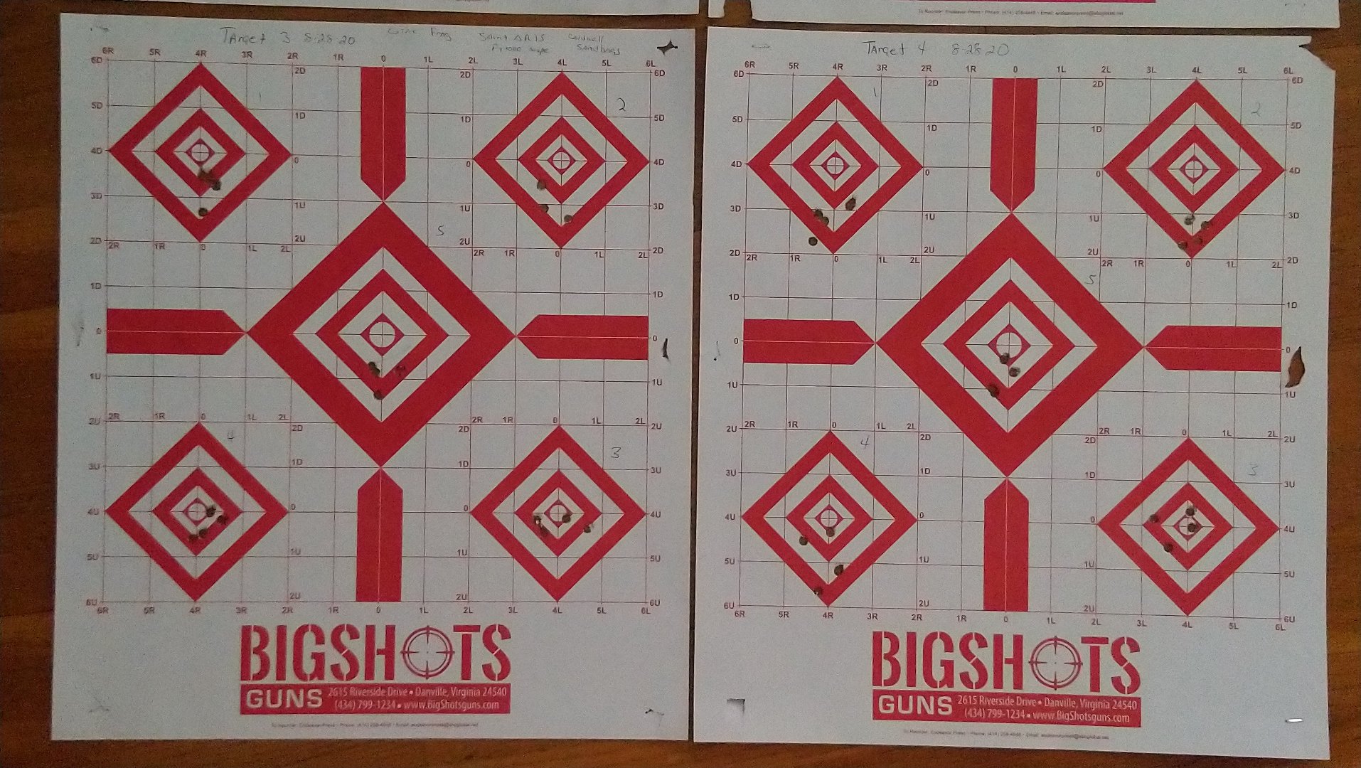

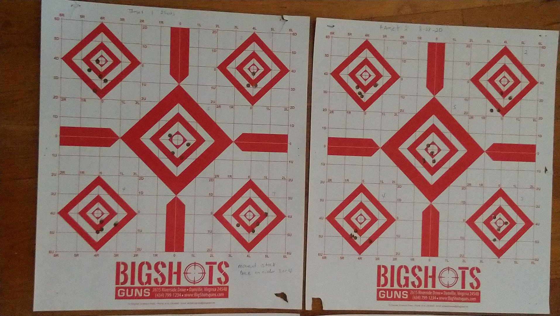

Well I went to the range with high expectations. Ended up shooting about the worst I have so far.
Its hard to understand how, once you've lined up the crosshairs on the same spot 3 times in a row, that you end up with shots being 3-5 inches apart. So much for shooting even one decent group. How does it vary that much shooting OFF OF BAGS??
I understand its a mil spec trigger with probably 8ish lbs of pull, but its hard to believe id be moving the gun THAT effing much.
Using this ammo: https://www.targetsportsusa.com/win...ain-jacketed-frangible-ammunition-p-3624.aspx
I understand it not match grade but is there something in it being frangible that disallows it from shooting decent groups at even 50-100 yds??
The only thing I can throw out for feedback is that the gun really jumped when I fired it. Normally it jumped considerably to the left. As in it would be looking left of target after most shots.
I was attempting to "load" somewhat into the stock etc but obviously it wasnt working. Im full of questions. I dont at all understand how you can even TOUCH the gun without introducing errors. how do you even touch it without putting your heartbeat right up thru it to where u see the scope moving.
I see tons of people on youtube shooting great long range groups while shooting sideways on a bench. Obviously they know something I dont know

todays work. 25 yds. I claim to have the gun "zeroed" at 50 yds. So its not zeroed at 25 and I didnt move the scope or holdover anything. I just aimed center target each time going for a group etc. Not expecting a bullseye per se
25 yds only. I guess Im a 25yd bitch until I deserve to shoot further. It is what it is I guess. When they are consistent dime sized then maybe ill allow myself to move back
Shot standing by leaning over from behind the bench. Decided to shoot 4 rds into each diamond so it would basically be a box of ammo per target. (was going to shoot 5 each but changed my mind. Hence the first 2 diamonds lol)
Worked on pulling gun back into myself and trying to let the gun sit into the so called natural point of aim. Gun didnt jump nearly as much etc.
Still awkward to get set up for the upper diamonds just due to the size of the bags and the shape of the B5 stock etc. The stock doesnt have a nice shallow angle to slide back and forth on.
The "groups", if they can be called that, got better as i went along. Best 2 groups were probably on the last target with the best one probably being the big center one which was the last one of the day. Nice when that happens.
I shot these clockwise starting from upper left and finishing on the center diamond.

Nice to see improvement. Next thing I think will help, invest in some snap caps. Maybe half a dozen. These are dummy rounds that do absolutely nothing function wise in your rifle. The idea is to randomly load them into your magazines, when you try to fire them the gun will just go click. You will have to manually cycle the action to eject them. This will accomplish two things: Primarily, it will improve your trigger control by exposing any flinch or anticipation of recoil you may subconsciously have. Secondarily, it will familiarize yourself with weapon malfunction drills, ie clearing a round that failed to fire or eject. By randomly loading them into your mags, like 2 live rounds then a snap cap, one live round and a snap cap, etc. in different orders in your mags and then randomly selecting a mag so you aren’t ‘gaming’ yourself against expecting a snap cap, you will learn not to anticipate recoil and flinch out when pressing the trigger.

Springfield Saint "B5". 16" barrel. came with A2 front site etc
Nikon FX-1000 scope
Decent enough gun. Ammo might be another story but at this point its sort of up to whats easily available while im learning. I dont really "know" any good shooters others than random people I see at the range lol.
you can see what I mentioned about the angle of the stock being steep. Makes it a bit more challenging IMO to make small adjustments on the rear bag I have. I might need to get a slanted rear bag or some other variety
My plan is to keep working with the AR but eventually I will buy a different rifle more suited to precision/long range shooting. Then the AR will morph into more of a shorter range tactical gun with 15" MLOK handguard, probably a red dot etc
You need a bag that will fill the gap in the triangle but allow you to shoulder it. Just a bigger bag. And a pillow for the front. Unless you have access to a mechanical brace that holds the entire rifle. My range keeps a couple for people to use. Not that great but better than nothing. I prefer pillows or a backpack if I don't have a front bipod. The A frame of the stock doesn't lend itself to a small bag and the 30 round mag makes for everything to be taller. Do you at least have a smaller 10 round mag? I skimmed the replies but didn't see.
Also, I know very little about that rifle. What's the twist rate? Is it a mid length chrome lined? Cold Hammer Forged or button? I assume it's a 16" 1:8 twist chrome lined button barrel. Not the most accurate. A fine battle/SD rifle, maybe not a "marksman's" rifle. So your expectations may be greater than the mechanical possibilities.
Not to fret though. Just gonna have to buy a new Designated Marksmen Rifle (DMR here on the hide ;) ) and move The Saint to three gun duty.:geek:
But really. Find some nice ammo and try that with a proper bag setup that will allow you to naturally aim the rifle and shoot some groups. You and rifle will get better. Take a class but be careful who's teaching. Run a match that suits you. Beginners and newcomers have always been welcomed in my circles and usually you'll get some decent pointers and most will insist on trying some of their equipment. Find one, sign up and just show up and be ready to be humble and ask a couple questions. In the mean time maybe you can find someone to shoot your rifle for a second opinion.

So I followed the easily clickable link you provided in your post to the specs on your rifle. Good news. Your barrel is melonite. While there's much debate on it's wear abilities, I think most agree it's more 'accurate' than a chrome lined barrel due to a thinner coating which in turn gives a better bullet to rifling/lands interface.

I have the Caldwell Deadshot bags. The design of the rear one doesnt work so well with the B5 stock. I think I need some smaller bags or some such etc to stack to use with these bags for more flexibility

Get a bipod and a good rear bag. Dry fire for a few weeks without firing a single round. You need to learn to stay present through the whole trigger pull. You are jerking/flinching when you pull the trigger and you can’t see it when you are firing live rounds.

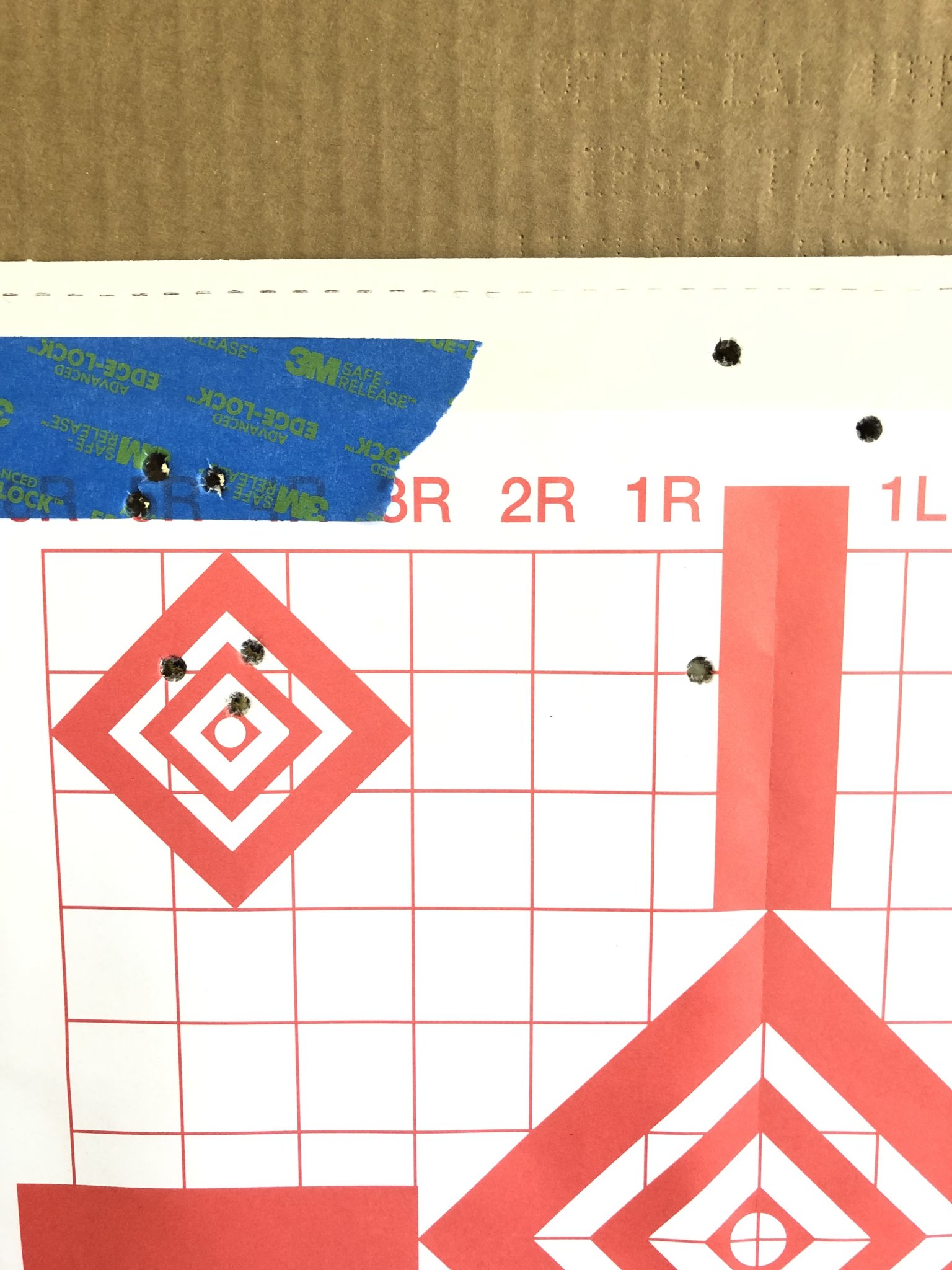

I think some guys don't realize the difference ammo can make even out of the same gun. Below is two different loads shot at 100yds out of my $400 AR Barrel. This was about 3 years ago when I was even less experienced of a shooter and it was a big lesson I learned reloading for my rifle.
The group on the right is bulk, cheap, mixed brass, thrown together ammo... (much like your frangible stuff). The other two groups are quality bullets, measured powder in quality brass. 0.6moa vs 2+ moa from the same match grade barrel
