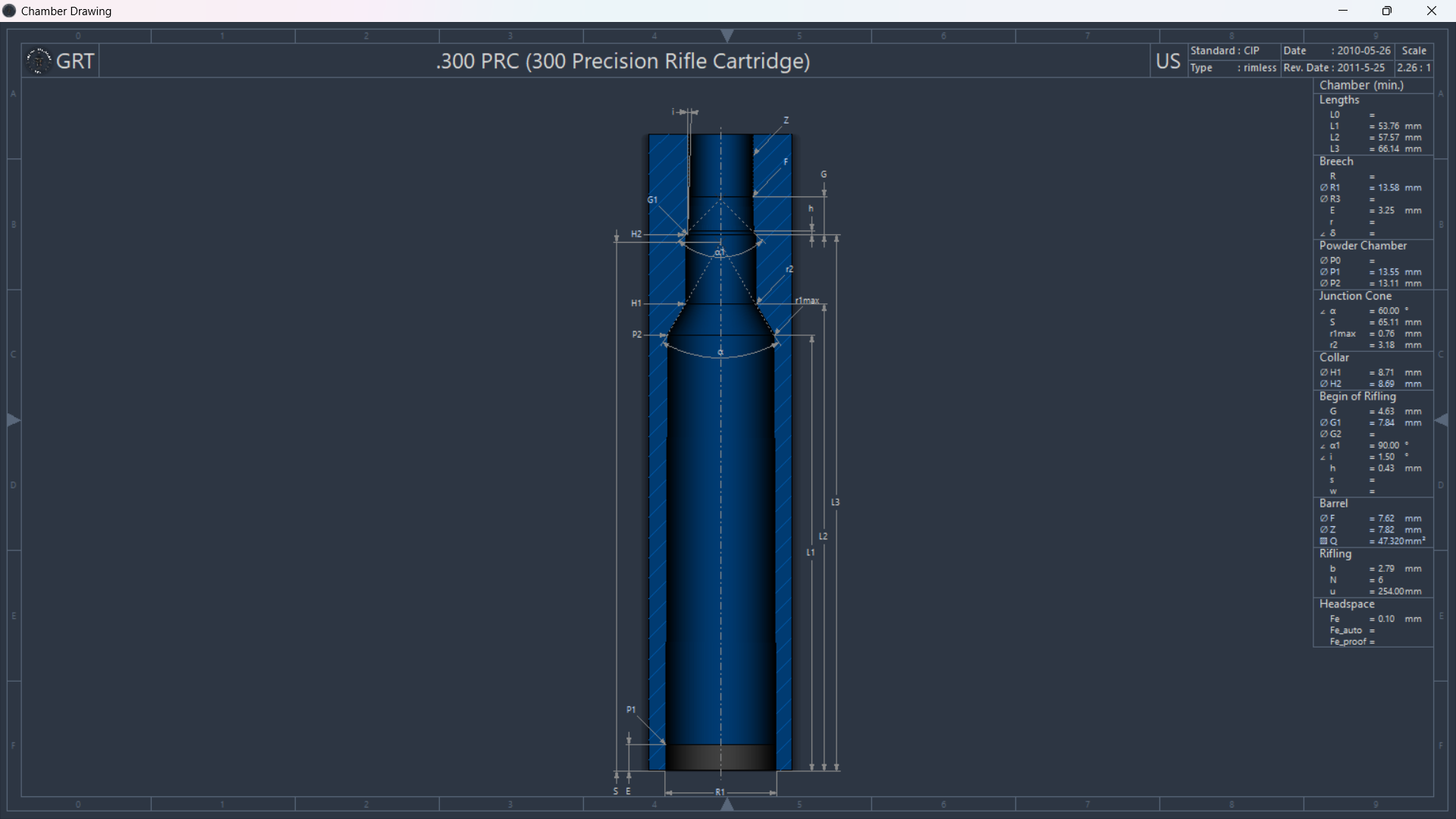

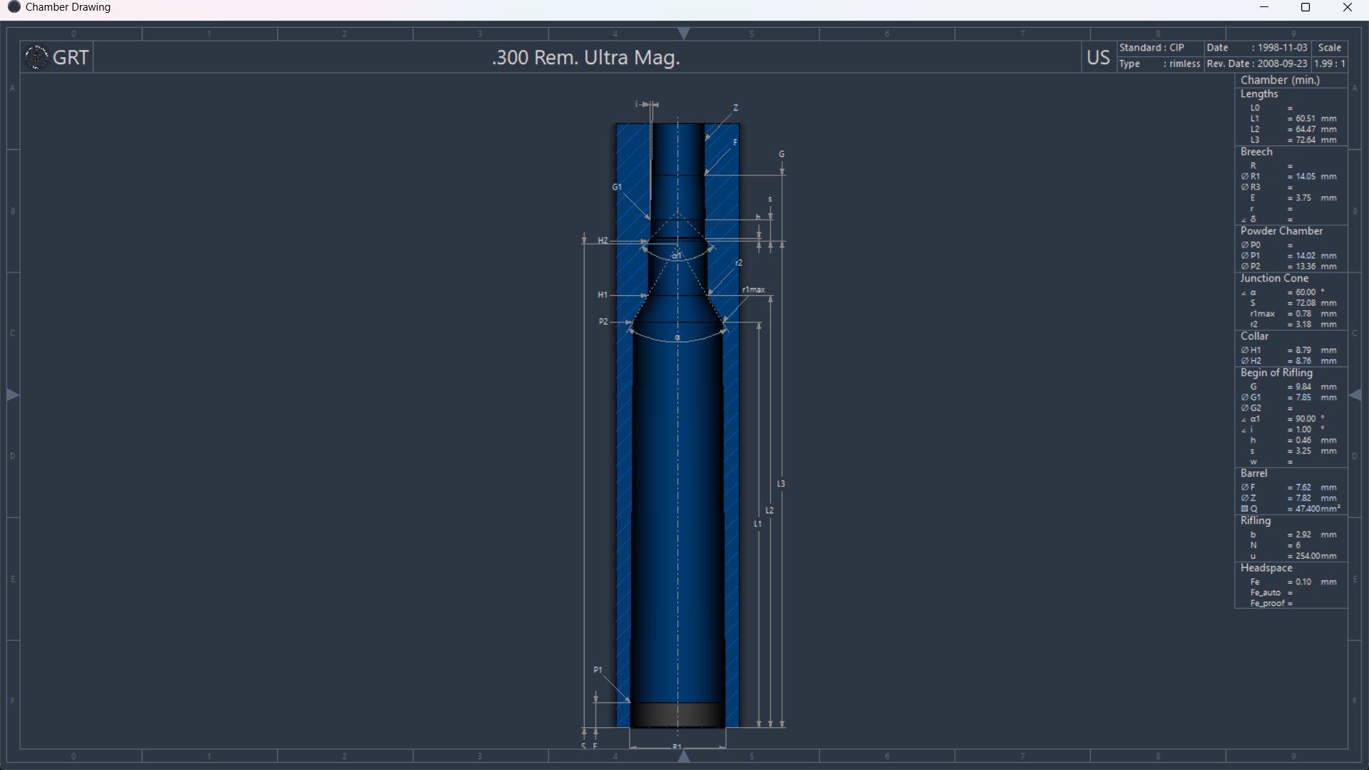

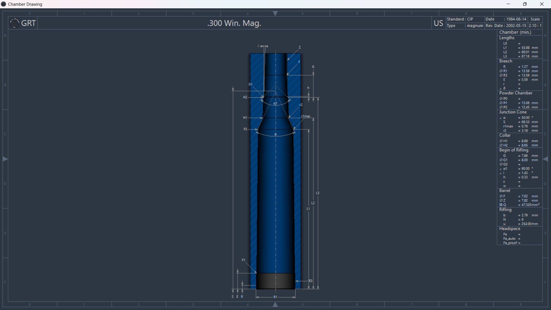

Here are some interesting chamber drawings. Take particular note of G, G1, H1, H2.
The 300PRC has a much shorter leed & reduced H1 & H2 diameters in comparison to the other two chambers.
I think there are 3 possible scenarios.
1) The case is full to a crush seating with minimal neck tension & the projectiles are backing out with recoil from an already minimum distance to jam & a slight carbon ring forming at the jam point with the projectiles moved slightly forward of the COAL.
2) There is no projectile movement during recoil & the projectiles are seated out too far to avoid the slight carbon accumulation.
3) The chamber has been reamed with a worn reamer & the leed is tighter than spec, causing exaggeration of a slight

Don't even compare it to the 300wm saami spec. That throat design is horrible from an accuracy point of view. It's cone shaped and starts out at a .315" diameter at the case mouth. That's .007" bigger than bullet diameter for the most part.
The 300RUM is +.0003" bigger on the freebore diameter but it has about a .125" shorter length in the throat than a saami min spec. 300PRC.
My .02.... the guy needs a copy of the print of the reamer that was used. Start there. Then it should be looked at/measured and see if the reamer cut the throat undersize. My last attachment is a reference with some bullets and approx where they should touch the rifling. If a sample round of his and the bullets listed are say with in .010" or so of my reference numbers... than I'll say the reamer cut to spec.... but if they are much more shorter than that.... then I'll say the reamer didn't cut to spec.
Again the reamer could be worn and not cutting to spec. or.... I've seen brand new reamers not cut to spec.
Unless the OP gives us more information.... again we are guessing.
