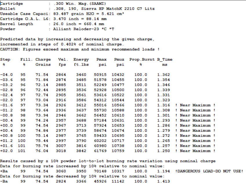

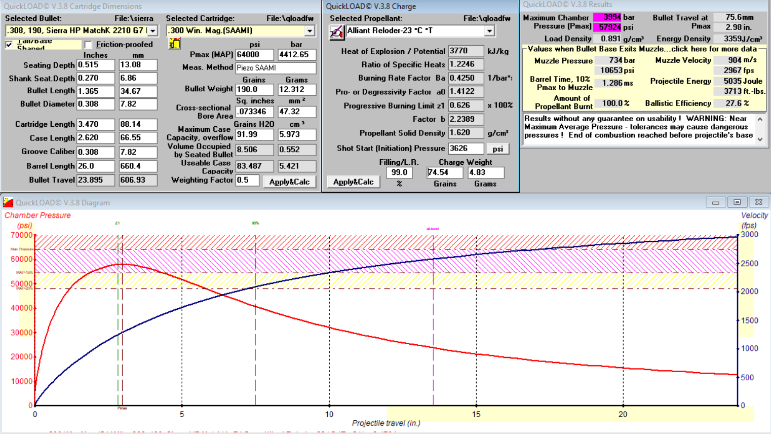

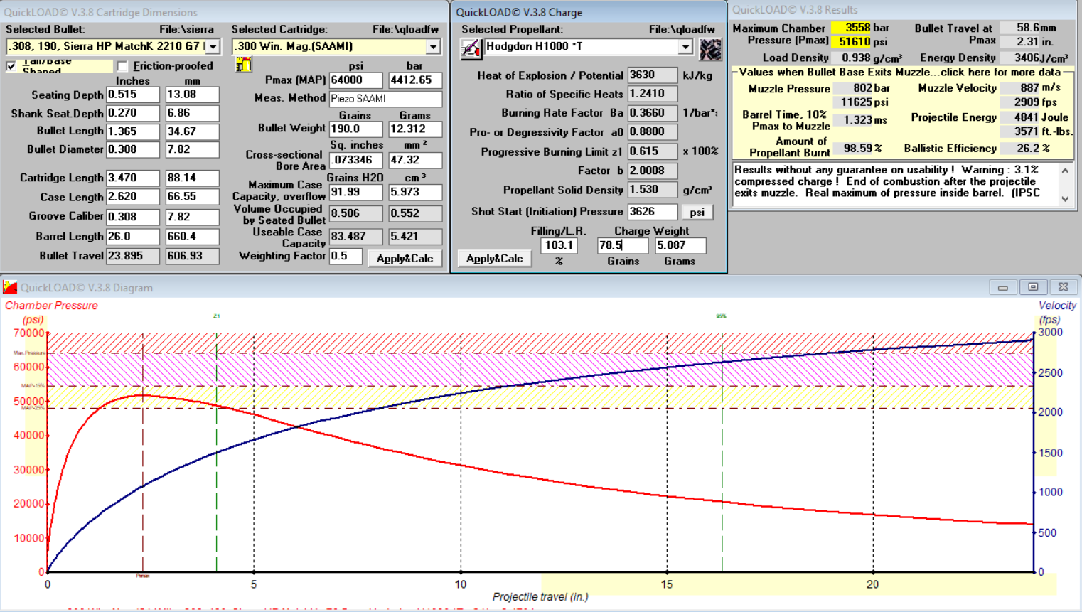

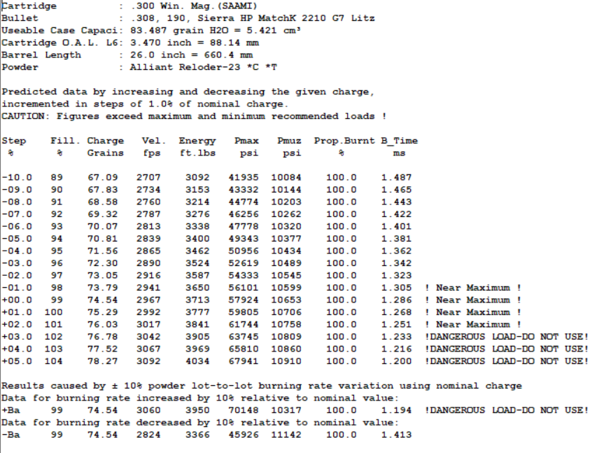

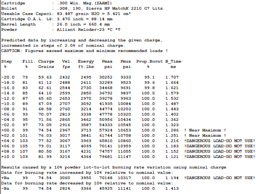

Here's your current H1000 load
And here's an RL23 load
And here are some charge weight variation predictions
And this is what Alliant suggests
So bottom line: RL23 is probably a good choice in your case.
Edit: replaced charge variants with smaller increments

@Dogtown That's a lot of data. Thanks for the research. That's a pretty good schedule to start working on. It is a faster powder than H1000 and seems to hit higher pressures pretty early. It makes me wonder about that 75.5 max load Alliant published.
Take it for what it is: an estimation. None of those numbers are hard facts in anyone's rifle; Quickload is just a huge timesaving guide. As for published load data, they tend to be on the conservative side for a variety of understandable reasons.
