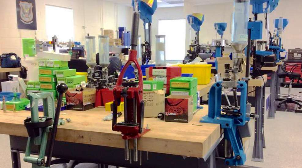

Here is a picture of the .mil reloading room for the AMU. The blue presses are dillon/turrets. The single stage presses are ±$350 forster co-ax. and $200-ish RCBS rock chucker. Along with some stacked boxes of dies (redding). This is all solid, proven, mainstream gear.
Yeah, I have a Forster CoAx, but I've never used it; I was planning on starting with that unless I found something better in my research. I thought with my inexperience I would be better individually weighing every powder load on my scale versus trying to use a turret without understanding fundamentals, but as I said, not settled on anything and if it's smarter to just go turret to begin with, I may switch to that. The nice thing about having zero skills is having no bad habits, yet, and that either way I have to learn whatever device I use, so I don't want to become an expert on one thing when it would be smarter to just start on something else, since I have zero experience with either.
