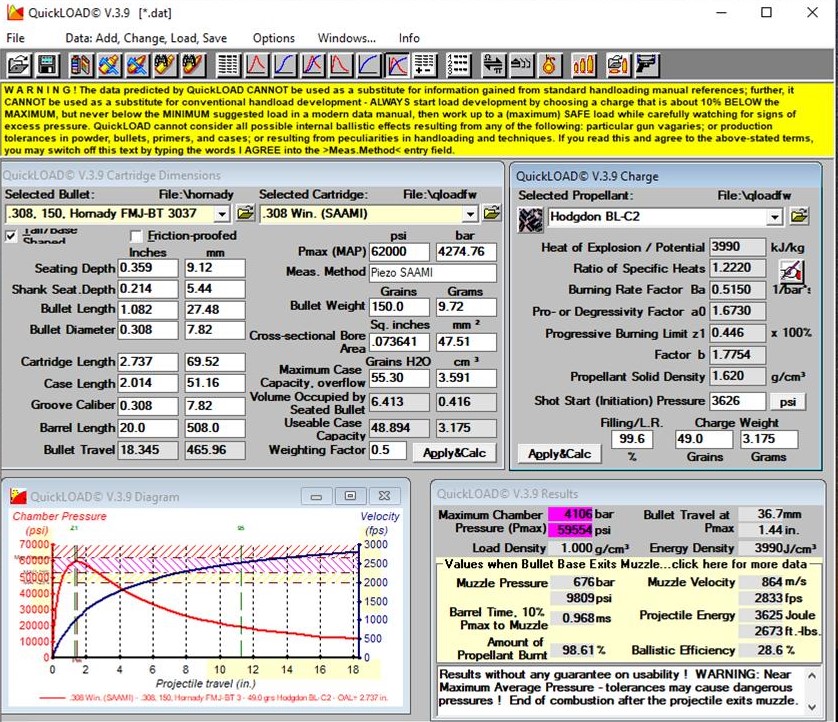

.003 neck tension works fine, but .002 (~ .06mm) is better and is typically what's recommended for bolt guns (though, one can go even less with a bolt gun).
From what I can tell, even 47 grs is going to be plenty safe at that COAL. One can probably go a little more than 49 at the higher pressure range and still be safe and if you take a close look at the pic below (note the pressure highlighted in purple as opposed to the Pmax) you can see what I'm looking at that helps lead me to that conclusion:
That's an awesome and useful picture and data! For the neck tension, I can definitely aim for .002 for my next reloads. I'll also try to go up to the higher ranges like you said, incrementing slowly, since it should be safe.
