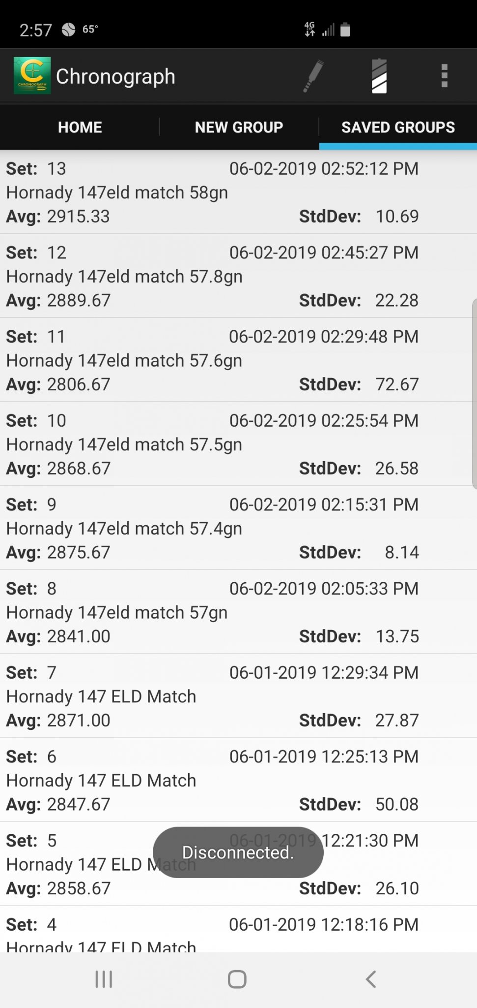

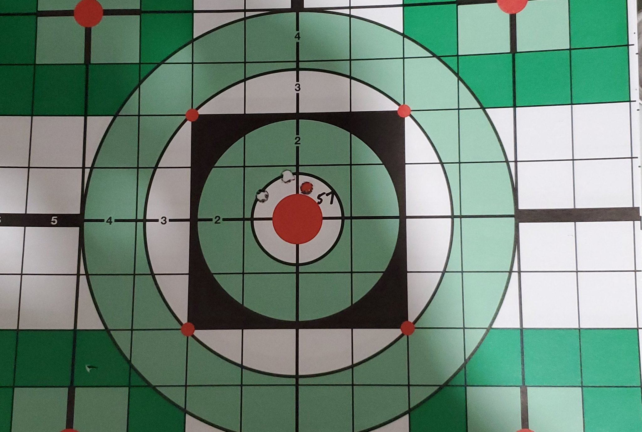

I am reloading for 6.5 prc and having good luck with using H1000, and I know about RL 26. Which powder is more stable and consistant? Is it possible to test different powders like hodgdon superperformance hornady or H4381sc. I am new to reloading and want to shoot competition someday and don't want to blow off my face doing it. I want to learn what I am doing not just someone telling me what to do. I appreciate any feed back. Here's some pictures, am I the write track?

those group sizes and point of impact (if you drew center of three shots) is all over the place. what distance was that target at?
57.4 looks good but 57.3 and 57.5 aren’t similar, you def want more forgiveness than that in a load, or it implies 57.4 was just a lucky fluke.

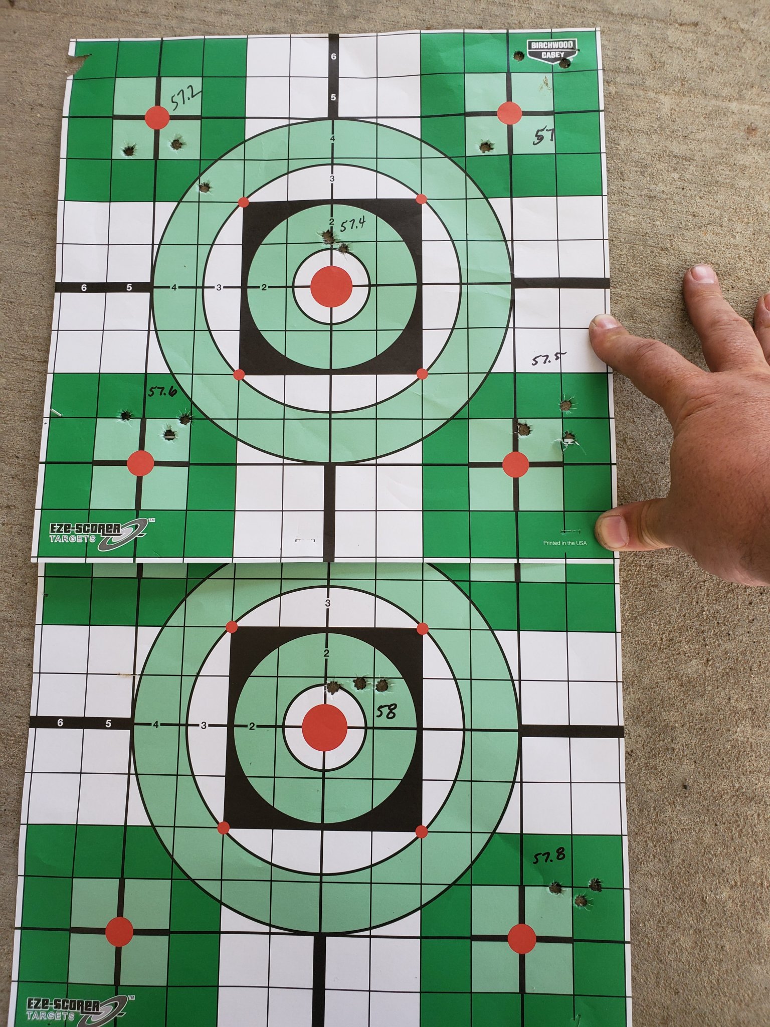

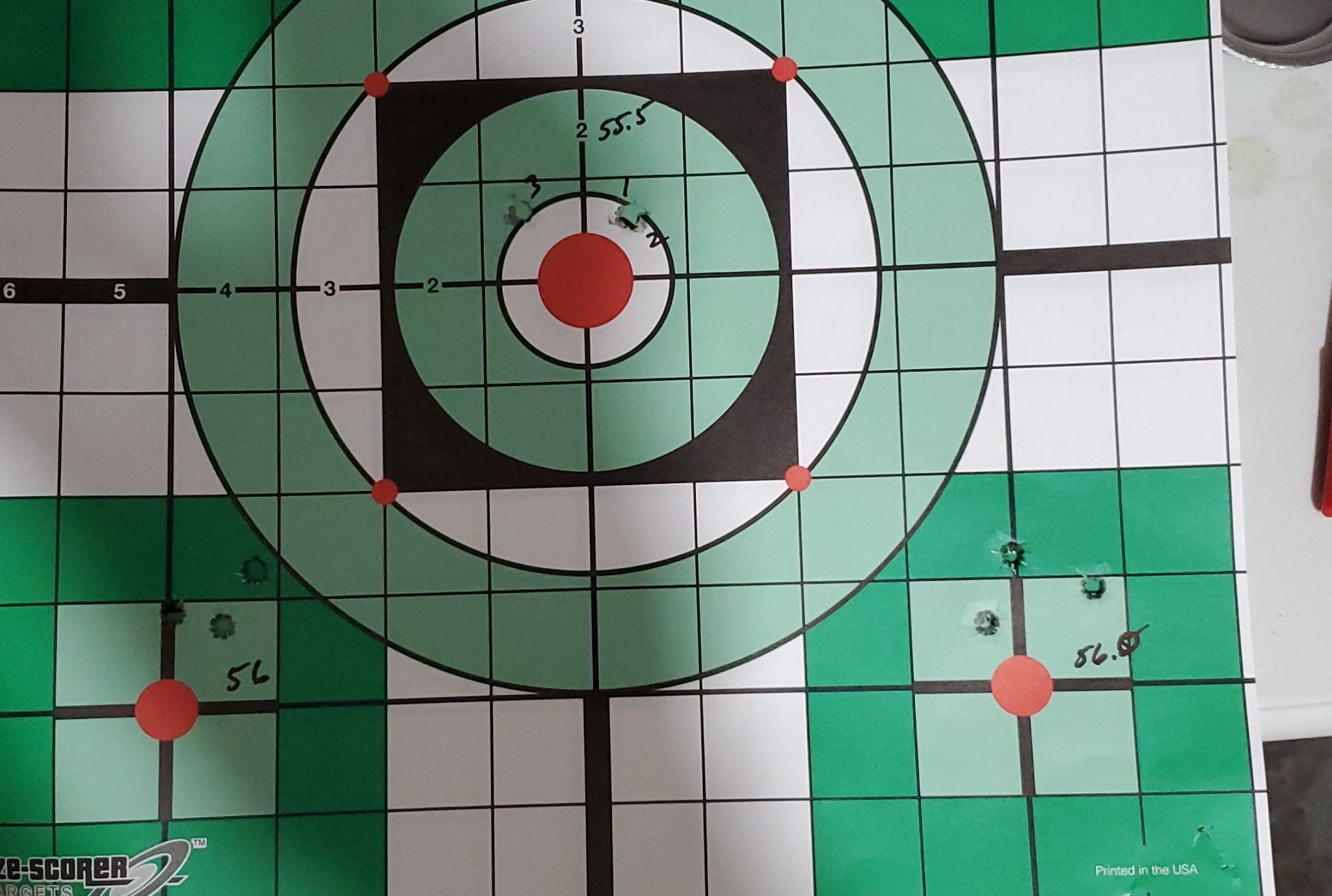

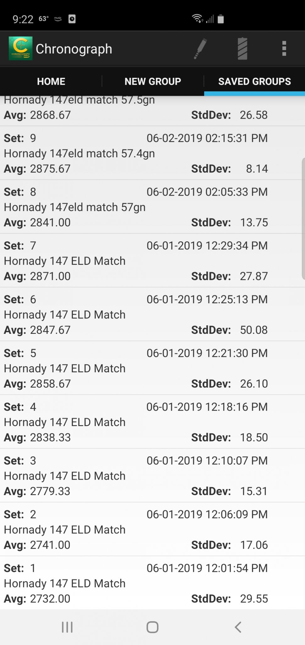

I am shooting 100 yards. Here's some pictures of where I started with powder 54grains and went up .5 grains. 1thru7 on the chronograph picture. I will look into the other powder., I should say this barrel is new and there has only been 60 rounds total through it. Does this have anything to do with it? Thanks for your help

If I were you I would double check scope is torqued, action screws, etc before thinking about a powder change. When groups change that much (as high as 2 MOA down to .5) with minor changes in a powder (.2 or less) that usually means something else isn't right. Not for certain, but double check all that first before you start chasing the load more
