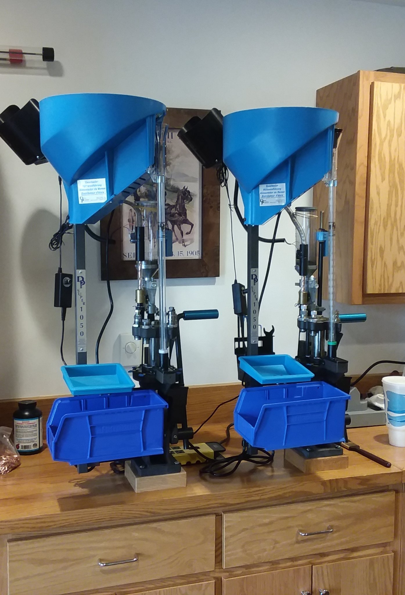

Did someone say Dillon?

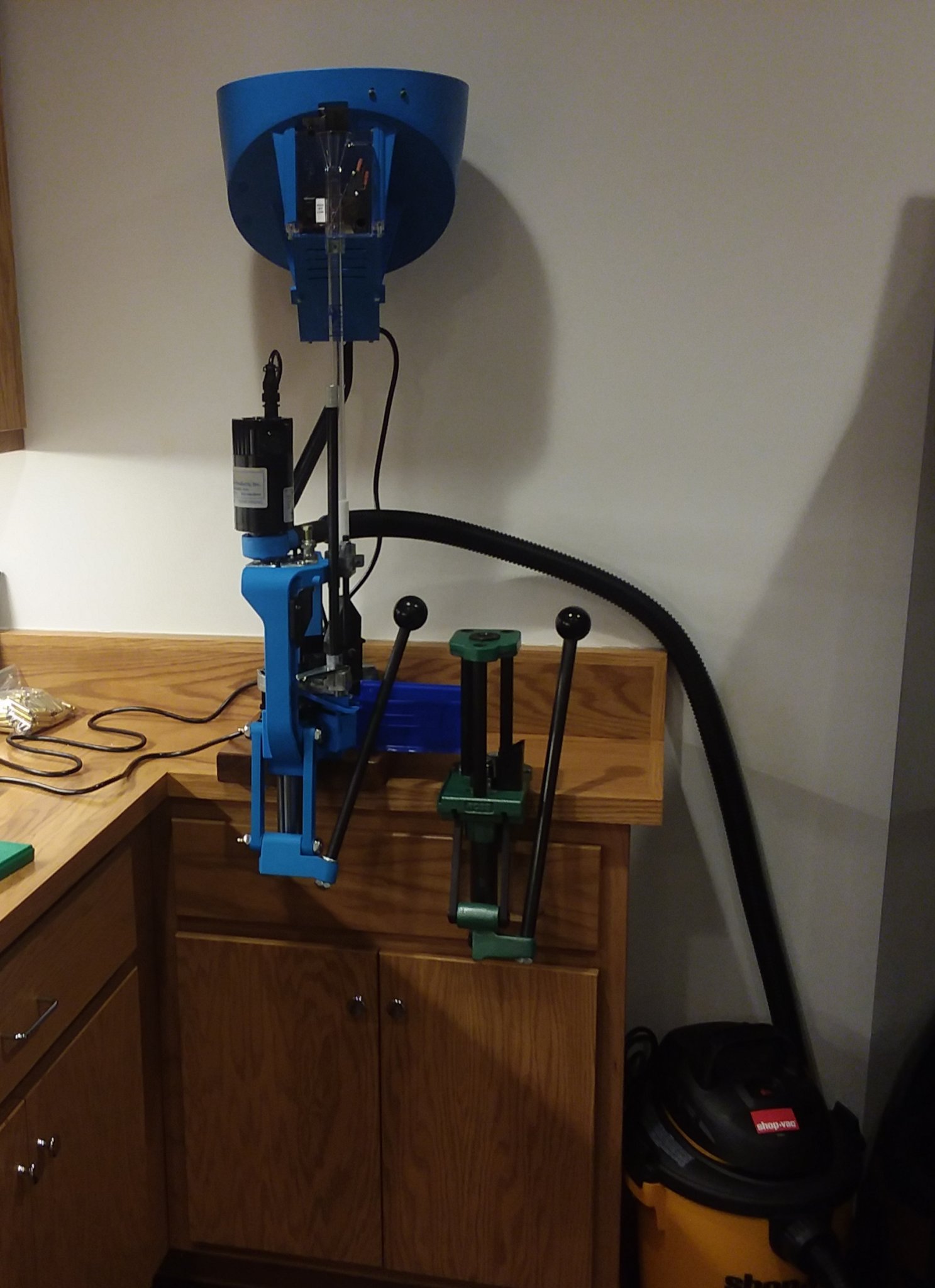

Cool gear....how many rounds of 9mm would you have to load to cover that investment from the few pennies you would save rolling your own?
Dunno...never thought about tbho.
Never really considered it an investment either really I guess.... I just shoot alot.
??. Some time way back I lost the feeling for factory stuff I guess and these guys just help keep em coming.
Lol you think we load just 9mm? I'm about to sling a couple thousand 223 and 6.5 Creed tonight with about 500 300wm as a chaser.
Common Mr kak and lmt ar guy what's money to you?
