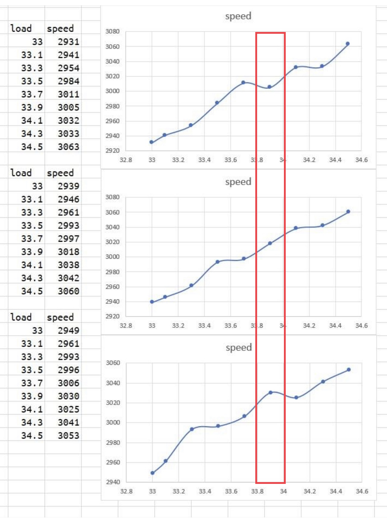

Do your velocity flat spot test 10 times. See if the flat spots stays the same. Think about the logic behind this. You’re adding powder, but velocity (and pressure) doesn’t increase? Explain how that works unless you’re at the point where you can’t get anymore velocity (and then you’ll be at a higher than safe/functional pressure).

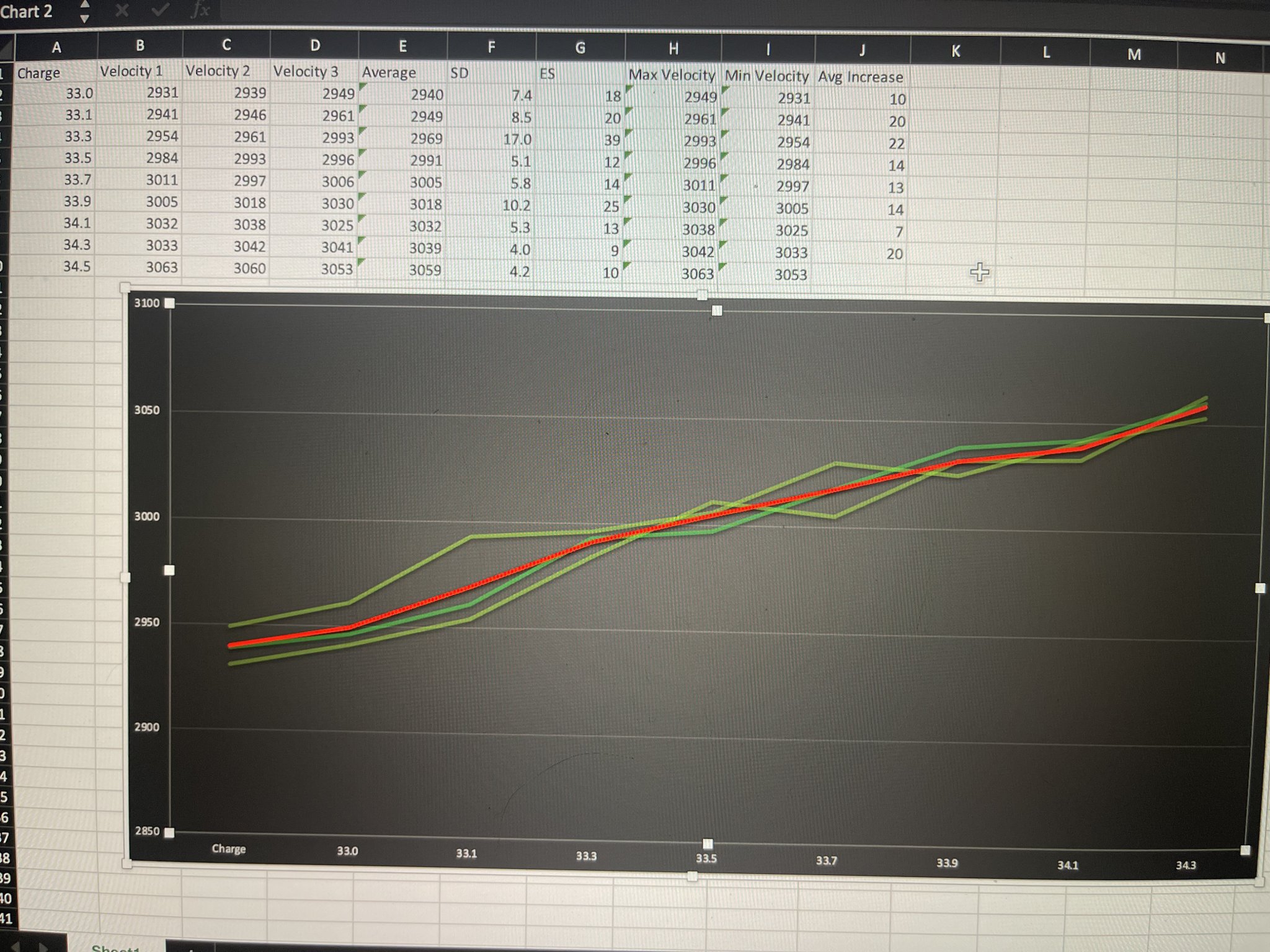

Here’s an example of three different 10 shot velocity ladders on the same rifle. Depending which order you shot them in, you would see two “flat” spots. But, if you keep shooting the test, all of a sudden the flat spot is gone.
And then there’s a graph with all three combined, when you take the average velocity of this 3 shots each, all of a sudden (see the red line) there are no flat spots and velocity increases with every change in powder charge (which is what really happens).
Chrono tests that identify “flat spots” are nothing more than a product of Extreme Spread overlapping and statistical variance. When you shoot enough shots to be statistically significant, they don’t exist.
