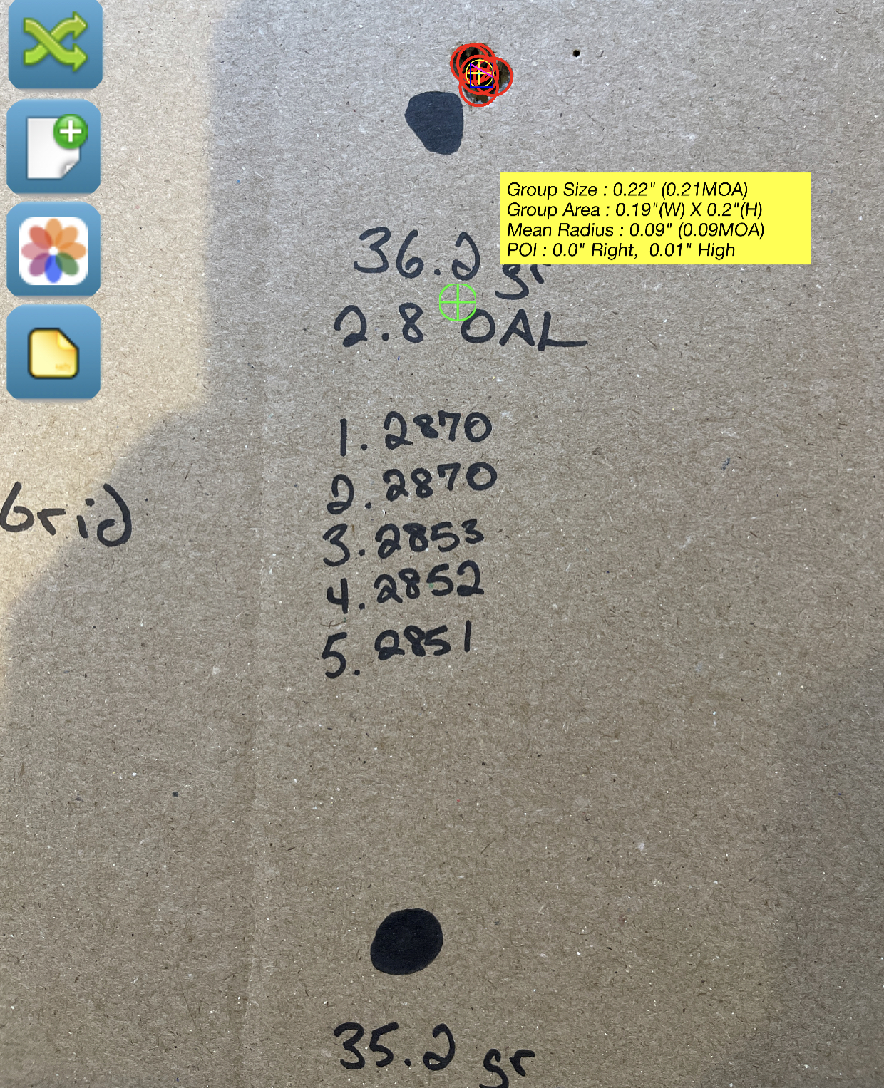

after working up a median round of info I scavenged from the internet and some test shots, I found a round it likes.
130 Gr. Berger Hybrid
36.2 Grains of Varget
CCI 450s
Once fired from this rifle Lapua brass
2.8 OAL
2860 FPS average with an extreme spread of 19
