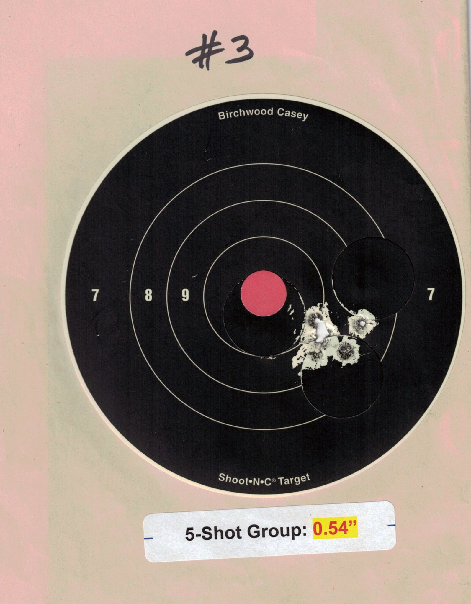

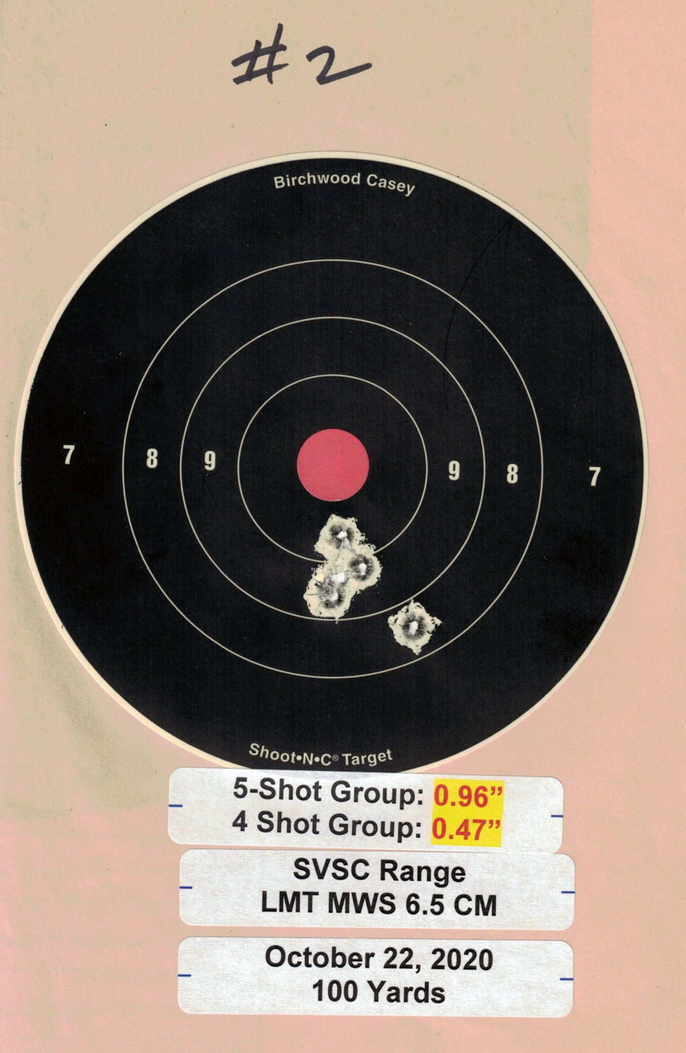

I went back and searched my computer for any notes or photos from my two visits to the range in 2020 with the 6.5 Creedmoor LMT MWS. I found photos of the cases that were badly beaten up on the first visit. I don’t have photos from the second visit, but things improved with the BRT gas tube installation. I had also planned to remove one coil from each ejector spring, but had not done it. It was also suggested to me to break the sharp points on the barrel extension inner lugs, but I decided I was not qualified to do that.
Below are two photos of targets from after I installed the BRT gas tube. This was a significant improvement from the previous shoot.

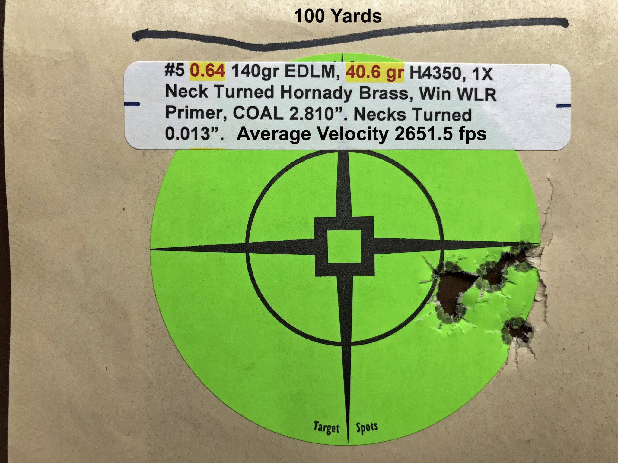

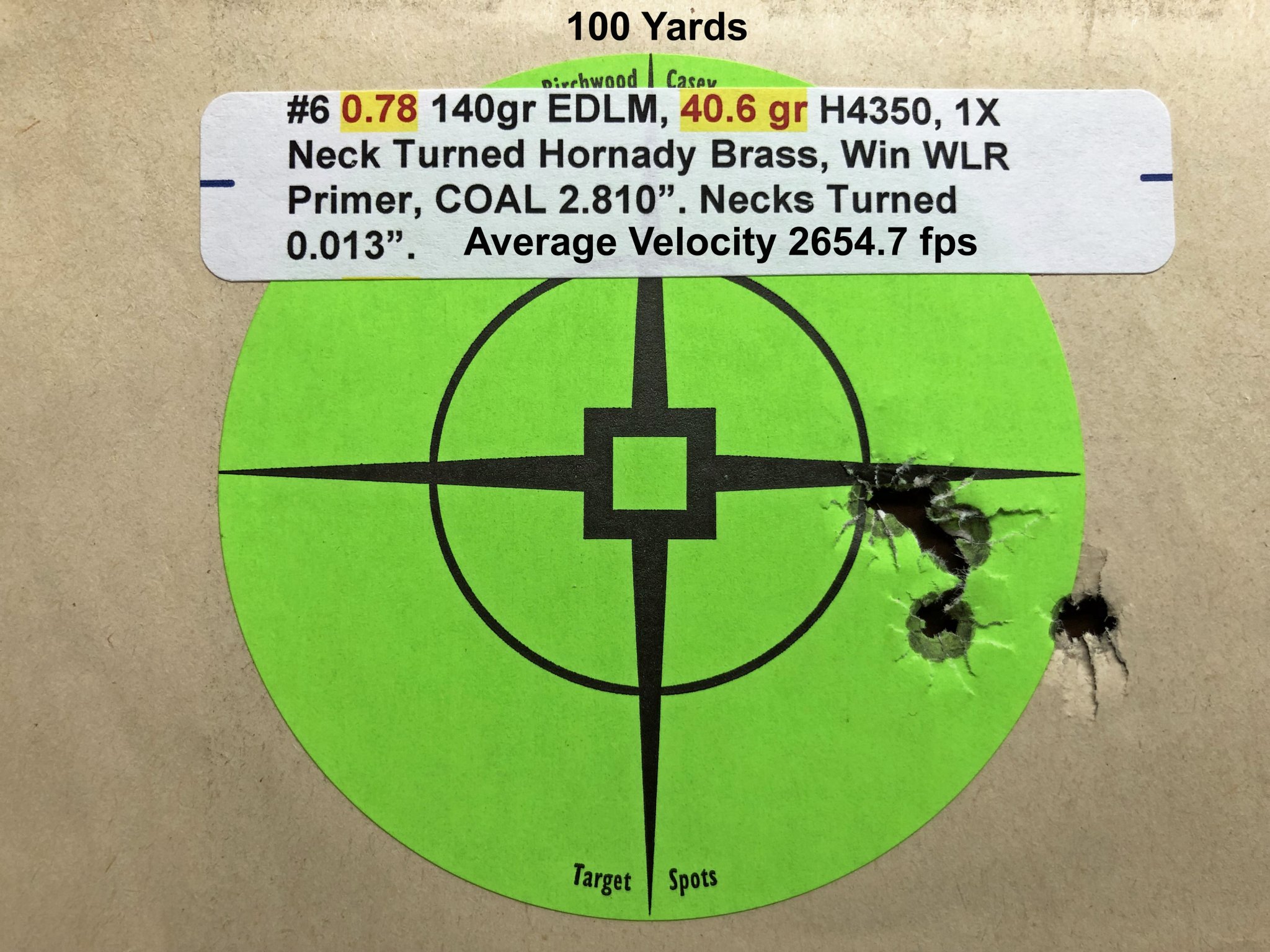

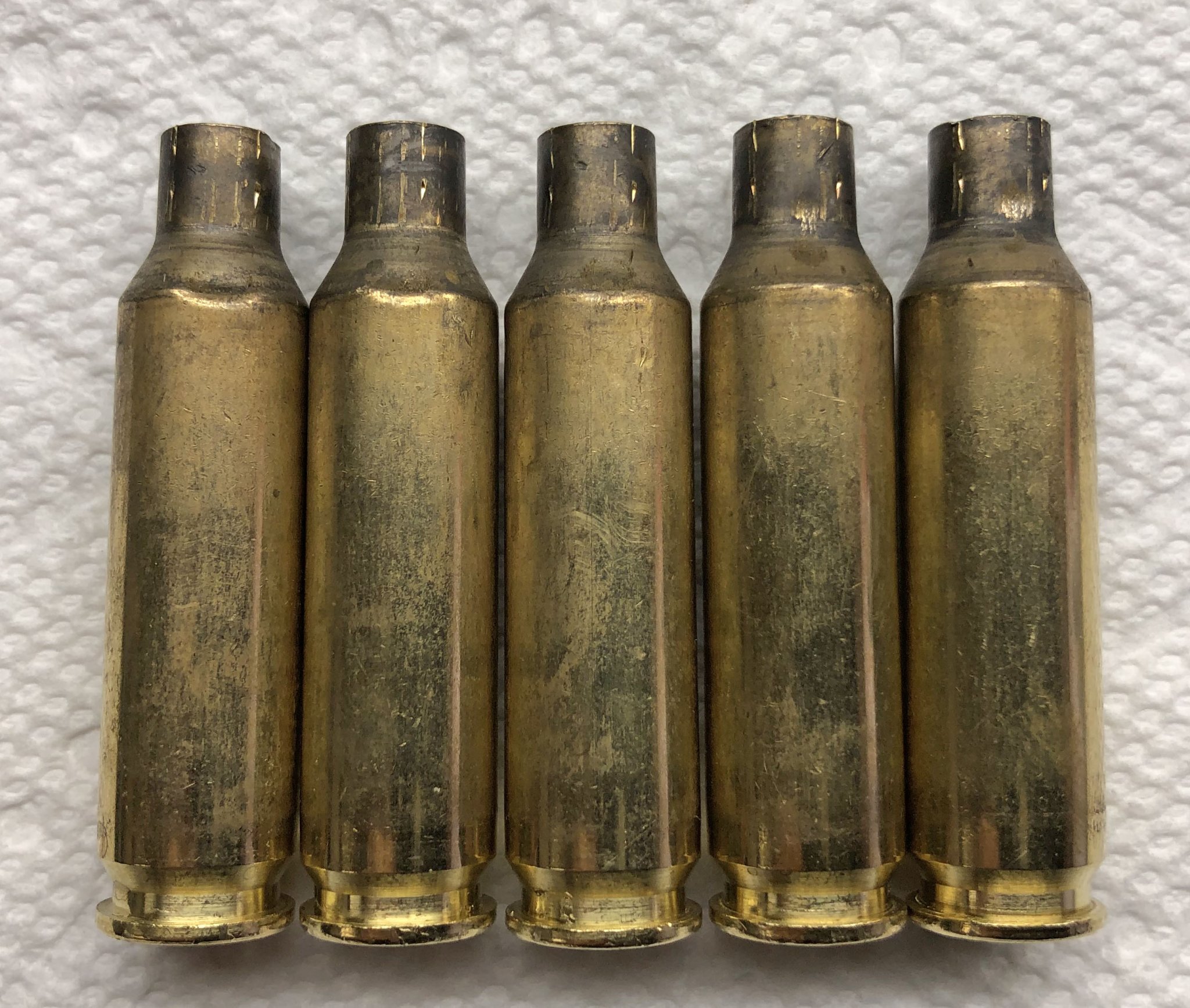

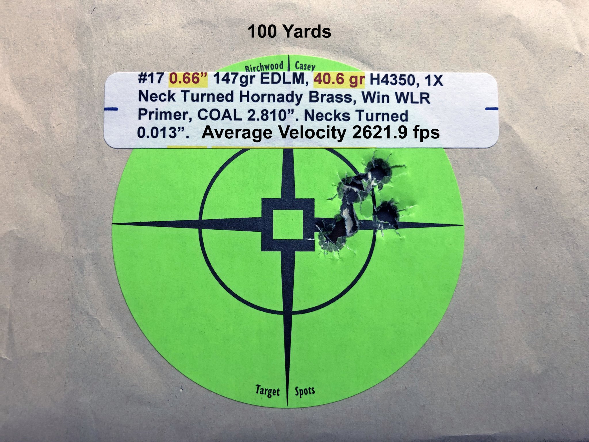

I made it up to our rifle range on New Year’s Eve and recorded good results for the 6.5 Creedmoor reloads with 140 gr and 147 gr Hornady EDLM bullets. The ejected brass looked fine except for the slight denting on some of the necks which is normal for an AR. I did not see any pressure signs with any of the 140 gr EDLM loads and some slight pressure signs with the max 147 gr EDLM loads.
I measured all my fired cases with a Whidden headspace gauge and all measured +4.5 (0.0045”), except for the 147 gr EDLM with 41.2 gr of H4350. That was a max load and it measured +5 (0.005”).
My Winchester WLR primers are 35 years old and they have performed fine with my 308 loads and I did not experience any issues with the 6.5 Creedmoor loads. I have a few targets where I have a nice 4 shot group, but the fifth shot opens it up. Not sure if this was my shooting or some other factor is in play. I will repeat these loads the next time I go to the range and fire more five shot groups to obtain a larger sample.
I have not shot any of my loads with the new Lapua Small Rifle Primer Pocket brass. They are already loaded, but someone here mentioned I should reduce the loads by 1 grain.
