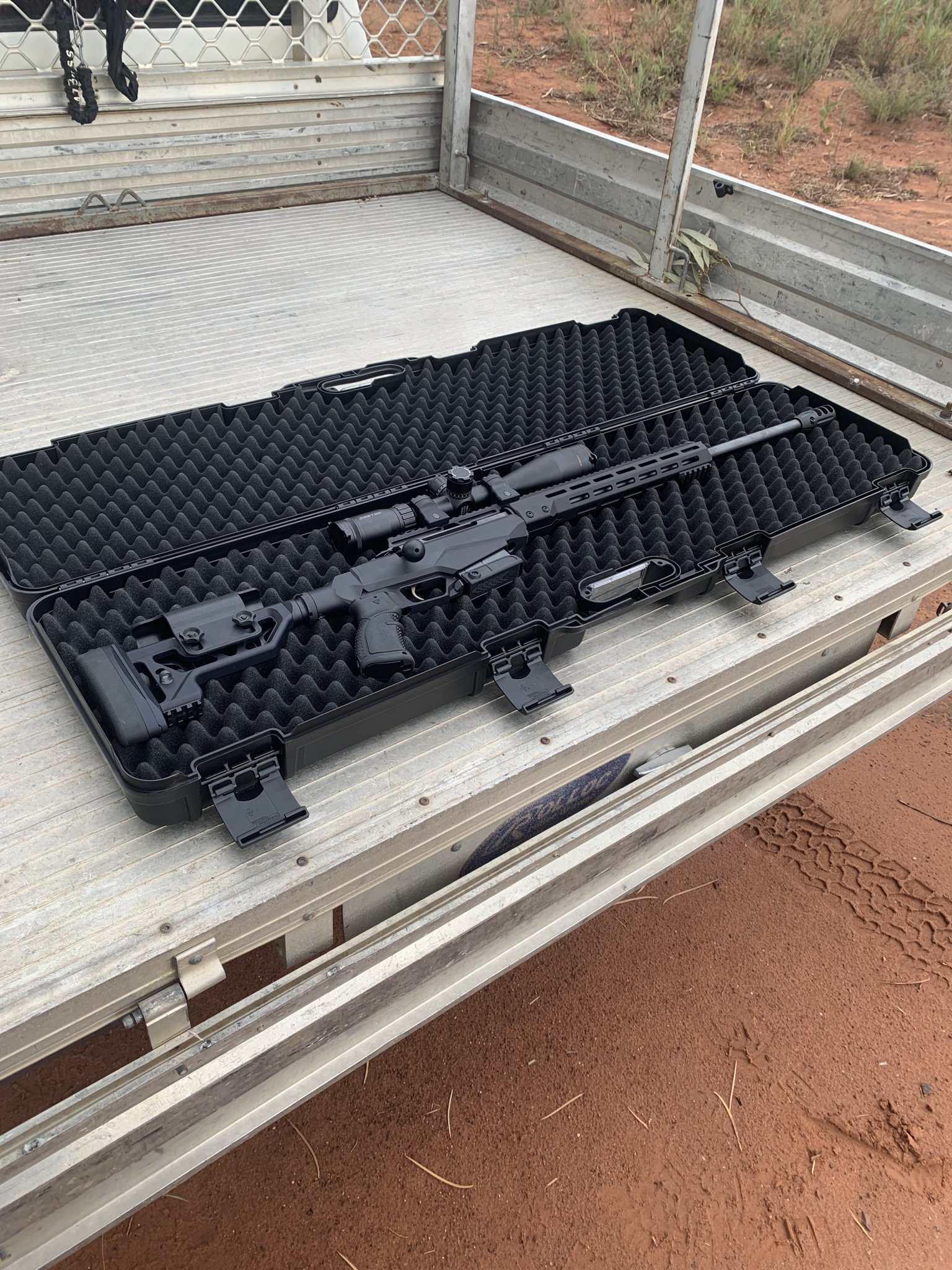

Hi guys I’m looking at starting hand loads for benchrest. I’ve played around abit with my .223 and hand loads. But starting on my new Tikka T3X Tac a1 in .308.
I’ve found ADI 135gr match shoot well.
Looking at getting into long range precision… f class etc. what’s everyone running? Any tips would be much appreciated! Thanks
