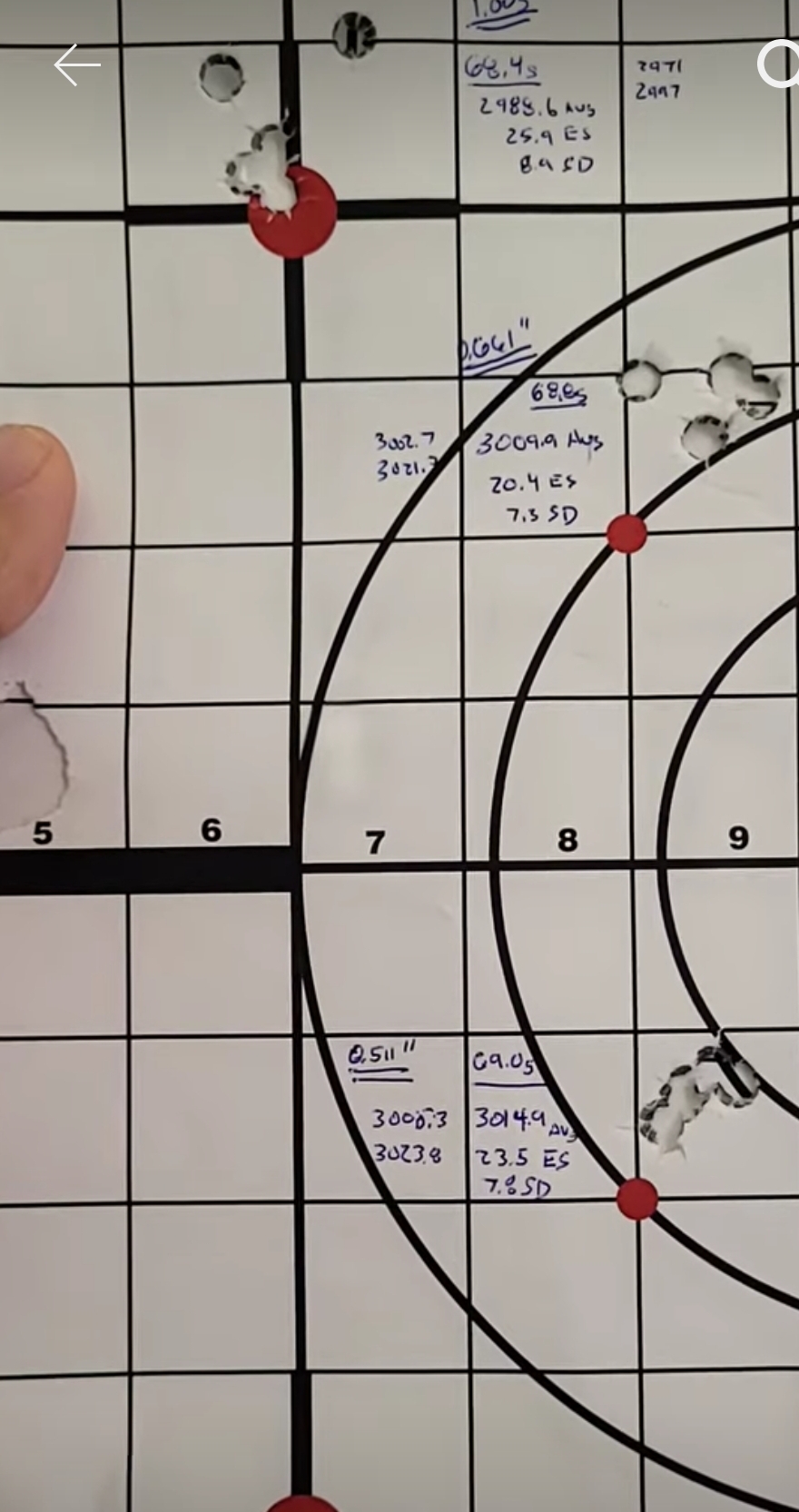

26 " 7prc Christensen MPR carbon barrel. 180 eldm, New not sized ADG brass, Retumbo 69.0 grain (mid 90s temp), BR2, 13ths of lands. 3,014 fps.

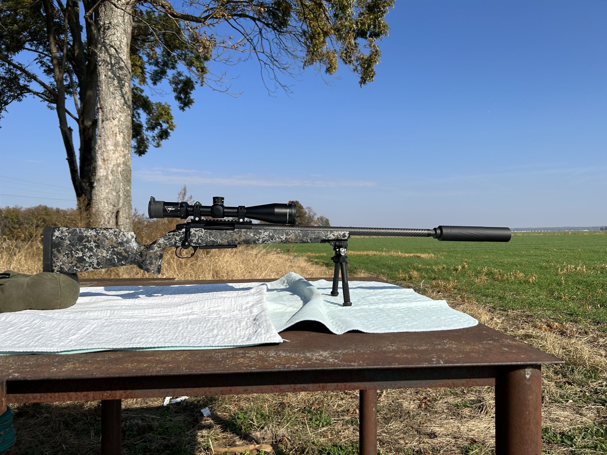

TS customs ks1 they are my favorite hunting stocks
That’s what I drug home from the store yesterday that shot that factory ammo so good. I don’t even have the barrel broken yet. It’s already throwing .3 MOA groups at 200. I’d like to say it was my handloads, but it wasn’t it was factory ammo how embarrassing. Verdict is still out on that stock. It’s OK I guess I don’t like the color.
