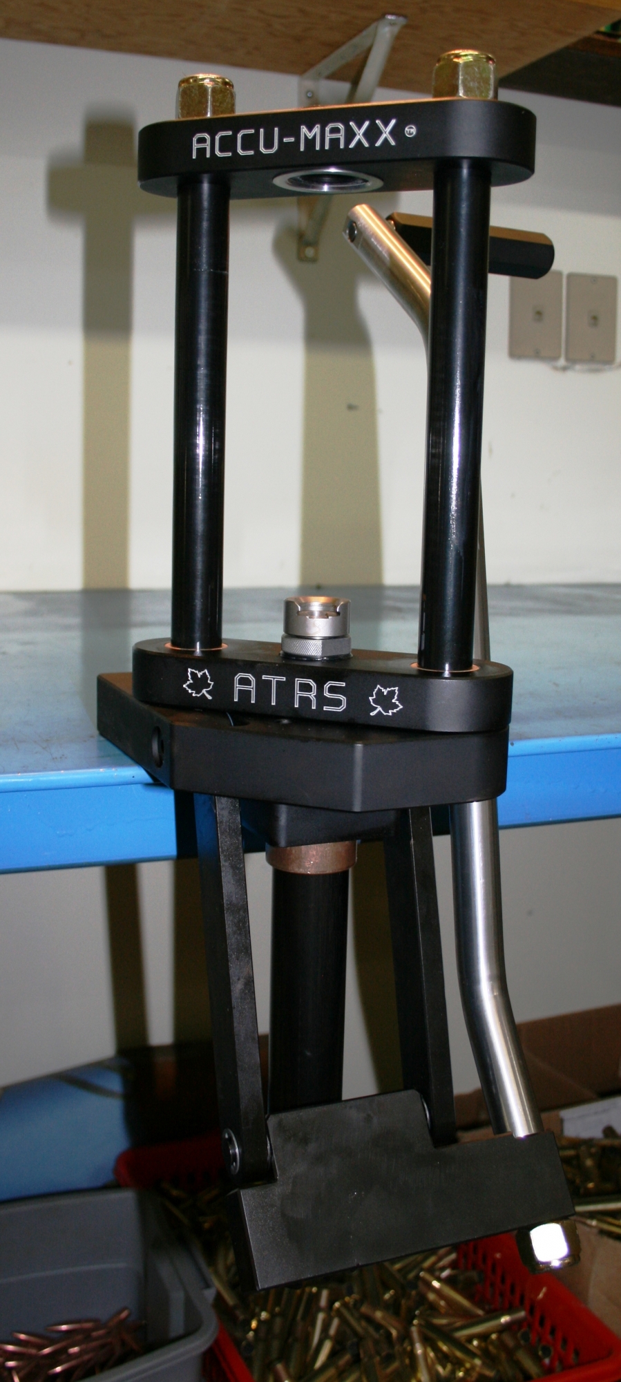

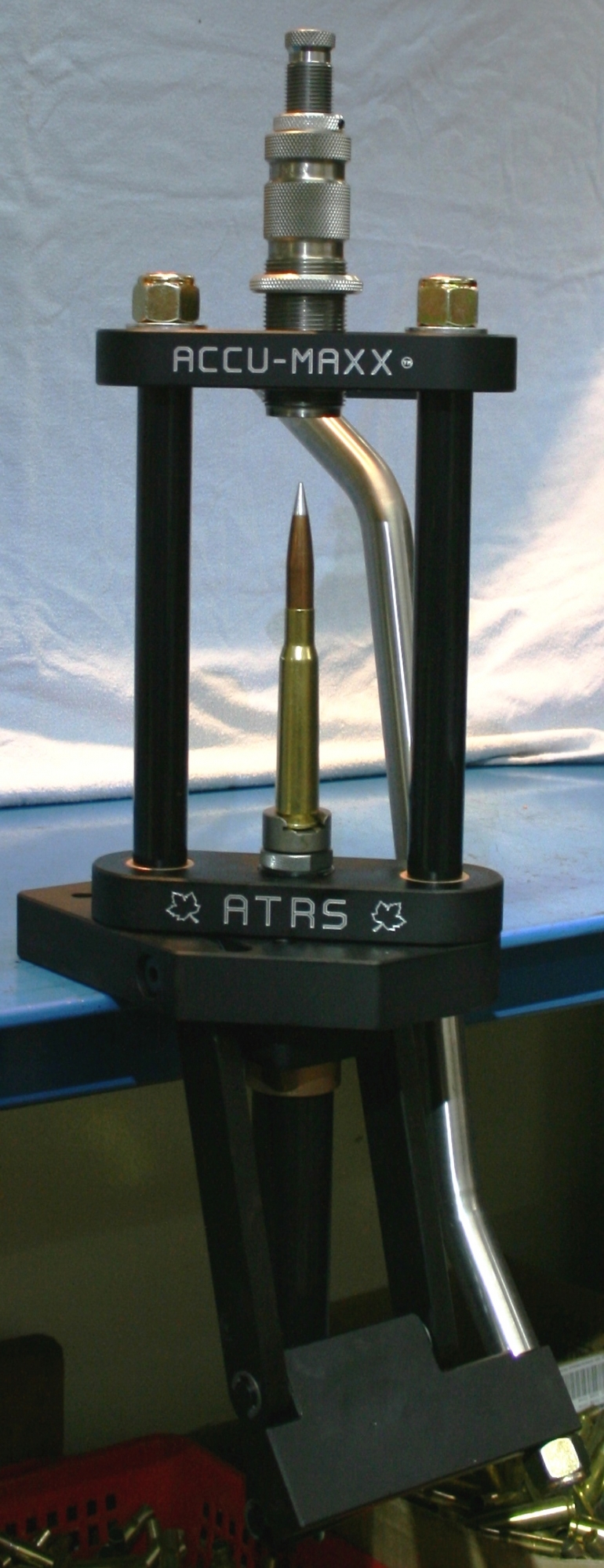

What type of press and dies do you recommend? What are good sources for LC brass? and i plan on "plinking" with ball ammo. Not starting Forrest fires.
I bought an accumaxx and am thoroughly impressed with it! I can load standard 7/8 dies and also quickly adapt it to load my 50bmg. Sooo smooth and builds great ammo.
Shes a beauty
