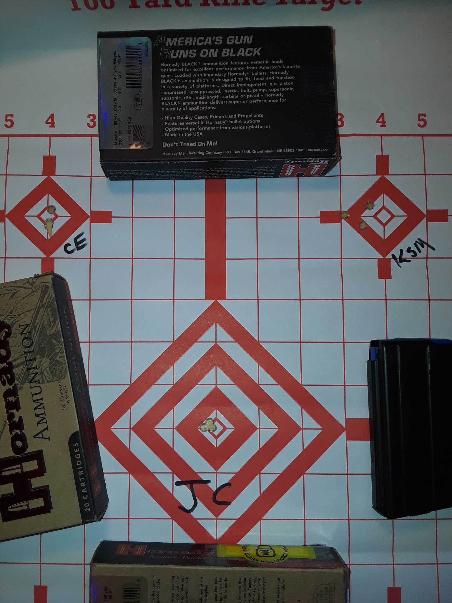

No groups shot yet as barrel break in work. These are shots 29-31 out of the tube.
223 range pick up brass made on the dillon with the dillon powder dispenser.
The center target is mine from yesturday.
These are my standard ar plinkers and untill I spent money for a ? mid tier ar barrel had no Idea the dillon could produce rounds like that.
Reactions: SmithM21
