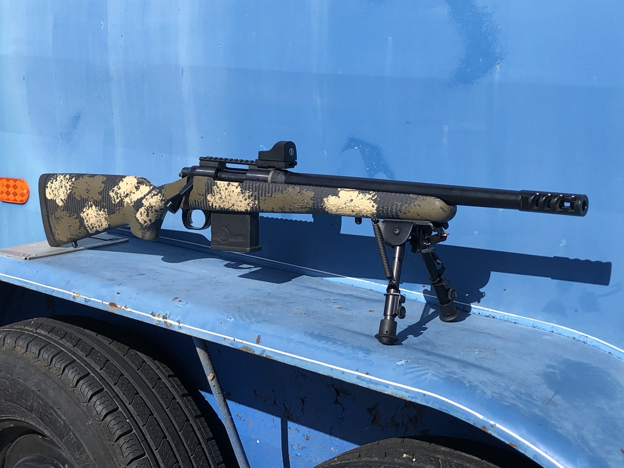

I have shot 145-180 in it. The 180s pack a punch. If I ever got serious about using it for anything, I’d use 170s for whitetail over here on the east coast. I have some chrono numbers somewhere around here. It is a 16 inch 1:14 twist barrel on a rem700 action.
I have shot 145-180 in it. The 180s pack a punch. If I ever got serious about using it for anything, I’d use 170s for whitetail over here on the east coast. I have some chrono numbers somewhere around here. It is a 16 inch 1:14 twist barrel on a rem700 action. View attachment 7865852
