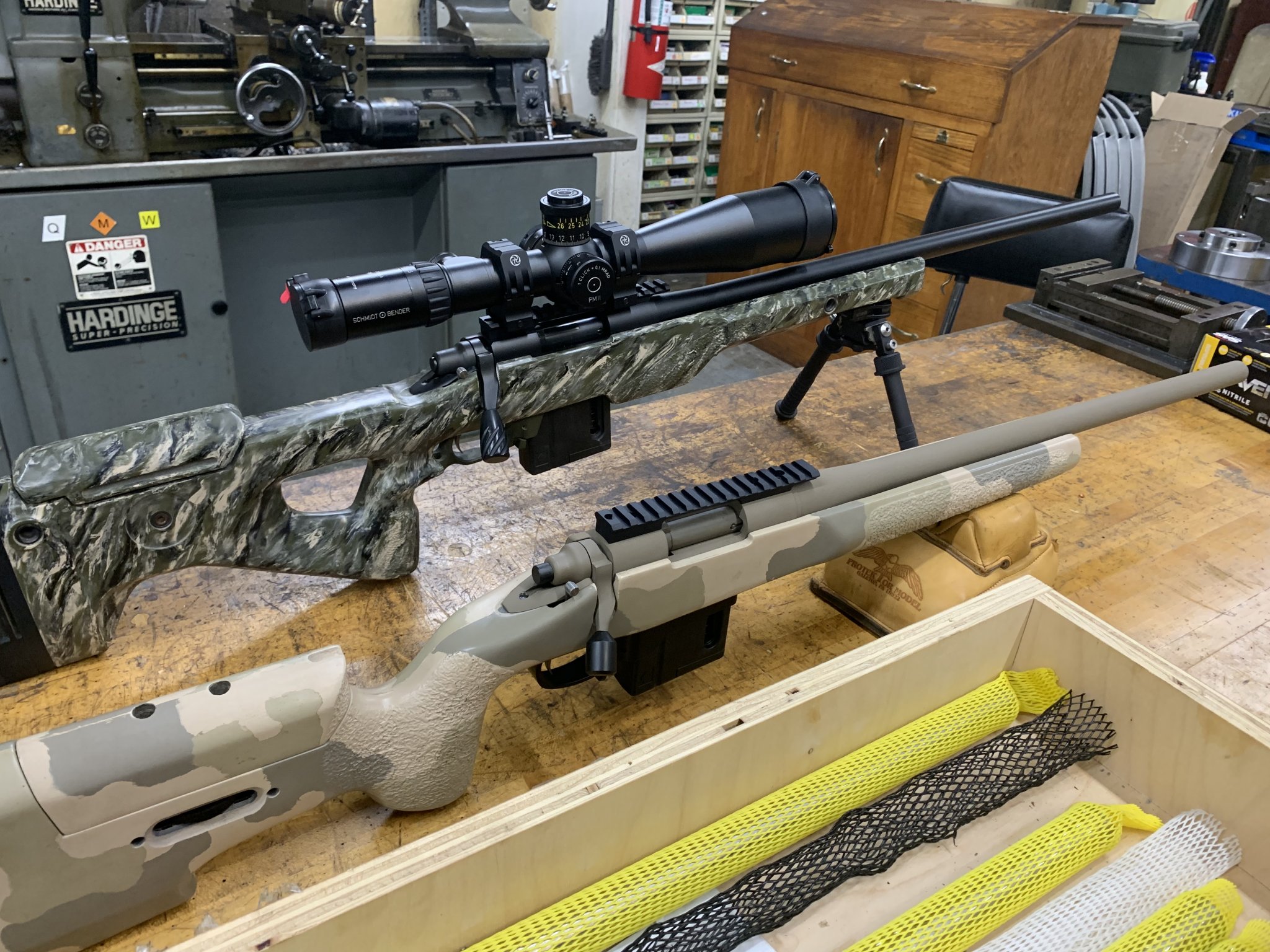

    I've done a butt load of them.
    7040826
    7040828
    7040843
    Although I do understand the collectability aspect, but given that some shoot great and some don’t as factory 40x I would have changed the barrel regardless.
    I have had the conversion done, straight bolt installed, and the kreiger barrel.
    This is probably One of my favorite and most used rifles.

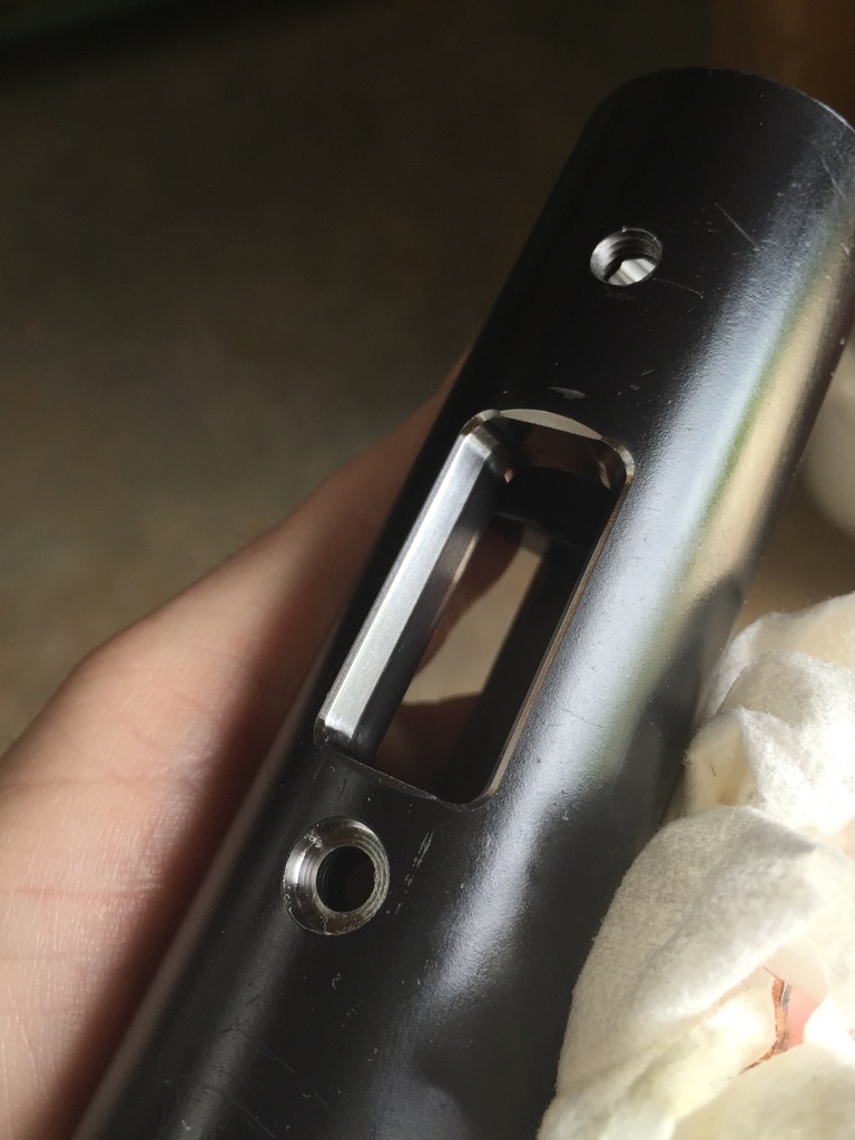

    The Vudoos are nice and I'd never discourage anyone from getting one. The guys there have been good to me. People usually come to me when they already own a 40X and want a repeater. (usually from seeing postings or from Vudoo's reference), especially when it's getting rebarreled ect.. With the Vudoo you'll get a tighter fitting action that's new and feels great. The 40X will be looser fitting but also functions great. In the end most of the time a decision is made based on what you're doing to the 40X, what you're trying to achieve, and if you already own one vs having to find a donor. Some guys like the feel of the Vudoos more and some like the 40Xs. I encourage you to get behind them if you can. I certainly don't want to come across to anyone here that I'm trying to sell without a site sponsorship, but as far as i know I'm the only one doing this particular conversion and will try to answer any questions you may have.

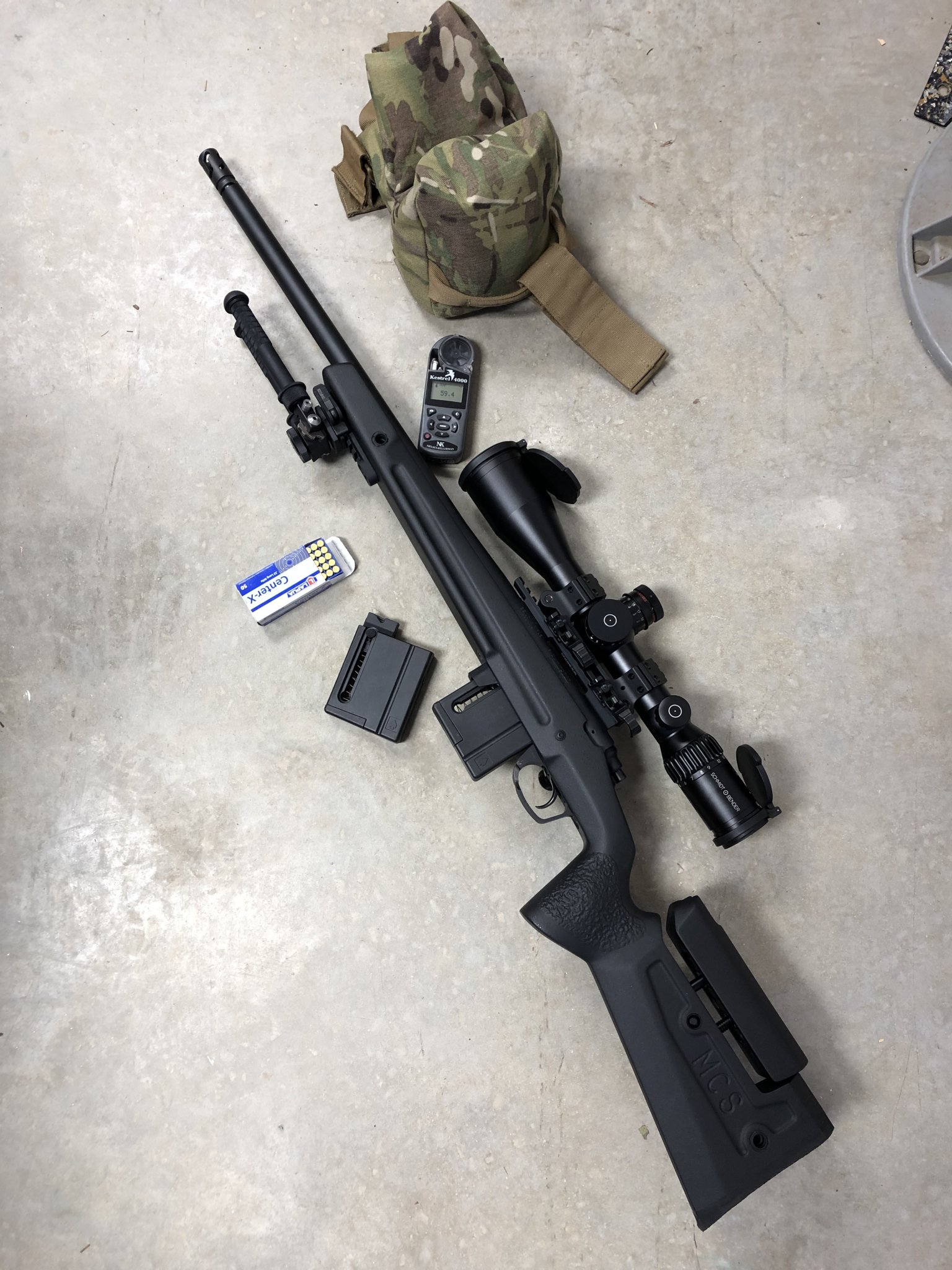

    I had Jonathan convert both my CMP 40X & XB a couple of years ago, and never regretted it for a moment. They were just taking up space in a closet, and went from closet queens to the most often fired rifles in my possession. I wanted to barrel them myself, as I'd just recently gotten into doing 22RF bbl work, but would advise you to have him re-barrel yours while he's got it. That allows him to tune the extractor & pusher to work with your new bbl, and besides that, his bbl work is as good as his conversion work - which is to say, excellent. I recently sold my converted 40X, but am still hanging onto the 40XB, even though I bought three V-22s....it's an addiction!
