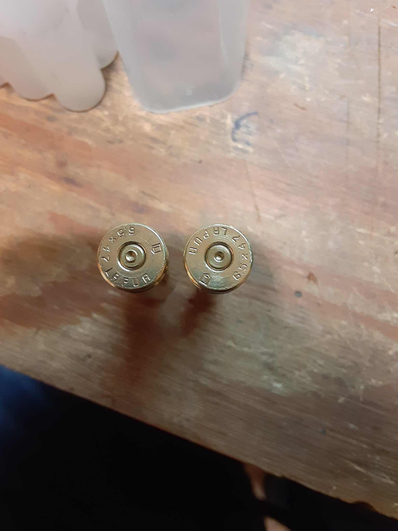

Just a little lost, nice tit meaning it pierced the primer? Just trying to understand what I should be watching for
Remington 7.5 primer in a 700 6.5x47. The one on the left was before getting my bolt bushed.
Thanks for the info. So essentially if I’m seeing primer cratering at a below max load, that’s a good indicator that I need to get the bolt bushed?
Yes, but I don't think you will have an issue. My problem was the sloppy fit of a factory Remington firing pin. I shot 3000 rounds that looked just like the left round before I sent my bolt off. The 7.5 primers are tough.
The primer flowed back into the firing pin hole. Looked like what I described it as. I had already used Gre-Tan for at least one other bolt for the same reason (Remington Model 7 with a 6.5×47L barrel) and honestly I figured I would need to bush the Surgeon bolt from the start. I seem to remember I sent in 3 other bolts to be bushed with the Surgeon. No downside besides the time and money.
