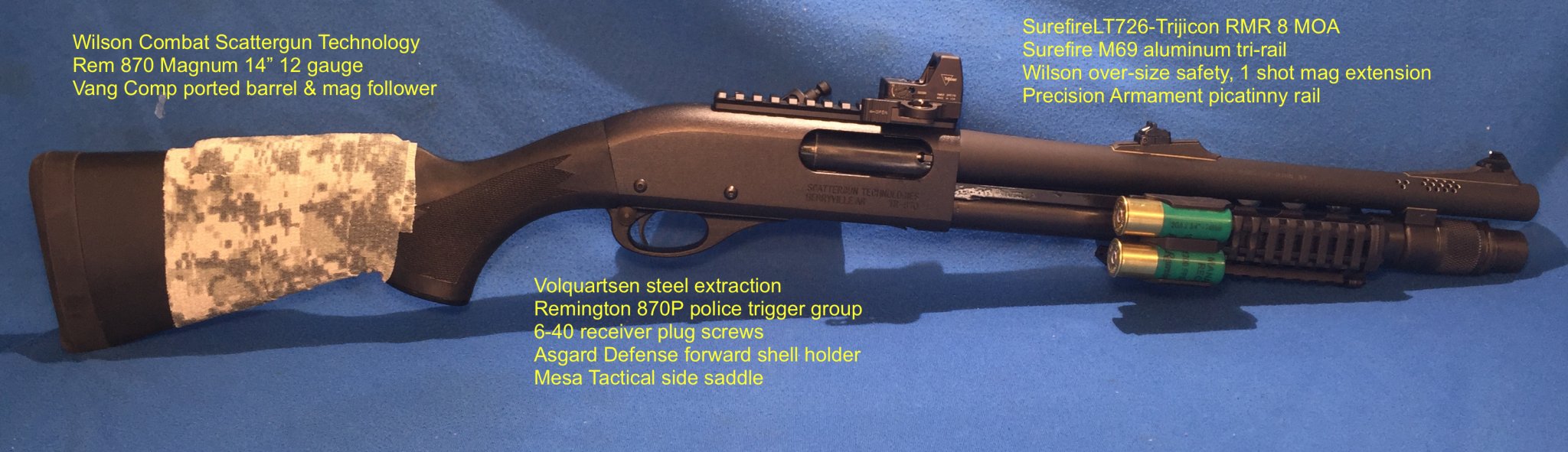

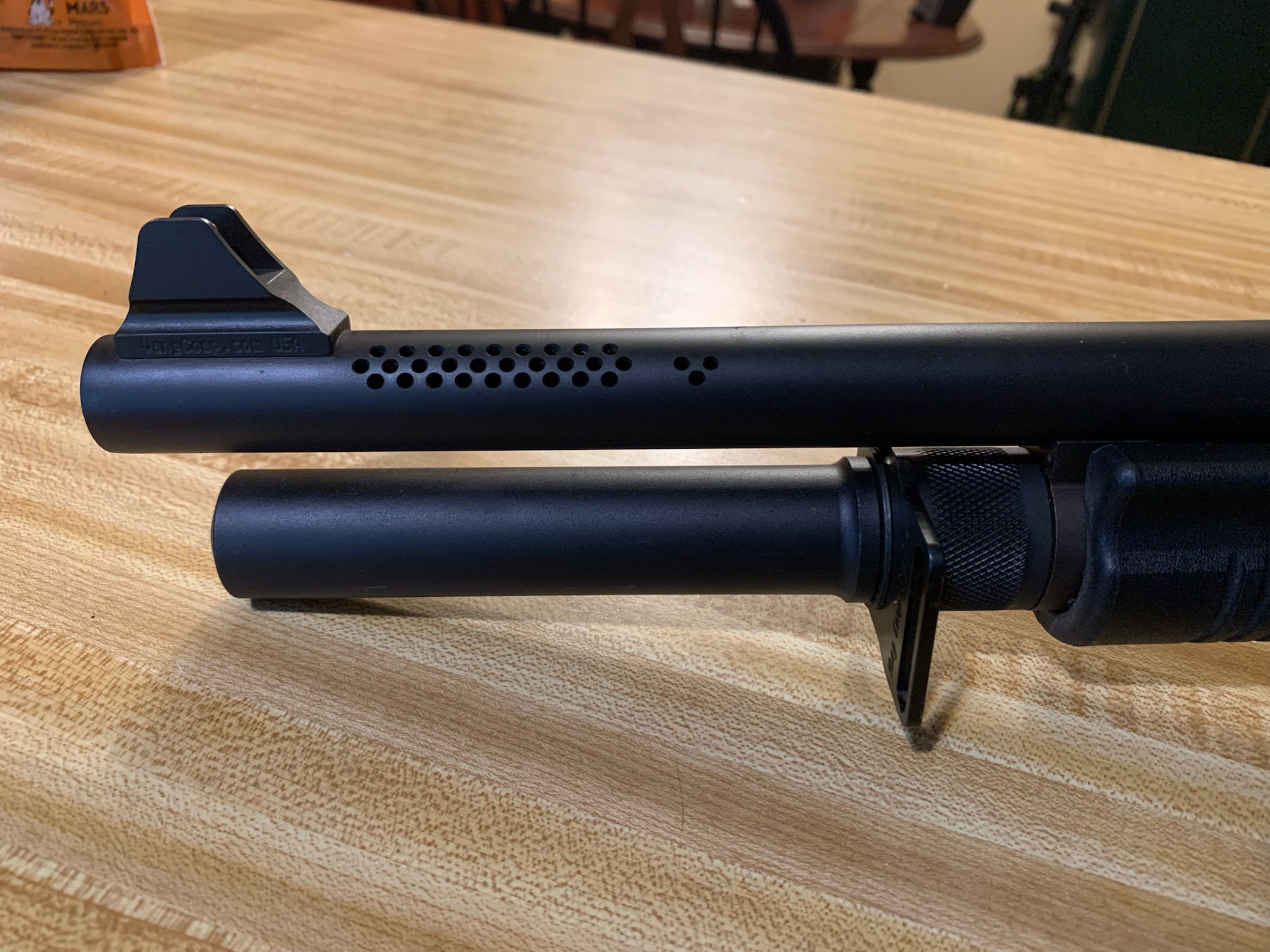

    I purchased a Wilson Combat Scatterguns Technology Rem 870 with 18" barrel with mag extension tube & Surefire forend.
    All that weight out front I find a huge disadvantage.
    Unless you are Arnold Schwartzenager build, the muzzle swung target-to-target about as fast a PanaMax super tanker.
    Put the WC on a 14" diet and it's been a bitch ever since.

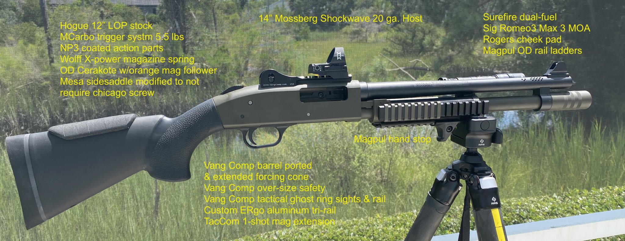

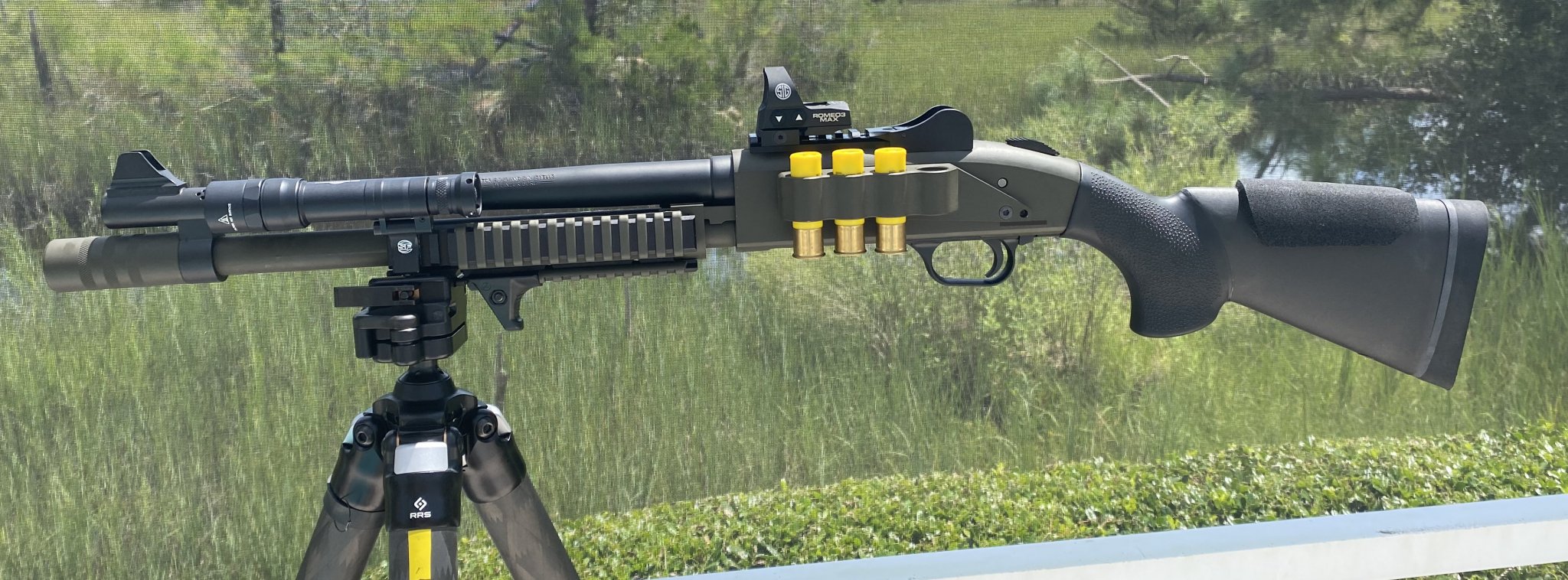

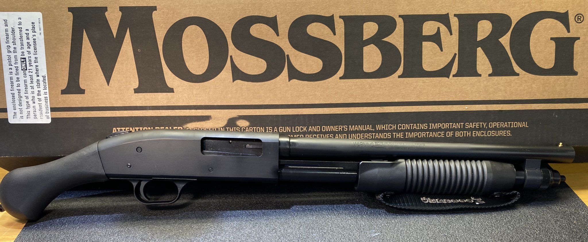

    Just finished this SBS Mossberg 590 Shockwave host 20 ga. which is a better choice, for my way of thinking, than a 12 ga. for about the house although it was done for fun not specifically for that role.
