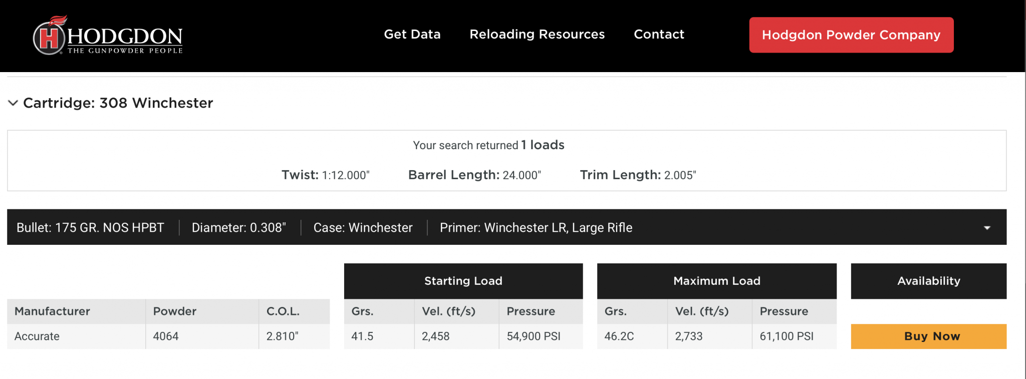

I've found that LC cases are a little thicker than others. I'd probably start at 41.5 and work up to 43.0 of AA 4064.
Reactions: simonp and SPRword
Reactions: simonp
